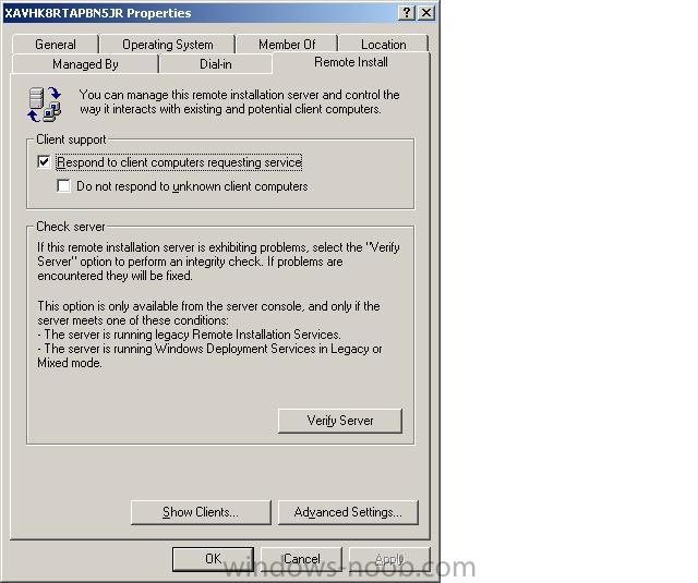

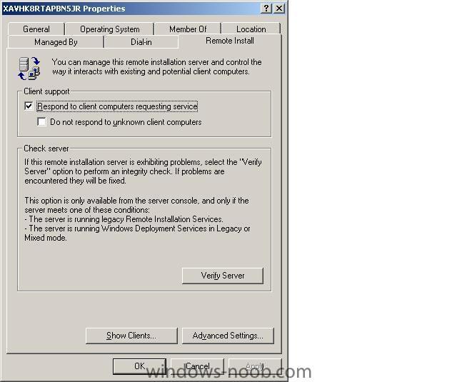

D:\Program Files\Windows Resource Kits\Tools>wdsutil /verbose /progress /initialize-server /reminst:"e:\RemoteInstall"
the /verbose command is very useful for seeing errors (such as access denied). I did receive access denied errors when running the Windows Deployment Services GUI wizard, and after much searching It turned out to be possibly related to
1. I had renamed my RemoteInstall folder to Remoteinstall2k3 (easy to rename back, but then you must re-share it to REMINST and then re-scan the domain controller in Active Directory users and computers, select the domain, choose properties, choose Remote install, choose verify, it will find errors and correct them.
2. verify your permissions on the REMINST share, if they are read-only for EVERYONE then WDS will fail with 'access denied'.
