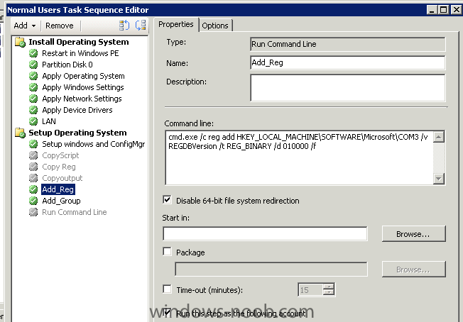

The Culprit was VMvaretools which was changed registry HKEY_LOCAL_MACHINE\SOFTWARE\Microsoft\COM3 value ;Hence my .vbs script was unable to run.
See http://dynamicdatace...y/provisioning/

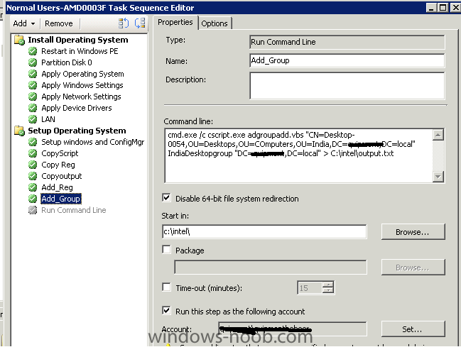

To troubleshoot the issue i followed below steps.

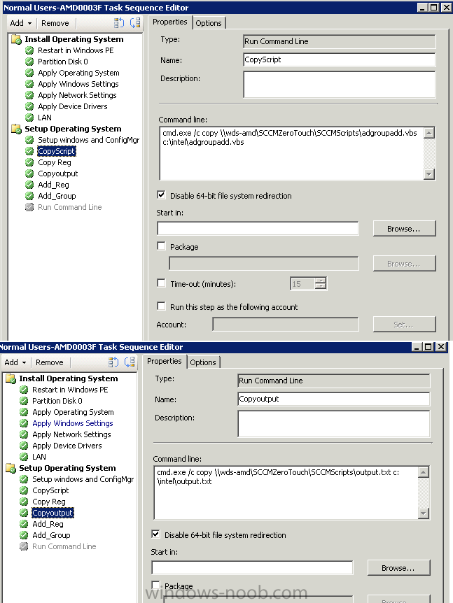

1. Copying script to local system folder
2. Running the script from local system and redirects its output to .txt file so that the exact error can be viewed,
3. The error in .txt was it "could not find the script engine."
4. Change the registry setting is command line TS.
reg add HKEY_LOCAL_MACHINE\SOFTWARE\Microsoft\COM3 /v REGDBVersion /t REG_BINARY /d 010000 /f
5. SUCCESS
