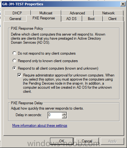

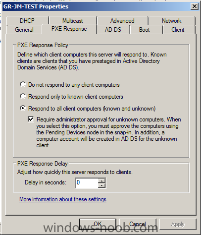

I currently have WDS 2010 configured on a 2008 R2 server. I have also go MDT installed on the same server, for which i have used to create my Lite touch WindowsPE boot.wim file.
For testing purposes i have pxe booted a Virtual Machine with windows 7 from my WDS server which worked perfectly. I then loaded the Lite touch WindowsPE boot.wim file onto a bootable usb which aslo perfectly installed Windows 7 from my WDS server.
Now the issue i have comes when i try and pxe boot directly from the on-board NIC on a HP ProBook 6460b. Pxe just sits there churning away and not picking up a dhcp address.
I have checked that pxe is enabled in the bios, i have configured the dhcp option 67 in my DHCP scope, i have also configured the following settings (See attachment)
