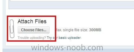

Since your link requires a DropBox login, it would be best just to post your screen shots here. When you reply, click the "More Reply Options" located near the bottom right. It should take you to another screen.
From there you can attach the image files;
