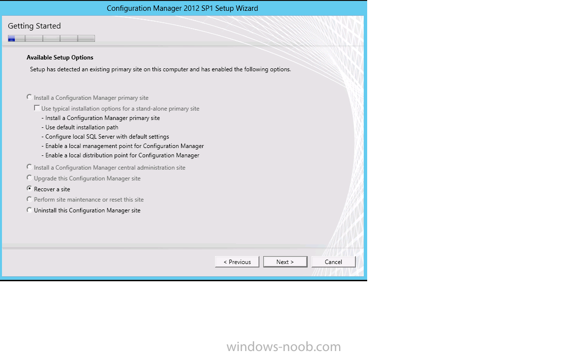

Could you please tell me, why I cannot install SCCM 2012 SP1 the both follow options?
"Install a Configuration Manager central administration site" and after that I could install
"Install a Configuration Manager primary site"
I know I could install these above option by SCCM 2012. But SCCM 2012 SP1 you can install on of these option.
Is that correct?
Best regards
you should be able to install both provided that you havnt installed one (a CAS) before, can you show me what you are seeing (screenshot)
My machine is new and I do not have installed any SCCM 2012 before.
I install first
"Install a Configuration Manager central administration site" and after that I did want to install the second option "Install a Configuration Manager primary site"
but it is gray out and I can choose only recover the side or uninstall the side. Is the problem because I have only one sccm server and I should to install an standalone primary server?
if you installed a CAS on this server and if you want to install a primary site then you must do that on ANOTHER server by running setup on that other server
if you have only one server then you should probably not be installing a CAS but install a standalone primary instead, are you setting up a lab or production ?
