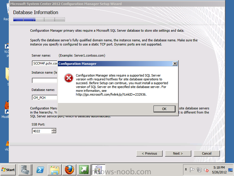

Naveed_786 Posted May 26, 2012 Report post Posted May 26, 2012 Dear All, I am trying to install SSCM 2012 but i am facing only one problem when it asks for site code i give a site code and site name when i click on next it gives the following error "Configuration Manager require a supported Sql server version with required hotfix for site database operations to succeed .............. for more information, see http://go.microsoft....?LinkID=232936" so as per instructions on given link i have downloaded upgrade for SQL Server but it when i try to update it gives following error "There are no SQL Server instances or shared features that can be updated on this computer" The version of SQL Server is Product Version: 10.50.1600.1 Service Pack: RTM Edition: Enterprise Edition (64-bit) Instance: NULL Server Name: Server1 Windows Version Windows Server 2008 R2 Standard Please tell me what should i do to resolve this issue. Thanks in advance. Quote Share this post Link to post Share on other sites More sharing options...
Peter van der Woude Posted May 26, 2012 Report post Posted May 26, 2012 You need at least one of the following SQL version: SQL Server 2008 SP2 with CU9, or SQL Server 2008 SP3 with CU4, or SQL Server 2008 r2 SP1 with CU6 1 Quote Share this post Link to post Share on other sites More sharing options...
Naveed_786 Posted May 27, 2012 Report post Posted May 27, 2012 First of all Thanks for your reply @Peter van der Woude Let me try if i have any problem then i will be back. Quote Share this post Link to post Share on other sites More sharing options...
anyweb Posted May 27, 2012 Report post Posted May 27, 2012 you are using SQL Server 2008 R2 RTM, ie you are missing the service pack and needed Cumulative Updates. See here for a list of supported versions of SQL Server. Step 10 of using System Center 2012 Configuration Manager - Part 1. Installation - CAS here shows you what to download and install. 1 Quote Share this post Link to post Share on other sites More sharing options...

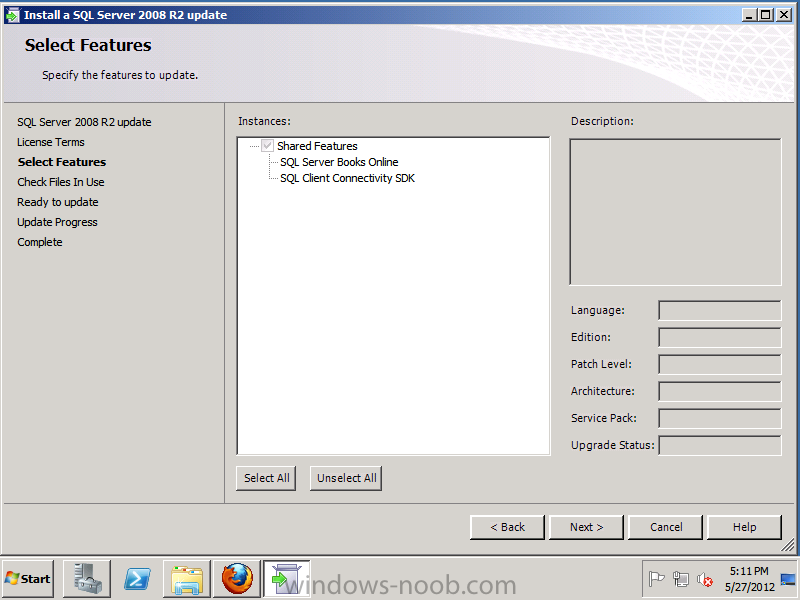

Naveed_786 Posted May 27, 2012 Report post Posted May 27, 2012 On 5/27/2012 at 7:59 AM, anyweb said: you are using SQL Server 2008 R2 RTM, ie you are missing the service pack and needed Cumulative Updates. See here for a list of supported versions of SQL Server. Step 10 of using System Center 2012 Configuration Manager - Part 1. Installation - CAS here shows you what to download and install. First of all thanks for your precious time @anyweb i have upgraded the sql server as SP1 from RTM. Just only now i am stuck on cumulative update 6 the problem is this i have downloaded cumulative update 6 but when i unpack it and try to install it just show only Online Sql server books feature nothing else the name of the hotfix is "SQLServer2008R2-KB2679367-x86" please view the attached image file please help me to get out from this problem Thanks in advance Quote Share this post Link to post Share on other sites More sharing options...
Naveed_786 Posted May 28, 2012 Report post Posted May 28, 2012 Same Issue after installing and rebooting. SCCM 2012 show same error Could it be problem "SQLServer2008R2-KB2679367-x86" as it is x86 version? Quote Share this post Link to post Share on other sites More sharing options...
anyweb Posted May 28, 2012 Report post Posted May 28, 2012 yes, go to the download page again, here it is. and download this version, click on Show hotfixes for all platforms and languages (3) to see every download... SQL Server 2008 R2 All (Global) x64 SQLServer2008R2_SP1_CU6_2679367_10_50_2811_x64 1 Quote Share this post Link to post Share on other sites More sharing options...

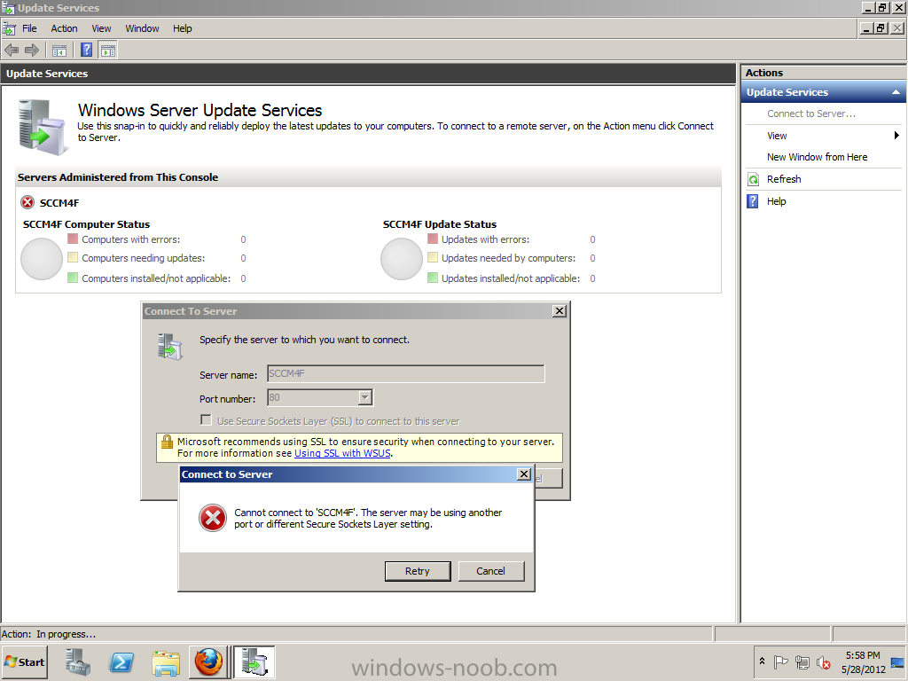

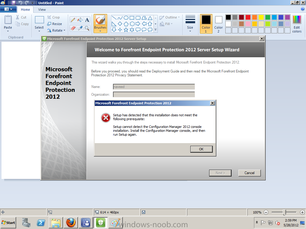

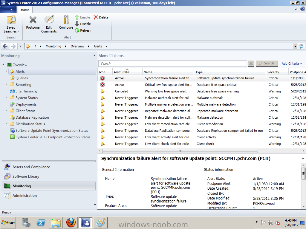

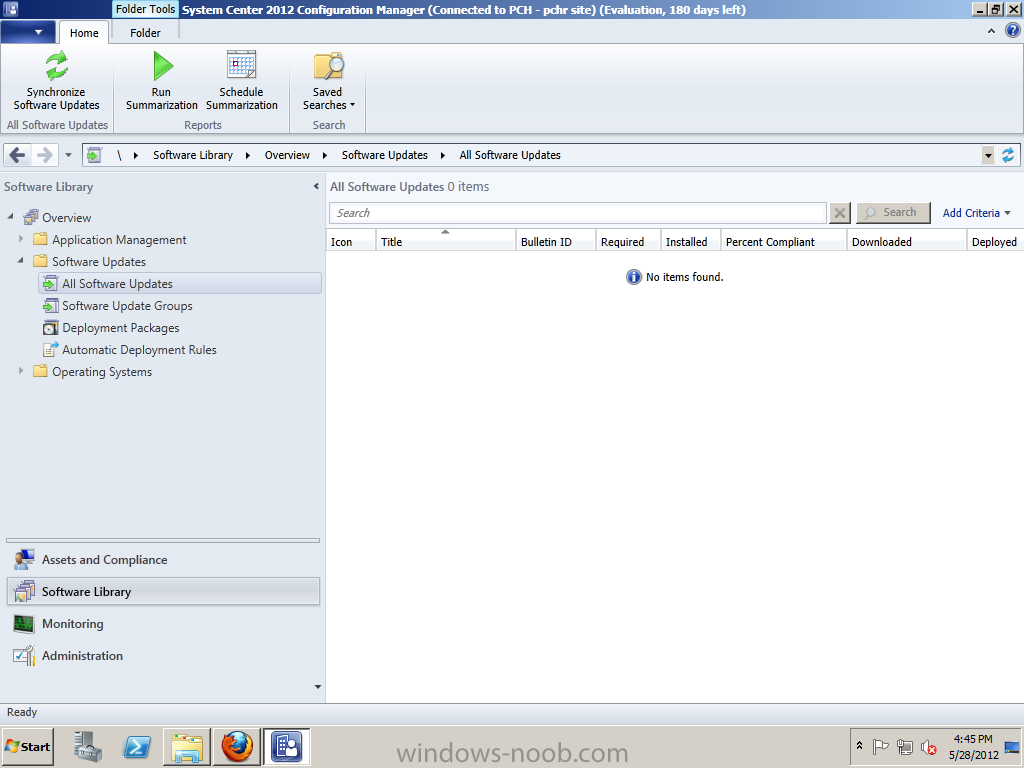

Naveed_786 Posted May 28, 2012 Report post Posted May 28, 2012 Yes and thanks for your help now i have successfully installed SCCM2012 now i want to install FEP 2012 but i got this error please view the attached image file I have already followed your great tpic "using SCCM 2012 RC in a LAB - Part 5. Enable the Endpoint Protection Role and configure Endpoint Protection settings "to configure SSCM 2012. But there is nothing in all update software. Please view the attached images When i try to connect wsus it produces error please view the image file Quote Share this post Link to post Share on other sites More sharing options...
anyweb Posted May 28, 2012 Report post Posted May 28, 2012 please raise one thread per topic, your orginal question was about installing ConfigMgr, now it is installed. Raise a new topic about your Endpoint Protection problem, it keeps things clearer and easier to follow/troubleshoot... 1 Quote Share this post Link to post Share on other sites More sharing options...
