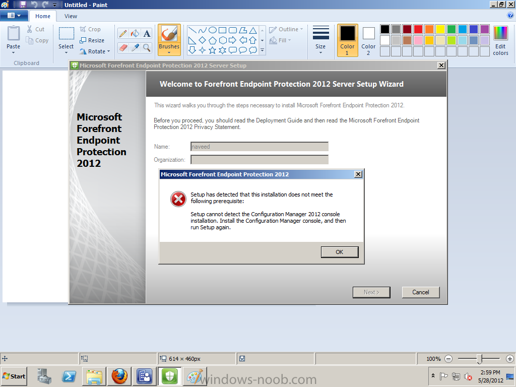

After Successful installation of SCCM 2012 now i want to install FEP 2012 but i got this error please view the attached image file
I have already followed your great tpic "using SCCM 2012 RC in a LAB - Part 5. Enable the Endpoint Protection Role and configure Endpoint Protection settings "to configure SSCM 2012.

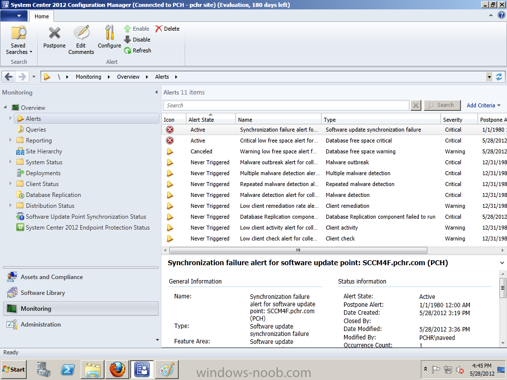

But there is nothing in all update software. Please view the attached images

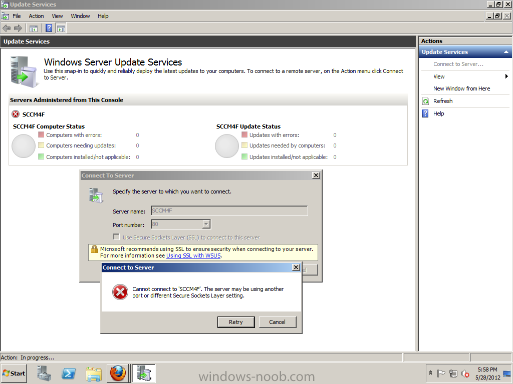

When i try to connect wsus it produces error please view the image file
if you followed part 5 then why are you running a separate SCEP 2012 install ?
when you configured the Software Update Point did you check your wsyncmgr.log as explained in part 2 as described here

1. After the installation of SSCM 2012 is there any need to install Forefront Endpoint 2010 Server Setup?
2. When i synchronize All Software update it shows Xp updates but there is no update for forefront endpoint 2010, i have select Window Xp and Forefront Endpoint Protection 2010 in the rule as mentioned in your lab 5.?? What could be the problem.

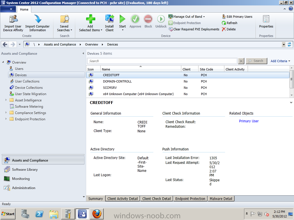

3.How to deploy Setup on clients???
did you select Definition Updates in Classsifications ?
you need the ConfigMgr client installed on the computers before you can implement Endpoint Protection, the machines above say 'client =no' so do they have the client installed, or not
if you follow the guides you'll see theres an option of deploying the client via Client Push, however that is one of many ways to deploy it.
it's all explained in the guides, to install the SCEP client you do so via custom client agent settings and custom client antimalware settings, have you configured these ? is the ConfigMgr client installed on your clients yet ?
once your systems end up in a collection targetted with the Custom Client settings (for enabling Endpoint Protection) and Custom Antimalware policies, they'll get SCEP installed and configured.
