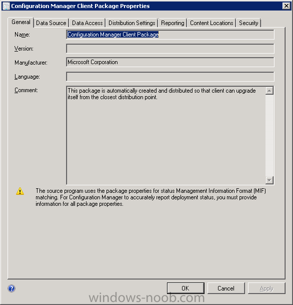

When installing the client via a TS, it works fine. The TS uses the "Configuration Manager Client Upgrade" package (on the Primary Server) which has ccmsetup.exe as a program.
When I use Client Push, I'm pretty sure it uses the "Configuration Manager Client Package" package (on the CAS server).
This has no program and no settings can be changed - it's all greyed out.
Please see attached images.
