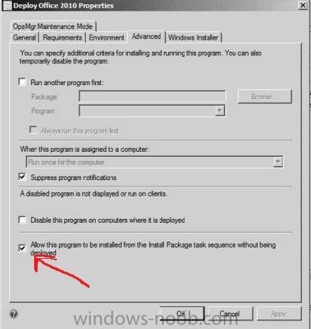

0 Rocket Man Posted June 1, 2012 Report post Posted June 1, 2012 Have you specified that this program is allowed to be deployed as part of a task sequence? This is probably why it gives this error when it tries to install as part of OSD install. Quote Share this post Link to post Share on other sites More sharing options...
