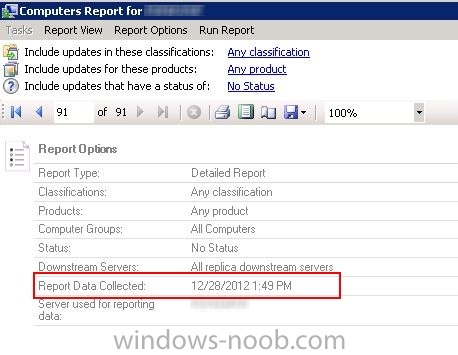

Well perhaps that is normal. I double clicked on a workstation that had "Not Yet Reported" and then navigated to page 91 of 91 and it showed that the "Report Data Collected:" was today. When I went to that computer and checked the logs everything looked like it ran successfully.

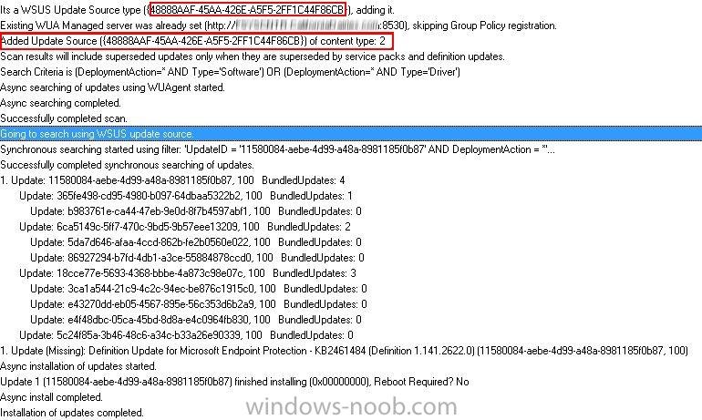

When I opened the WUAHandler.log file for that client is is shows that the GPO setting for the WSUS was conflicting with the Client specified agent. (See Attached Capture2)
I removed the GPO setting and rebooted the computer and no more error (See attached Capture1).
Now my questions is, how can I verify that "Update Source {48888AAF-45AA-....:8530}" is the local Distribution Point and not the actual SCCM server?
