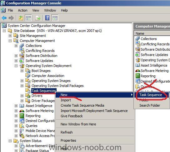

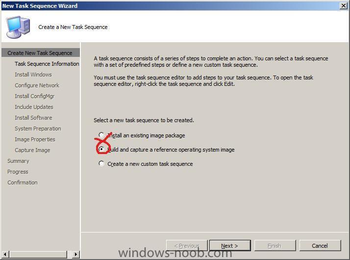

right click on Task Sequences and choose New Task Sequence

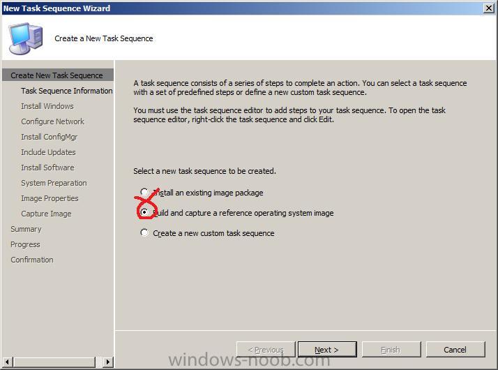

choose the second option (Build and Capture a reference operating system image)

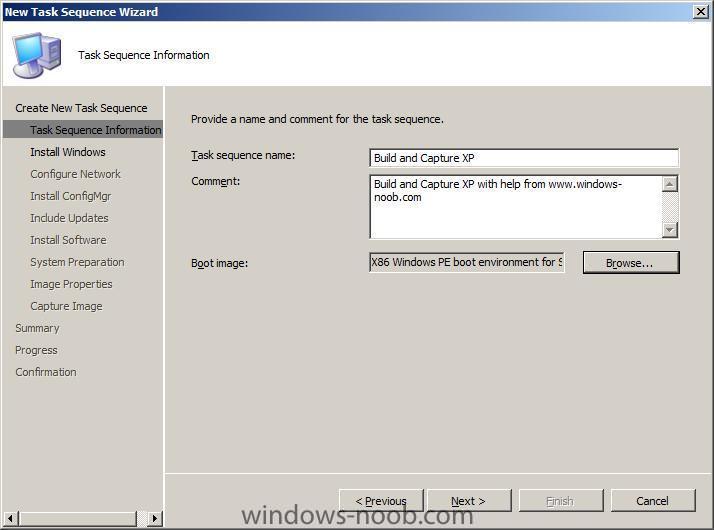

fill in your Task Sequence Information

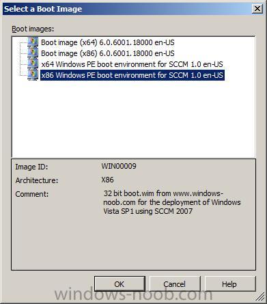

click browse and select our X86 boot image
Note: if you don't see the x86 windows PE boot enviroment for SCCM 1.0 EN-US image listed then follow these steps first.

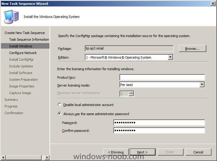

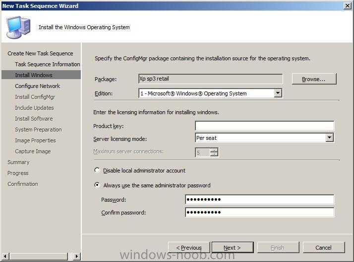

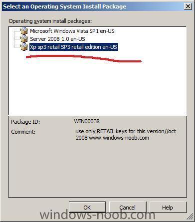

On the Install Windows screen click on Browse and select the XP SP3 operating system install package we created in Part 1.
Input your product key and make sure to enable the local Administrator account,

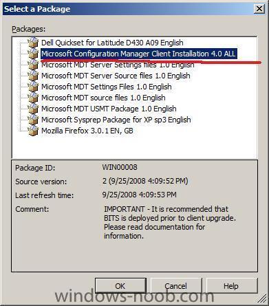

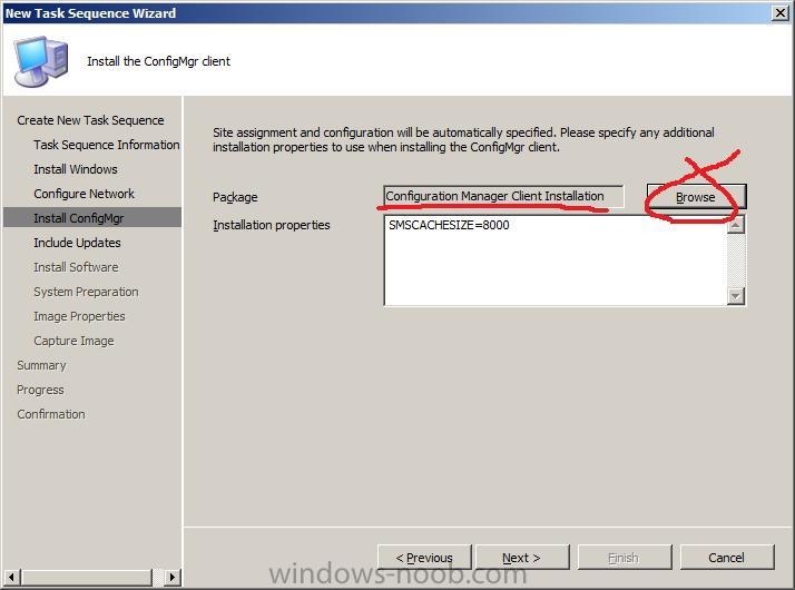

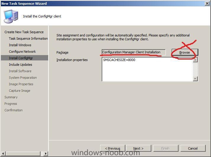

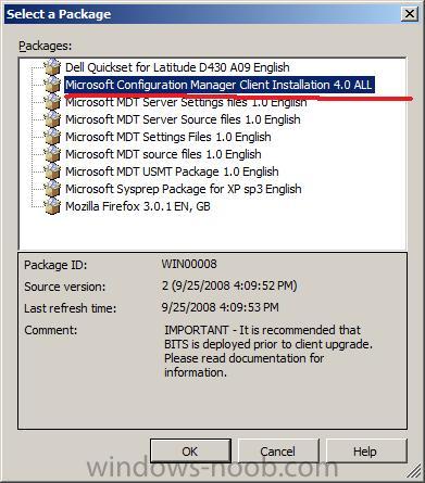

on the Install ConfigMgr screen, browse to the Predefined ConfigMgr Client Package we created earlier

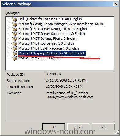

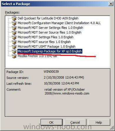

for the System Preparation screen click on browse and choose the sysprep package we created earlier

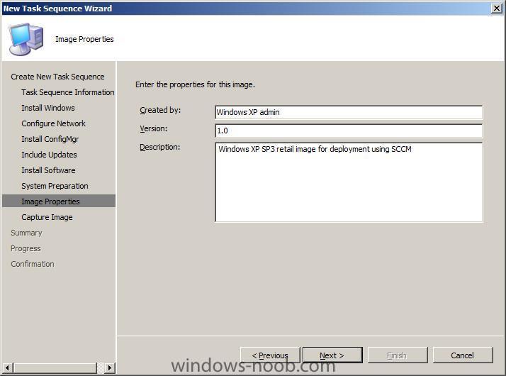

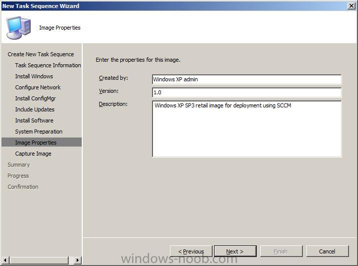

fill in the image properties

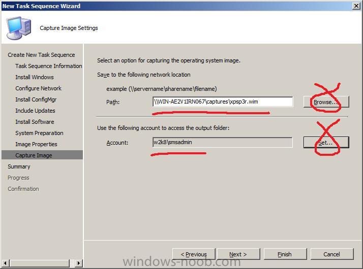

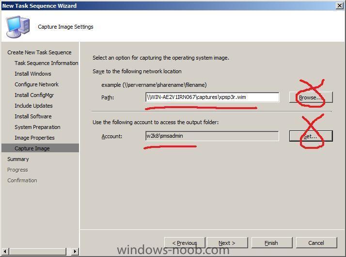

On the Capture image screen, browse to a share on your network for copying the image to, and give the file a name
eg:
\\WIN-AE2V1IRN067\captures\xpsp3r.wim
fill in your user account for capturing the image with, I use SMSadmin

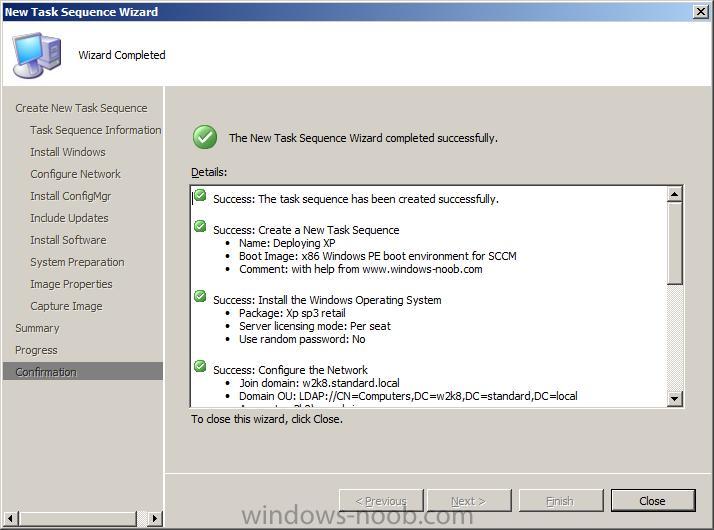

click next, next and close at the confirmation screen
