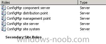

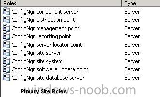

We have a primary site (Windows 2008 server sp2 + SCCM 2007 sp2 r3) in our Data center (remote location) and a seconday site in our corporate office (My office). DNS and DHCP server are installed on a separate DC. Attached is the screenshot of the roles installed on Pri and Sec site. (WDS is not installed on either of the locations)

you need to install the PSP role on the secondary site if you want to image computers at that site using PXE boot. The PSP role requires WDS to be installed (but not configured)
