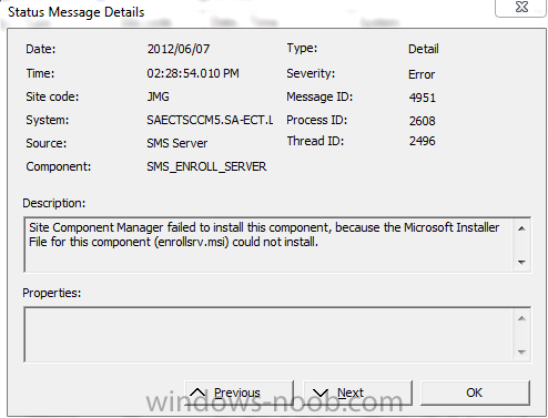

While browsing through my Status messages I saw this little bombshell (attached), on our Second site server, stating that Enrollsrv.msi could not install.
I checked all over Google, but simply could not find anything related to this.
I then proceeded to check the log-files, and this is what I saw:post-16356-0-50845700-1339074146_thumb.png
It could not find a IIS site, called JMZAenroll(enrollment point), and proceeded to can the installation.

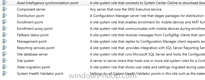

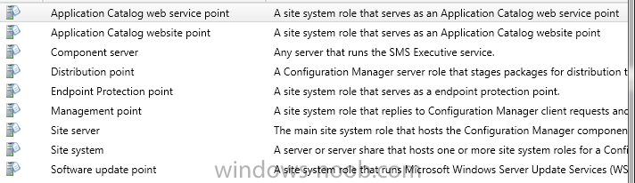

I added a Enrollment point, to my second site server, but I did not Add a Out of band management point, as I need an Amt certificate for it, and We're still working on that, is this role neccesary?
I heard somewhere that these roles might rely on eachother.
First site server roles:post-16356-0-16328000-1339079049_thumb.png
Second site server roles:post-16356-0-31957300-1339079083_thumb.png
