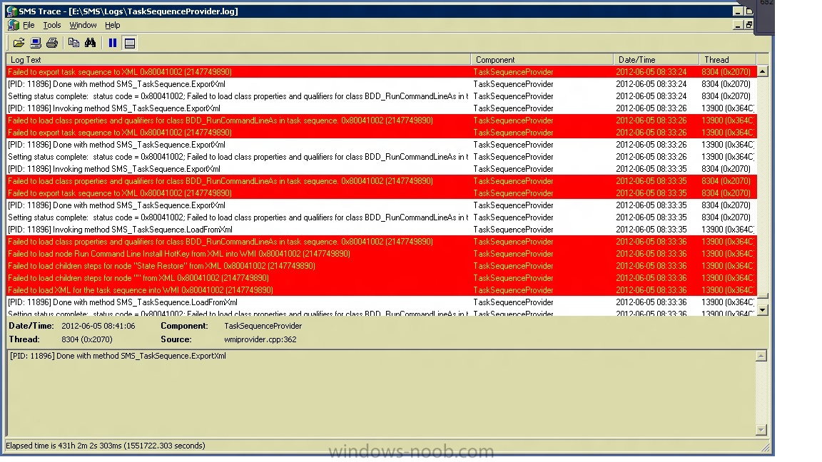

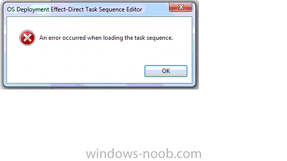

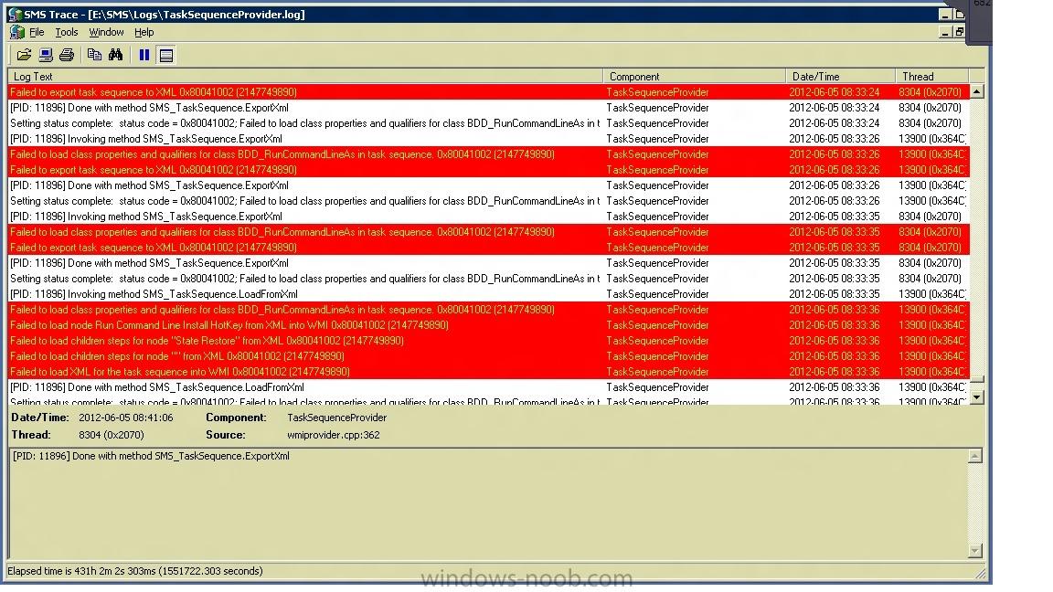

We have a problem at one of our customers with opening several task sequences. When we try to open it for editing we get the error message and the only error in the logs are the ones you see in the images below.
So what I can see its some problem with the WMI class called BDD_RunncommandlineAs and I can’t find that class in wmi either on the Central or the Primary site.
