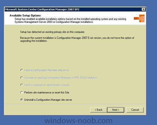

PrincessGalz Posted June 11, 2012 Report post Posted June 11, 2012 Hi , I have sccm2007 SP2 R3.Now ConfigMgr 2007 period expires i can open the console but cant do any action. How i can get back ConfigMgr 2007 to use. First,I download System Center Configuration Manager 2007 has service packed 2 (ConfigMgr07SP2Upgrade_RTM_ENU) .On the ConfigMgr setup wizard dont show "Upgrade existing SMS 2003 or Configuration Manager installation" but show only"Uninstall"and "Perform site maintenance or reset this site ". If I select Perform site maintenance or reset this site,what happend about customize report ,customize collection and package into software distribution. What i can do? I dont want to uninstall. Pls, help me. PrincessG. Harrypotterlupin@gmail.com Quote Share this post Link to post Share on other sites More sharing options...
Peter van der Woude Posted June 11, 2012 Report post Posted June 11, 2012 You should be able to perform an in-place upgrade with the full ConfigMgr 2007 SP2 source. Keep in mind that it has to be a licensed version now. Quote Share this post Link to post Share on other sites More sharing options...
