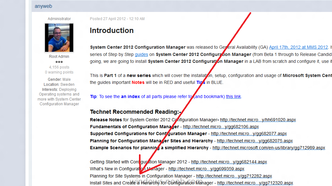

and that link (amongst others) is already included in Part 1 of my new series underneath Technet Recommended Reading, f.y.i <_<
