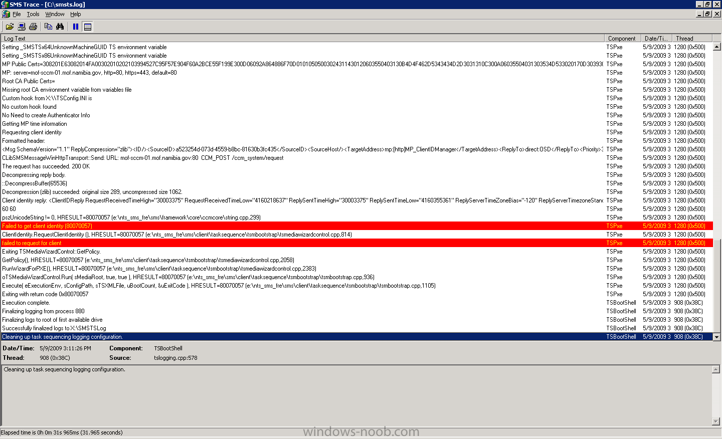

i am a bit stuck with a problem where i can pxe boot a computer(bare metal), its gets to the screen where it says its loading winpe (background image is from sccm), preparing network connections etc & then it sits there for 1-2 minutes & it reboots. the task sequence does not load.

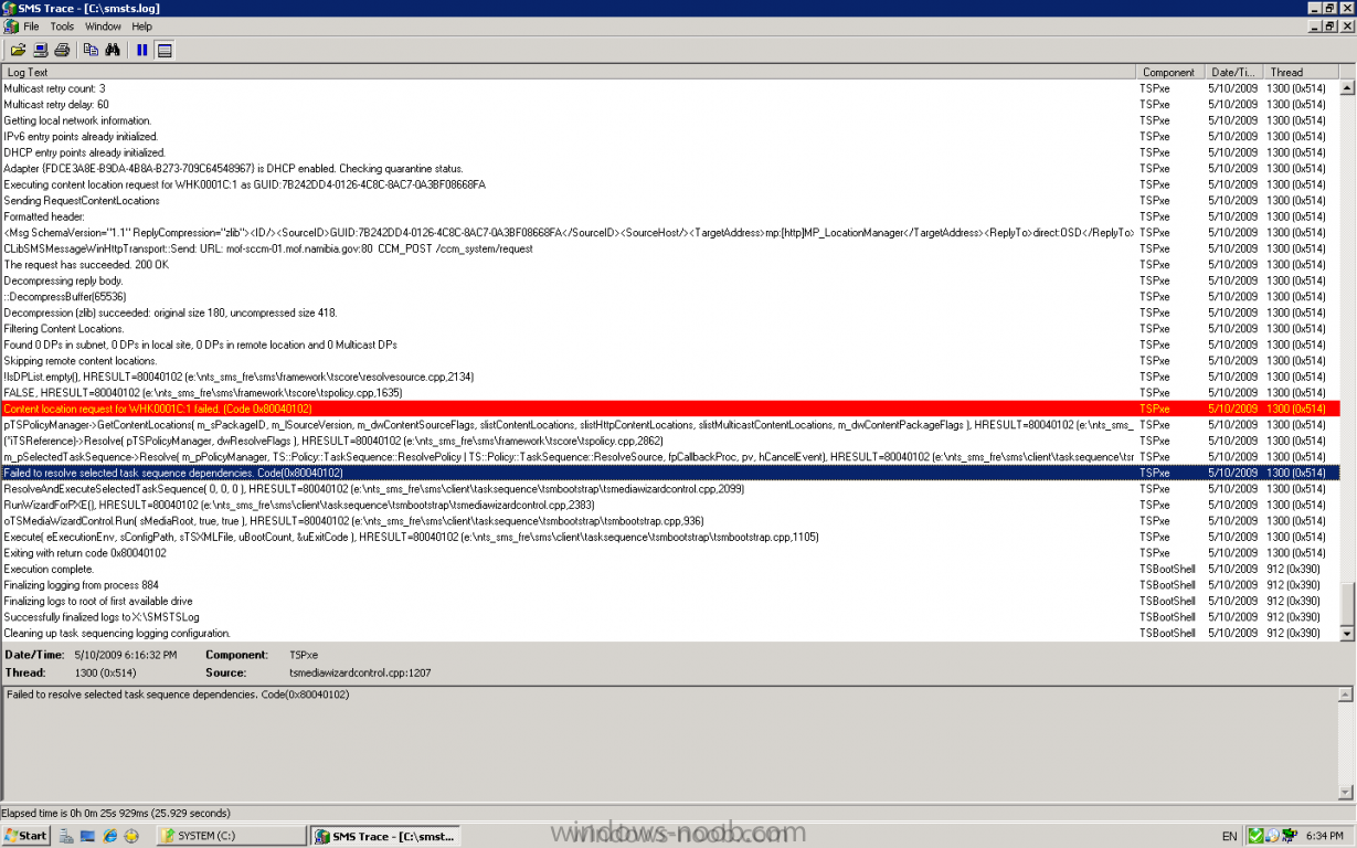

I have looked through the smstslog & its failing to connect to a package & that package is the x86 pe boot.wim.
would it be a permissions issue?

i think i have cracked it.
i did not set the network access account in the client agent setting initially. once i set that, the task sequence has started.
