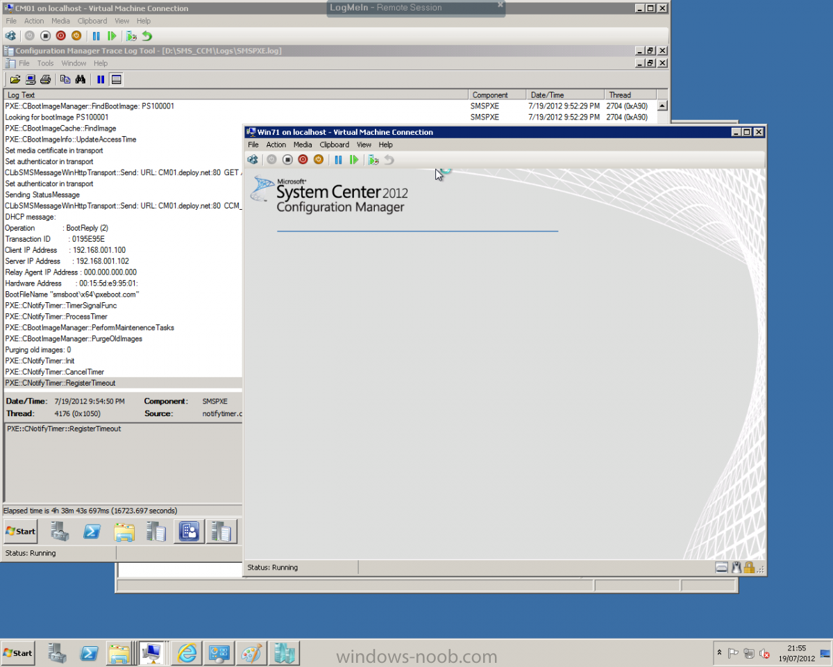

I’ve some problems with deploying clients in my lab environment. The problem is:
Client boots up and receives boot image
Client loads Windows PE
Client restarts as soon as Windows PE loads and the task sequence shows and says starting windows and the vm restarts.
I tried to ping my SCCM server called “CM01”. Worked . But then I tried the whole FQDN “cm01.deploy.net” and the name was not resolved. My DC and SCCM servers are seperate. I have changed “006 DNS Servers” option to the IP of my DHCP server
Can anyone tell me why this is happening?
Below is screen shots of the log on the VM so far I have followed every step of this guide up to part 7.
post-15786-0-44426100-1342738495_thumb.pngpost-15786-0-27076400-1342738499_thumb.pngpost-15786-0-94272000-1342738499_thumb.png
2 answers to this question

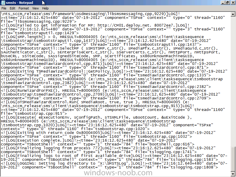

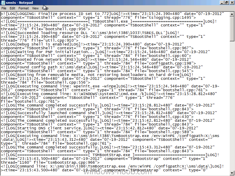

On the client that fails during Win PE boot, try pressing F8 to open a command line. Then from the command line, make sure that you can access your network, also, try to copy the client log file to review it.
