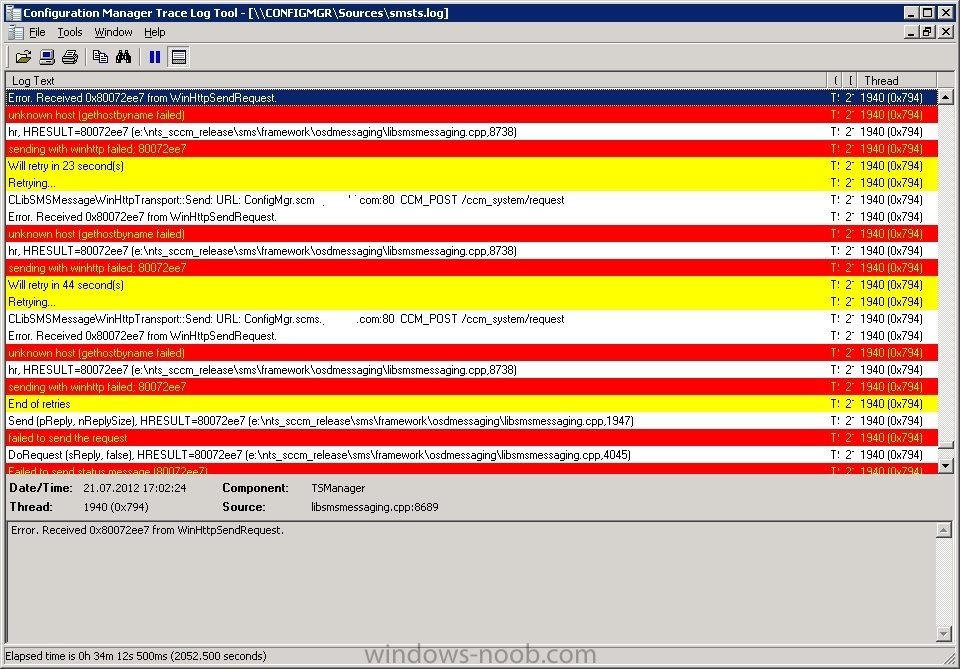

Toluol Posted July 21, 2012 Report post Posted July 21, 2012 Hi, i am following the SCCM 2012 guide here. The Win7x64 TS works fine. So i want to try the Build and Capture of XP too. The object is a Hyper-V guest, Sysprep is included in the TS. Unfortunately the TS don't work. Any hints for troubleshooting? I have included a Screenshot of the SMSTS.log Quote Share this post Link to post Share on other sites More sharing options...

0 anyweb Posted July 23, 2012 Report post Posted July 23, 2012 Okay, i solved it by myself. In my case the problem was caused by insufficient privileges on the destination share. are you saying that you had permission issues on a destination share causing the error above ? if so what share (was it the capture directory ?) and what permissions did you change ? i still think based on the screenshot above that it was ip address/dns related so would like more info about your troubleshooting Quote Share this post Link to post Share on other sites More sharing options...
0 Toluol Posted July 23, 2012 Report post Posted July 23, 2012 Yes, i was (am) straight following your guide. My XP TS was a modifcated copy from the Win7 version with the same NAA. I was able to reach the UNC when the error occured. So i created another NAA and my TS worked. I also had expected a access denied error or so! BTW: Thanks a lot for your great work. Quote Share this post Link to post Share on other sites More sharing options...
