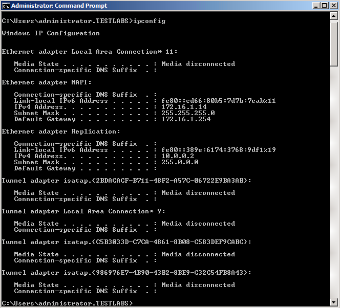

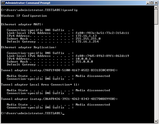

Running “ipconfig” on both mailbox servers, for checking the IP addresses. Both for the MAPI network and the Replication network.

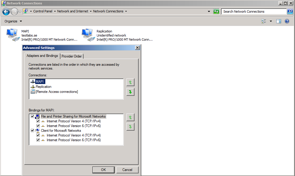

Go into Control Panel and check the network interfaces,

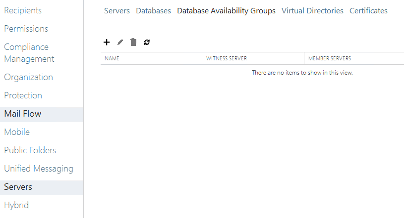

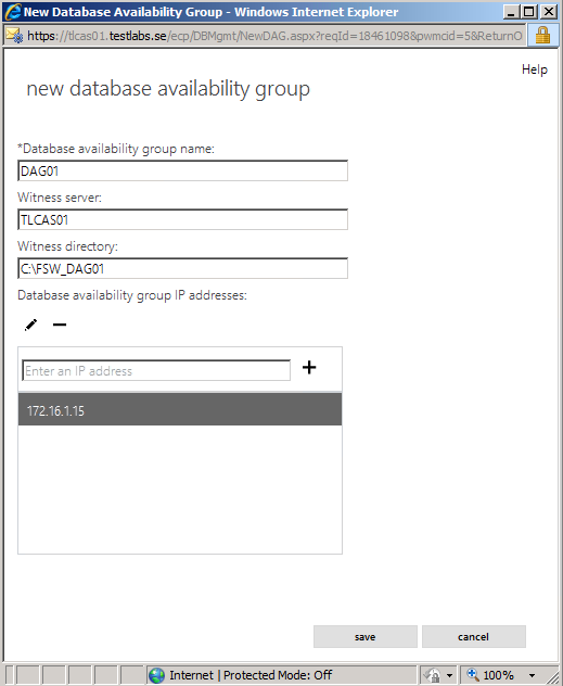

Login to the EAC, go to Servers and select Database Availability Group. Press Add button (+).
Type in DAG name, Witness Server, Witness directory and DAG IP. Press Save.

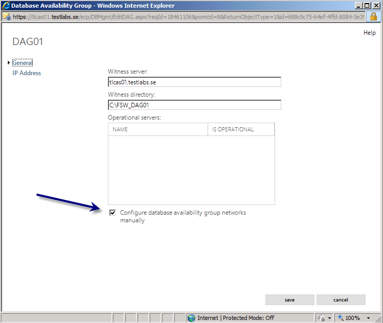

When the DAG is created, select it and Press Edit. Check the option “Configure database availability group network manually”. Press Save.

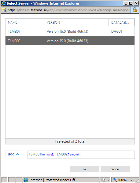

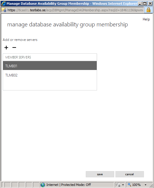

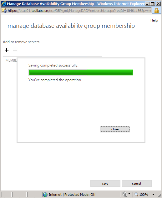

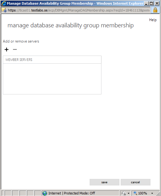

It’s now time for adding the mailbox servers into the DAG, this by pressing “Manage membership” button.
Press the Add button (+) and add the mailbox servers.
Add the mailbox servers that should reside in the DAG. Press OK.
Press Save.
The configuration now gets saved, failover clustering was installed on mailbox servers. Press Close.

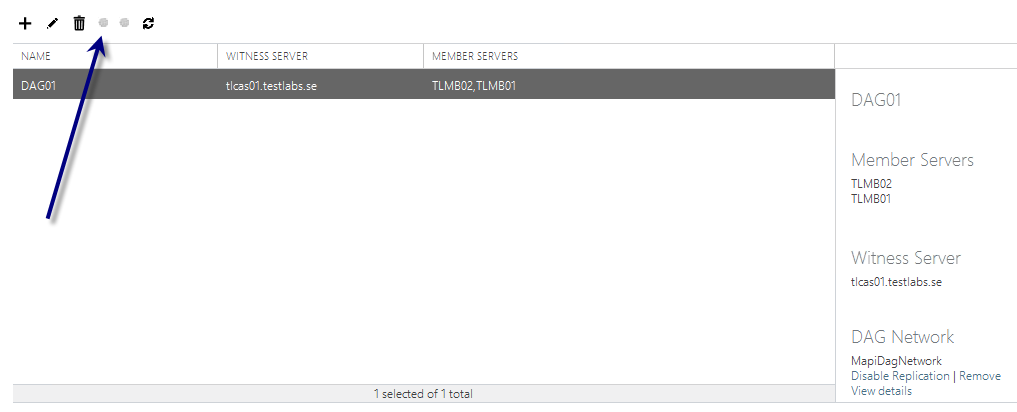

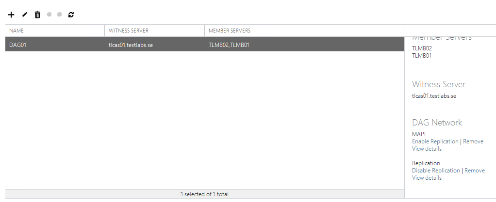

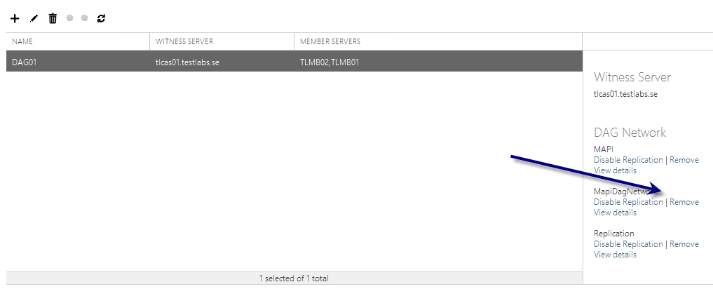

Next thing to do it the DAG Networks, as you can see in the right bottom corner, a network called “MapiDagNetwork” has been created. I want to have the control over these networks so I will create my own.

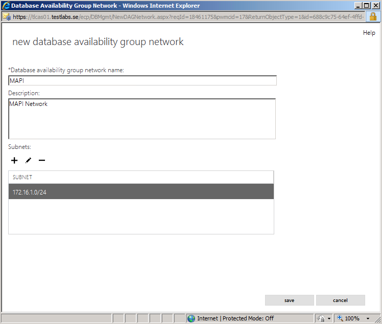

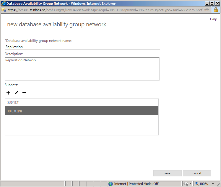

Start by pressing “New DAG Network”. I’m about to create two new networks.
I will give the first network a name like MAPI Network, and assign the Subnet to it where the clients are supposed to connect. Press Save.
My second network will be called Replication Network, since that it’s purpose and also assign it to the correct Subnet. Press Save.

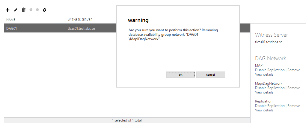

Since we now have created those two network, let’s remove the automatic created one by pressing “Remove” button.
Press OK.

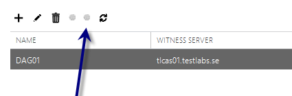

The MAPI Network is not supposed to be used as replication network, so let’s disable that function by pressing “Disable Replication” on the MAPI network. Press OK.
The DAG should now show two networks called MAPI and Replication. The MAPI Network should not be enabled for replication.
Final DAG configuration

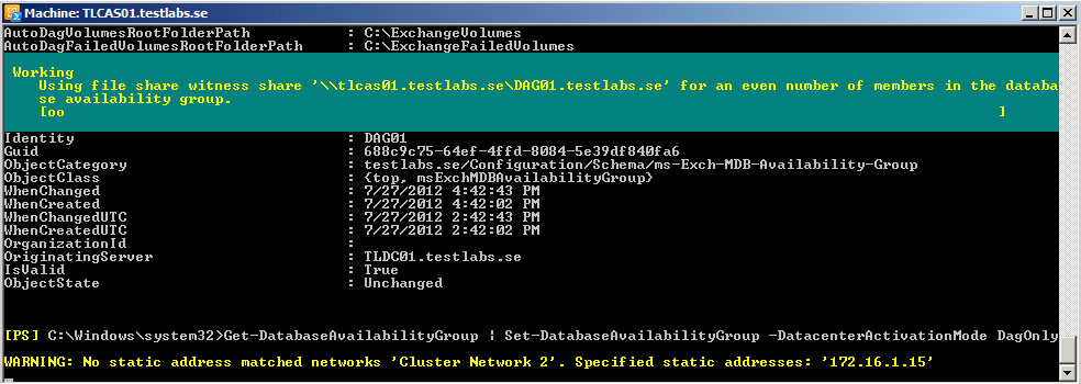

The last step (just a recommendation) is to enable the DAC mode, this for preventing split brain syndrome. Which means that you end up with having same database mounted on two (or more) different servers. More info about DAC mode can be found on the link in the end of the post.
This can’t be done through EAC (maybe that will change to RTM). So let’s start up Exchange Management Shell (EMC).
Set-DatabaseAvailabilityGroup –Identity DAG01 –DatacenterActivationMode DagOnly

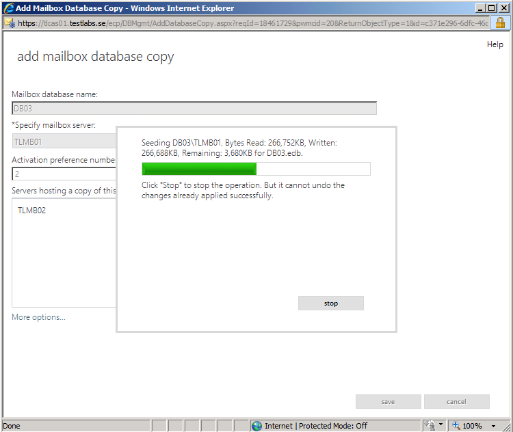

Database copies

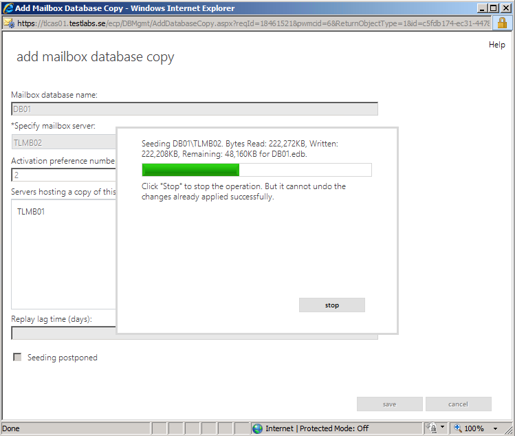

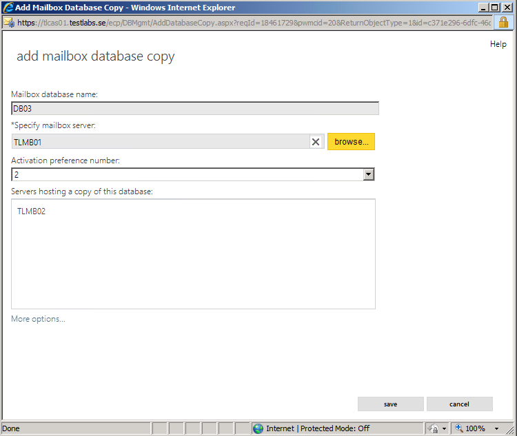

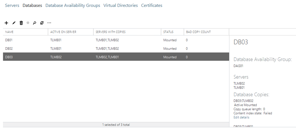

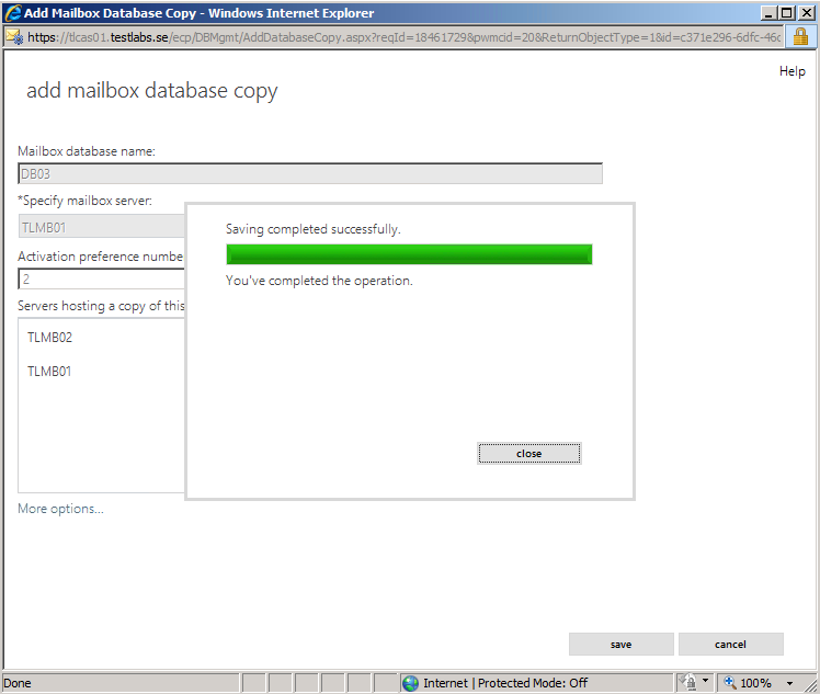

On each mailbox database we now need to add a copy to another server for having the redundancy.

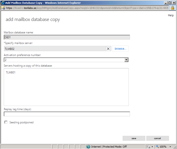

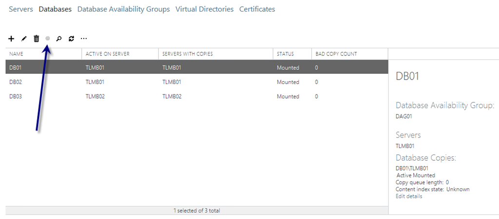

In the menu, go to Databases and select one database, then press the Add database copy button.

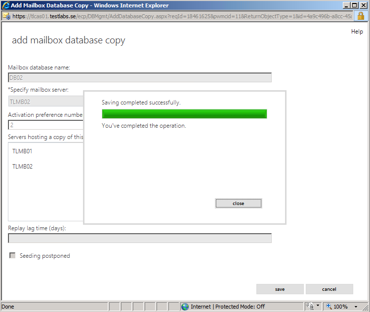

Specify mailbox server that at the moments doesn’t hold a copy of the database and add it by pressing the browse button. Press Save.
Note: In this menu you also have the option to configure lag time (if using lagging node).
The database now get’s copied (Seeding).
Then do the same procedure on all of your databases.
Press Close, when the operation is done.

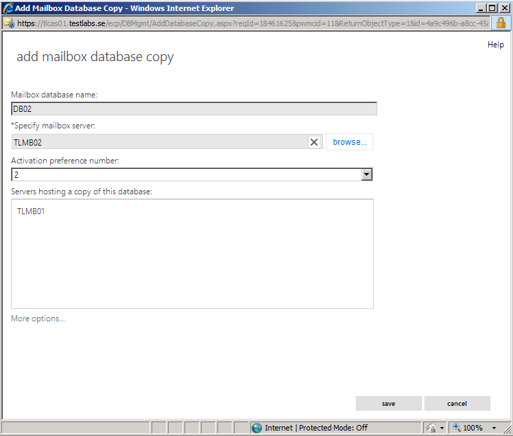

Do the same procedure on all of your databases.
The seeding operation is running.
Press Close.

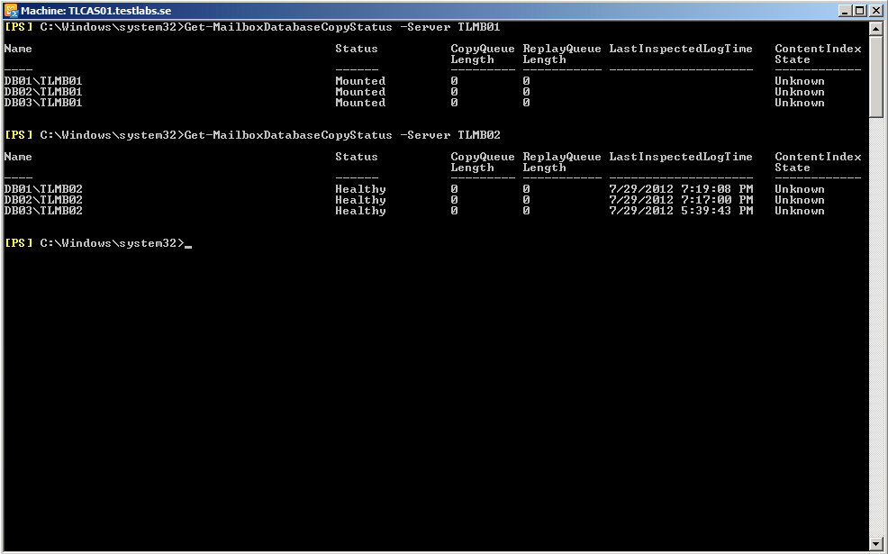

It might take a while (some minutes..) until it get’s Healthy and everything has been checked and verified.
In my test environment it took around 15min to be fine. It should look like the picture below when everything is completed.

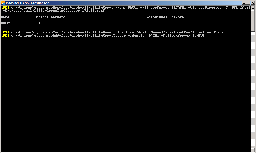

Let’s start with creating the DAG by using the command below:
New-DatabaseAvailabilityGroup –Name DAG01 –WitnessServer TLCAS01 –WitnessDirectory C:\FSW_DAG01 –DatabaseAvailabilityGroupIpAddresses 172.16.1.15
Configure the DAG so that the networks can be manually configured:
Set-DatabaseAvailabilityGroup –Identity DAG01 –ManualDagNetworkConfiguration $True

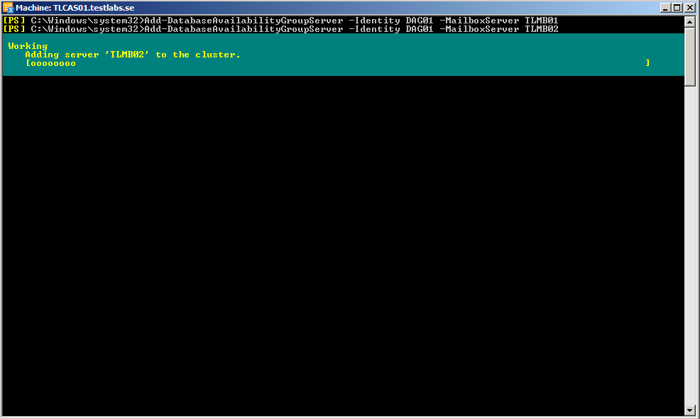

Add the mailbox servers into the DAG:
Add-DatabaseAvailabilityGroupServer –Identity DAG01 –MailboxServer TLMB01
Add-DatabaseAvailabilityGroupServer –Identity DAG01 –MailboxServer TLMB02
Enable DAC mode for the DAG:

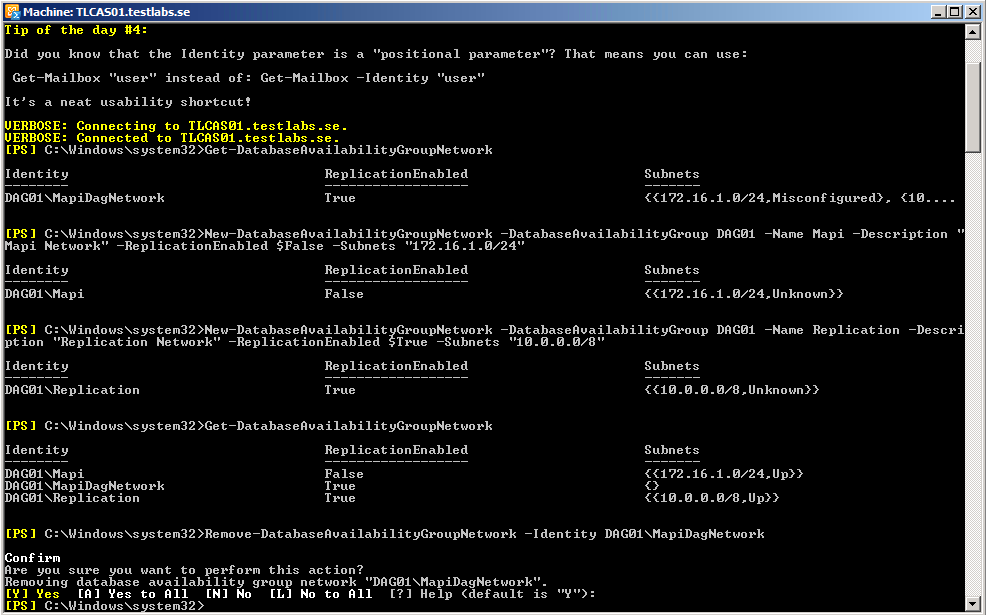

List the DAG Networks:
Get-DatabaseAvailabilityGroupNetwork
Create two new DAG Networks, one for Mapi and one for Replication:
New-DatabaseAvailabilityGroupNetwork –DatabaseAvailabilityGroup DAG01 –Name Mapi –Description “Mapi Network” –ReplicationEnabled $False –Subnets “172.16.1.0/24”
New-DatabaseAvailabilityGroupNetwork –DatabaseAvailabilityGroup DAG01 –Name Replication –Description “Replication Network” –ReplicationEnabled $True –Subnets “10.0.0.0/8”
Remove the automated created network, it will not be used:
Remove-DatabaseAvailabilityGroupNetwork –Identity DAG01\MapiDagNetwork
Database copies

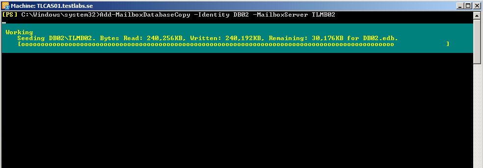

Specify a mailbox server that at the moments doesn’t hold a copy of the database and add it by running the following commands.
Add-MailboxDatabaseCopy –Identity DB01 –MailboxServer TLMB02
Add-MailboxDatabaseCopy –Identity DB02 –MailboxServer TLMB02
Add-MailboxDatabaseCopy –Identity DB03 –MailboxServer TLMB02
Verify the replication status on each mailbox server:
Get-MailboxDatabaseCopyStatus –Server TLMB01
Get-MailboxDatabaseCopyStatus –Server TLMB02

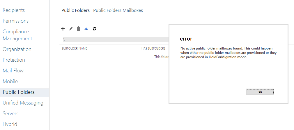

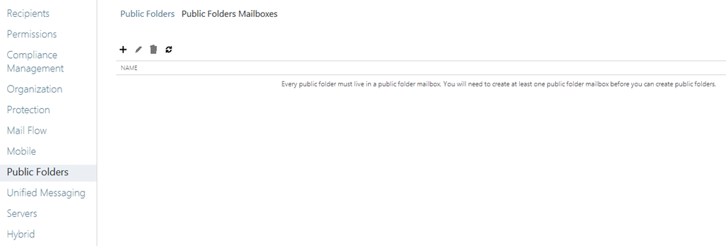

Using EAC: Go to Public Folders section, this is the first warning/error message you will receive.
It means that you don’t have any public folder hierarchy (mailbox) created yet.

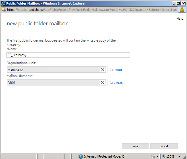

Go to the second public folder selection called “Public Folders Mailboxes”. Add (+), create the first mailbox for the public folders, so it’s hierarchy can be saved.
Give the mailbox a friendly name, example: PF_Hierarchy, place it into an organizational unit and select a mailbox database where it should be saved into. Press Save.

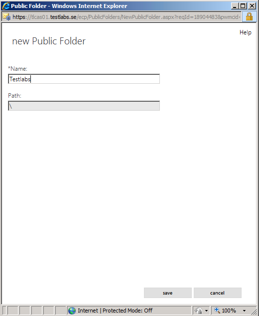

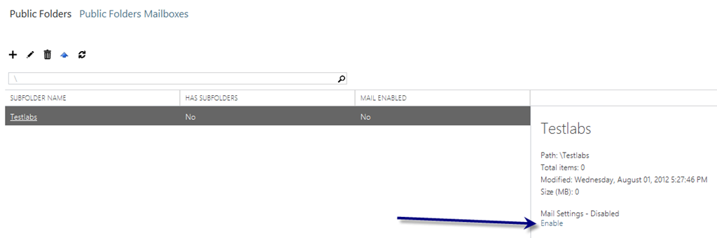

Now when the hierarchy is created, let’s create some test folders too.
Go back to “Public Folders”, press the Add (+) button. Give the public folder a name. Press Save.

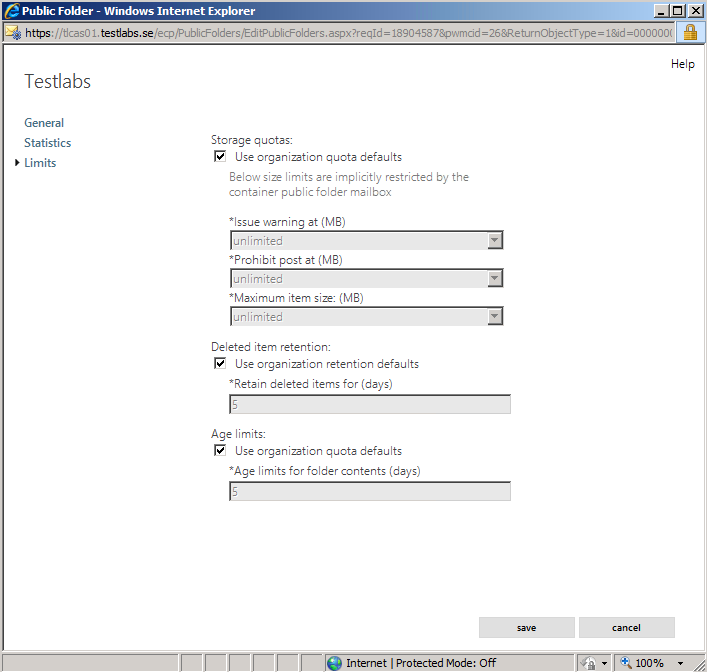

If you want to configure any storage quota on the public folder content, press Edit and configure it. Statistics can also be found under Edit selection, which sometimes is valuable.

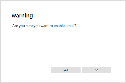

Just for testing purposes I did mail-enable the folder. By pressing the Enable button.
Press Yes.

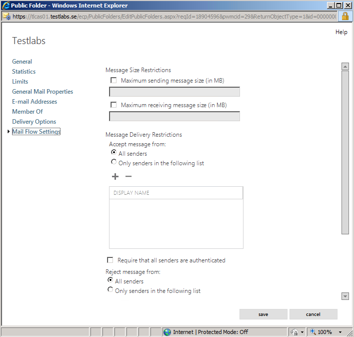

Let’s check the properties for the folder again, now we see that we have lots of new settings. Here’s a small example how the Mail Flow settings looks like.

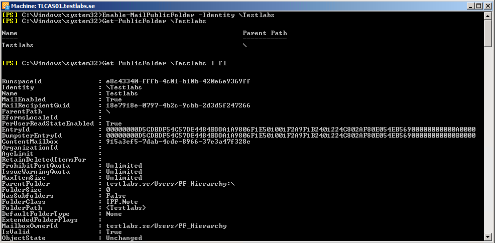

Let’s create the folder named Testlabs
New-PublicFolder –Name Testlabs
Finally, mail enable the public folder
Enable-MailPublicFolder –Identity \Testlabs
