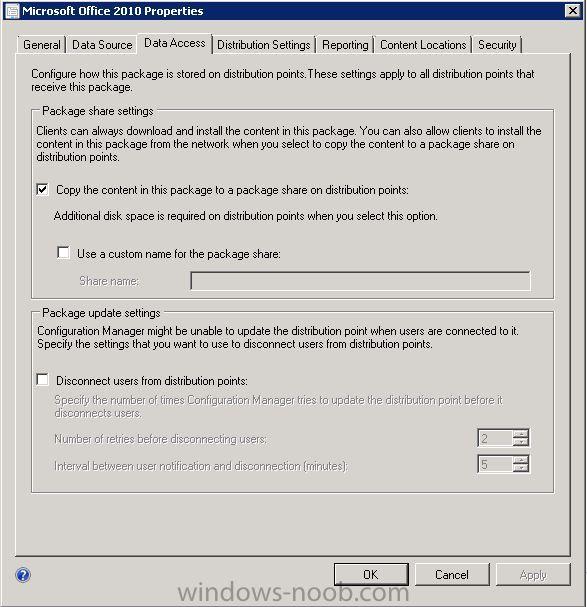

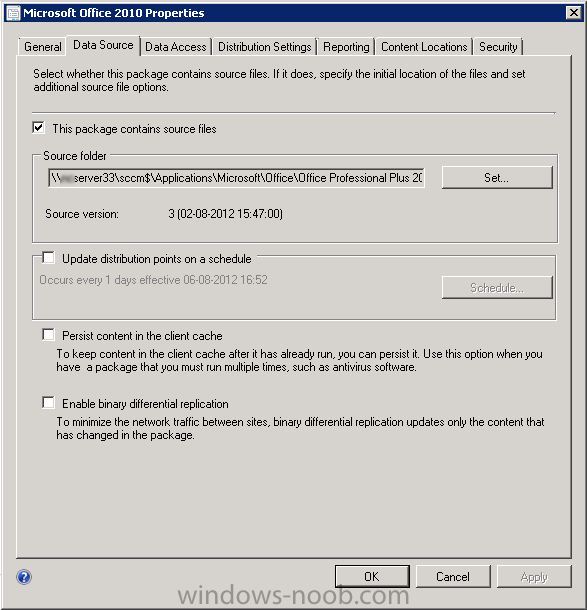

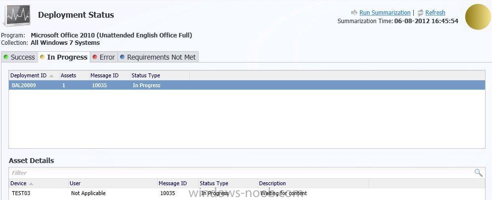

lindevang Posted August 6, 2012 Report post Posted August 6, 2012 Hi Rocket Man It's opening and closing sessions about two times in a second But only when i try to download software through Software Center. When deploying I can't see any errors in the deployment status: Where do I see if my OSD is running directly from the DP or locally - can't find it The software package is configured as followed: Quote Share this post Link to post Share on other sites More sharing options...

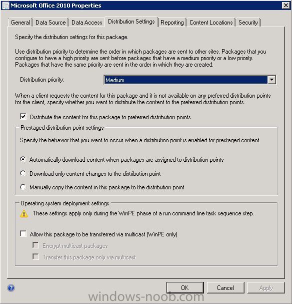

Rocket Man Posted August 7, 2012 Report post Posted August 7, 2012 Have you enable the DP for Prestaging??? I see you have changed the default value in the last snippet from manaully copy to automatically download content. This may be your problem with this package.......and others if they are configured the same With this configuration the DP is waiting for prestage packages and will automatically try to copy them to it constantly.......if you do not need prestaging I suggest you change it back to default.......Prestaging is enabled via DP properties...maybe you selected by accident?? To your question........you specify whether to download content locally or run from DP during the deployment of any program or TS....I think it's at the last configuration wizard page there should be a drop down list....only if you have specified to copy the content to a share on a DP...which you have....so you should get this choice.........do you get this choice???? Rocket Man Quote Share this post Link to post Share on other sites More sharing options...

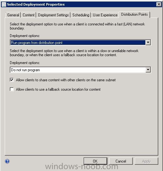

lindevang Posted August 7, 2012 Report post Posted August 7, 2012 Prestaging isn't enabled on my DP. I've changed from software package from "automatically download content" to "manually copy the content". It didn't help. I've tried playing with the deployment options and actually got it working (sort of). Instead of downloading the package locally I changed the package to run directly from the DP. But I would perfer that Software Center download the package and then install it. Any clue? Quote Share this post Link to post Share on other sites More sharing options...
Rocket Man Posted August 7, 2012 Report post Posted August 7, 2012 Can I ask you why you would prefer to download...takes twice as long BITS are to be used for a reason.....I stream as much as I can possible as it takes alot less time to install OS or programs. Have you checked logs, like PKGMGR and DISTRMGR to see if there are any clues there? Quote Share this post Link to post Share on other sites More sharing options...
