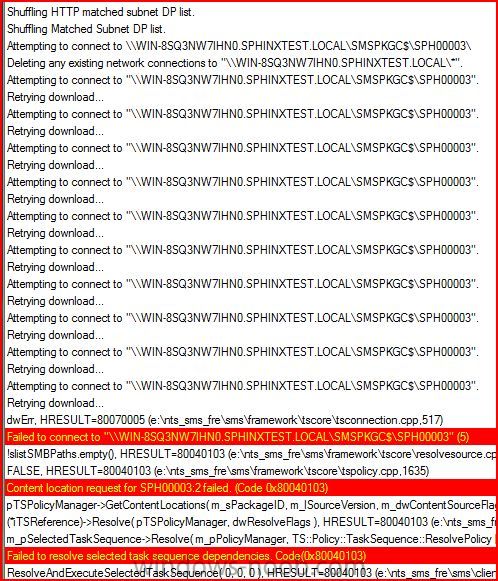

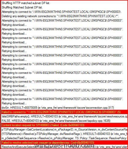

this is exactly the eroor i'm receiving to. I'll add my SMSTS.log file if anybody gets a bit wiser out of that thing.
I have added the vista drivers for network and added it to the boot image. But everytime it still reboots after preparing network connections. I did do a ipconfig and everything is fine. I have still an ip adress and i can make networkshares and access those networkshares.
Anyone that can help i would gladly appreciate it.

<![LOG[LOGGING: Finalize process ID set to 872]LOG]!><time="16:41:53.062+000" date="04-02-2009" component="TSBootShell" context="" type="1" thread="876" file="tslogging.cpp:1489">
<![LOG[==============================[ TSBootShell.exe ]==============================]LOG]!><time="16:41:53.062+000" date="04-02-2009" component="TSBootShell" context="" type="1" thread="876" file="bootshell.cpp:963">
<![LOG[succeeded loading resource DLL 'X:\sms\bin\i386\1033\TSRES.DLL']LOG]!><time="16:41:53.062+000" date="04-02-2009" component="TSBootShell" context="" type="1" thread="876" file="util.cpp:869">
<![LOG[Debug shell is enabled]LOG]!><time="16:41:53.062+000" date="04-02-2009" component="TSBootShell" context="" type="1" thread="876" file="bootshell.cpp:974">
<![LOG[Waiting for PNP initialization...]LOG]!><time="16:41:53.093+000" date="04-02-2009" component="TSBootShell" context="" type="1" thread="892" file="bootshell.cpp:59">
<![LOG[booted from network (PXE)]LOG]!><time="16:42:04.062+000" date="04-02-2009" component="TSBootShell" context="" type="1" thread="892" file="configpath.cpp:198">
<![LOG[Found config path X:\sms\data\]LOG]!><time="16:42:04.062+000" date="04-02-2009" component="TSBootShell" context="" type="1" thread="892" file="bootshell.cpp:553">
<![LOG[booting from removable media, not restoring bootloaders on hard drive]LOG]!><time="16:42:04.062+000" date="04-02-2009" component="TSBootShell" context="" type="1" thread="892" file="bootshell.cpp:564">
<![LOG[Executing command line: wpeinit.exe -winpe]LOG]!><time="16:42:04.062+000" date="04-02-2009" component="TSBootShell" context="" type="1" thread="892" file="bootshell.cpp:767">
<![LOG[The command completed successfully.]LOG]!><time="16:42:14.593+000" date="04-02-2009" component="TSBootShell" context="" type="1" thread="892" file="bootshell.cpp:850">
<![LOG[starting DNS client service.]LOG]!><time="16:42:14.593+000" date="04-02-2009" component="TSBootShell" context="" type="1" thread="892" file="bootshell.cpp:597">
<![LOG[Executing command line: X:\sms\bin\i386\TsmBootstrap.exe /env:WinPE /configpath:X:\sms\data\]LOG]!><time="16:42:15.093+000" date="04-02-2009" component="TSBootShell" context="" type="1" thread="892" file="bootshell.cpp:767">
<![LOG[The command completed successfully.]LOG]!><time="16:42:15.093+000" date="04-02-2009" component="TSBootShell" context="" type="1" thread="892" file="bootshell.cpp:850">
<![LOG[==============================[ TSMBootStrap.exe ]==============================]LOG]!><time="16:42:15.125+000" date="04-02-2009" component="TSMBootstrap" context="" type="1" thread="1436" file="tsmbootstrap.cpp:1038">
<![LOG[Command line: X:\sms\bin\i386\TsmBootstrap.exe /env:WinPE /configpath:X:\sms\data\]LOG]!><time="16:42:15.140+000" date="04-02-2009" component="TSMBootstrap" context="" type="0" thread="1436" file="tsmbootstrap.cpp:1039">
<![LOG[succeeded loading resource DLL 'X:\sms\bin\i386\1033\TSRES.DLL']LOG]!><time="16:42:15.140+000" date="04-02-2009" component="TSMBootstrap" context="" type="1" thread="1436" file="util.cpp:869">
<![LOG[succeeded loading resource DLL 'X:\sms\bin\i386\TSRESNLC.DLL']LOG]!><time="16:42:15.140+000" date="04-02-2009" component="TSMBootstrap" context="" type="1" thread="1436" file="resourceutils.cpp:152">
<![LOG[Processor Is IA64: 0]LOG]!><time="16:42:15.140+000" date="04-02-2009" component="TSMBootstrap" context="" type="1" thread="1436" file="tsmbootstrap.cpp:1004">
<![LOG[PXE Boot with Root = X:\]LOG]!><time="16:42:15.140+000" date="04-02-2009" component="TSMBootstrap" context="" type="1" thread="1436" file="tsmbootstrap.cpp:920">
<![LOG[Executing from PXE in WinPE]LOG]!><time="16:42:15.156+000" date="04-02-2009" component="TSMBootstrap" context="" type="0" thread="1436" file="tsmbootstrap.cpp:935">
<![LOG[Loading TsPxe.dll from X:\sms\bin\i386\TsPxe.dll]LOG]!><time="16:42:15.156+000" date="04-02-2009" component="TSMBootstrap" context="" type="0" thread="1436" file="tsmbootstraputil.cpp:1319">
<![LOG[TsPxe.dll loaded]LOG]!><time="16:42:15.156+000" date="04-02-2009" component="TSPxe" context="" type="0" thread="1436" file="tsmbootstraputil.cpp:1329">
<![LOG[Device has PXE booted]LOG]!><time="16:42:15.156+000" date="04-02-2009" component="TSPxe" context="" type="0" thread="1436" file="tspxe.cpp:122">
<![LOG[Variable Path: \SMSTemp\2009.04.02.16.40.45.0007.{D676040D-48CF-4F55-8CC3-B4E4C6607A33}.boot.var]LOG]!><time="16:42:15.156+000" date="04-02-2009" component="TSPxe" context="" type="0" thread="1436" file="tspxe.cpp:134">
<![LOG[Variable Key Len: 61]LOG]!><time="16:42:15.156+000" date="04-02-2009" component="TSPxe" context="" type="0" thread="1436" file="tspxe.cpp:141">
<![LOG[succesfully added firewall rule for Tftp]LOG]!><time="16:42:15.187+000" date="04-02-2009" component="TSPxe" context="" type="0" thread="1436" file="fwopen.cpp:123">
<![LOG[Executing: X:\sms\bin\i386\smstftp.exe -i 10.1.0.5 get \SMSTemp\2009.04.02.16.40.45.0007.{D676040D-48CF-4F55-8CC3-B4E4C6607A33}.boot.var X:\sms\data\variables.dat]LOG]!><time="16:42:15.187+000" date="04-02-2009" component="TSPxe" context="" type="0" thread="1436" file="tspxe.cpp:177">
<![LOG[Command line for extension .exe is "%1" %*]LOG]!><time="16:42:15.187+000" date="04-02-2009" component="TSPxe" context="" type="0" thread="1436" file="commandline.cpp:229">
<![LOG[set command line: "X:\sms\bin\i386\smstftp.exe" -i 10.1.0.5 get \SMSTemp\2009.04.02.16.40.45.0007.{D676040D-48CF-4F55-8CC3-B4E4C6607A33}.boot.var X:\sms\data\variables.dat]LOG]!><time="16:42:15.187+000" date="04-02-2009" component="TSPxe" context="" type="0" thread="1436" file="commandline.cpp:707">
<![LOG[Executing command line: "X:\sms\bin\i386\smstftp.exe" -i 10.1.0.5 get \SMSTemp\2009.04.02.16.40.45.0007.{D676040D-48CF-4F55-8CC3-B4E4C6607A33}.boot.var X:\sms\data\variables.dat]LOG]!><time="16:42:15.187+000" date="04-02-2009" component="TSPxe" context="" type="1" thread="1436" file="commandline.cpp:805">
<![LOG[Process completed with exit code 0]LOG]!><time="16:42:22.218+000" date="04-02-2009" component="TSPxe" context="" type="1" thread="1436" file="commandline.cpp:1102">
<![LOG[succesfully removed firewall rule for Tftp]LOG]!><time="16:42:22.234+000" date="04-02-2009" component="TSPxe" context="" type="0" thread="1436" file="fwopen.cpp:146">
<![LOG[successfully downloaded pxe variable file.]LOG]!><time="16:42:22.234+000" date="04-02-2009" component="TSPxe" context="" type="1" thread="1436" file="tspxe.cpp:187">
<![LOG[we are booted using PXE]LOG]!><time="16:42:22.234+000" date="04-02-2009" component="TSPxe" context="" type="1" thread="1436" file="tsmediawizardcontrol.cpp:2223">
<![LOG[we are booted using PXE and we use a generated password]LOG]!><time="16:42:22.234+000" date="04-02-2009" component="TSPxe" context="" type="1" thread="1436" file="tsmediawizardcontrol.cpp:2228">
<![LOG[Loading Media Variables from "X:\sms\data\variables.dat"]LOG]!><time="16:42:22.234+000" date="04-02-2009" component="TSPxe" context="" type="1" thread="1436" file="tsremovablemedia.cpp:321">
<![LOG[CryptDecrypt (hKey, 0, 1, 0, pData, &dwDecryptedLen), HRESULT=80090005 (e:\nts_sms_fre\sms\framework\smscrypt\windes.cpp,185)]LOG]!><time="16:42:22.234+000" date="04-02-2009" component="TSPxe" context="" type="0" thread="1436" file="windes.cpp:185">
<![LOG[sMS::Crypto::DES::DecryptBuffer( (BYTE*)pszPassword, wcslen(pszPassword)*sizeof(WCHAR), encryptedBuffer.getBuffer(), encryptedBuffer.size(), pbDecryptedBuffer, dwDecryptedBufferSize ), HRESULT=80090005 (e:\nts_sms_fre\sms\framework\tscore\tsremovablemedia.cpp,386)]LOG]!><time="16:42:22.234+000" date="04-02-2009" component="TSPxe" context="" type="0" thread="1436" file="tsremovablemedia.cpp:386">
<![LOG[Verifying media password.]LOG]!><time="16:42:22.234+000" date="04-02-2009" component="TSPxe" context="" type="1" thread="1436" file="tsmediawizardcontrol.cpp:267">
<![LOG[Found network adapter "Broadcom NetXtreme Gigabit Ethernet" with IP Address 10.1.0.53.]LOG]!><time="16:42:22.281+000" date="04-02-2009" component="TSPxe" context="" type="0" thread="1436" file="tsmbootstraputil.cpp:434">
<![LOG[Loading Media Variables from "X:\sms\data\variables.dat"]LOG]!><time="16:42:22.281+000" date="04-02-2009" component="TSPxe" context="" type="1" thread="1436" file="tsremovablemedia.cpp:321">
<![LOG[CryptDecrypt (hKey, 0, 1, 0, pData, &dwDecryptedLen), HRESULT=80090005 (e:\nts_sms_fre\sms\framework\smscrypt\windes.cpp,185)]LOG]!><time="16:42:22.281+000" date="04-02-2009" component="TSPxe" context="" type="0" thread="1436" file="windes.cpp:185">
<![LOG[sMS::Crypto::DES::DecryptBuffer( (BYTE*)pszPassword, wcslen(pszPassword)*sizeof(WCHAR), encryptedBuffer.getBuffer(), encryptedBuffer.size(), pbDecryptedBuffer, dwDecryptedBufferSize ), HRESULT=80090005 (e:\nts_sms_fre\sms\framework\tscore\tsremovablemedia.cpp,386)]LOG]!><time="16:42:22.281+000" date="04-02-2009" component="TSPxe" context="" type="0" thread="1436" file="tsremovablemedia.cpp:386">
<![LOG[Entering TSMediaWizardControl::GetPolicy.]LOG]!><time="16:42:22.281+000" date="04-02-2009" component="TSPxe" context="" type="0" thread="1436" file="tsmediawizardcontrol.cpp:482">
<![LOG[Environment scope "Global\{51A016B6-F0DE-4752-B97C-54E6F386A912}" successfully created]LOG]!><time="16:42:22.281+000" date="04-02-2009" component="TSPxe" context="" type="1" thread="1436" file="environmentscope.cpp:250">
<![LOG[Environment scope "Global\{BA3A3900-CA6D-4ac1-8C28-5073AFC22B03}" successfully created]LOG]!><time="16:42:22.281+000" date="04-02-2009" component="TSPxe" context="" type="1" thread="1436" file="environmentscope.cpp:250">
<![LOG[setting LogMaxSize to 1000000]LOG]!><time="16:42:22.281+000" date="04-02-2009" component="TSPxe" context="" type="1" thread="1436" file="tsmediawizardcontrol.cpp:510">
<![LOG[setting LogMaxHistory to 1]LOG]!><time="16:42:22.281+000" date="04-02-2009" component="TSPxe" context="" type="1" thread="1436" file="tsmediawizardcontrol.cpp:511">
<![LOG[setting LogLevel to 0]LOG]!><time="16:42:22.281+000" date="04-02-2009" component="TSPxe" context="" type="1" thread="1436" file="tsmediawizardcontrol.cpp:512">
<![LOG[setting LogEnabled to 1]LOG]!><time="16:42:22.281+000" date="04-02-2009" component="TSPxe" context="" type="1" thread="1436" file="tsmediawizardcontrol.cpp:513">
<![LOG[setting LogDebug to 1]LOG]!><time="16:42:22.281+000" date="04-02-2009" component="TSPxe" context="" type="1" thread="1436" file="tsmediawizardcontrol.cpp:514">
<![LOG[Loading variables from the Task Sequencing Removable Media.]LOG]!><time="16:42:22.281+000" date="04-02-2009" component="TSPxe" context="" type="1" thread="1436" file="tsmediawizardcontrol.cpp:534">
<![LOG[setting _SMSMediaGuid TS environment variable]LOG]!><time="16:42:22.281+000" date="04-02-2009" component="TSPxe" context="" type="1" thread="1436" file="tsmediawizardcontrol.cpp:551">
<![LOG[setting _SMSTSBootMediaPackageID TS environment variable]LOG]!><time="16:42:22.281+000" date="04-02-2009" component="TSPxe" context="" type="1" thread="1436" file="tsmediawizardcontrol.cpp:551">
<![LOG[setting _SMSTSHTTPPort TS environment variable]LOG]!><time="16:42:22.281+000" date="04-02-2009" component="TSPxe" context="" type="1" thread="1436" file="tsmediawizardcontrol.cpp:551">
<![LOG[setting _SMSTSHTTPSPort TS environment variable]LOG]!><time="16:42:22.281+000" date="04-02-2009" component="TSPxe" context="" type="1" thread="1436" file="tsmediawizardcontrol.cpp:551">
<![LOG[setting _SMSTSIISSSLState TS environment variable]LOG]!><time="16:42:22.281+000" date="04-02-2009" component="TSPxe" context="" type="1" thread="1436" file="tsmediawizardcontrol.cpp:551">
<![LOG[setting _SMSTSLaunchMode TS environment variable]LOG]!><time="16:42:22.281+000" date="04-02-2009" component="TSPxe" context="" type="1" thread="1436" file="tsmediawizardcontrol.cpp:551">
<![LOG[setting _SMSTSMP TS environment variable]LOG]!><time="16:42:22.281+000" date="04-02-2009" component="TSPxe" context="" type="1" thread="1436" file="tsmediawizardcontrol.cpp:551">
<![LOG[setting _SMSTSMPCerts TS environment variable]LOG]!><time="16:42:22.281+000" date="04-02-2009" component="TSPxe" context="" type="1" thread="1436" file="tsmediawizardcontrol.cpp:551">
<![LOG[setting _SMSTSMPPort TS environment variable]LOG]!><time="16:42:22.281+000" date="04-02-2009" component="TSPxe" context="" type="1" thread="1436" file="tsmediawizardcontrol.cpp:551">
<![LOG[setting _SMSTSMediaPFX TS environment variable]LOG]!><time="16:42:22.281+000" date="04-02-2009" component="TSPxe" context="" type="1" thread="1436" file="tsmediawizardcontrol.cpp:551">
<![LOG[setting _SMSTSPublicRootKey TS environment variable]LOG]!><time="16:42:22.281+000" date="04-02-2009" component="TSPxe" context="" type="1" thread="1436" file="tsmediawizardcontrol.cpp:551">
<![LOG[setting _SMSTSSiteCode TS environment variable]LOG]!><time="16:42:22.281+000" date="04-02-2009" component="TSPxe" context="" type="1" thread="1436" file="tsmediawizardcontrol.cpp:551">
<![LOG[setting _SMSTSUseFirstCert TS environment variable]LOG]!><time="16:42:22.281+000" date="04-02-2009" component="TSPxe" context="" type="1" thread="1436" file="tsmediawizardcontrol.cpp:551">
<![LOG[setting _SMSTSx64UnknownMachineGUID TS environment variable]LOG]!><time="16:42:22.281+000" date="04-02-2009" component="TSPxe" context="" type="1" thread="1436" file="tsmediawizardcontrol.cpp:551">
<![LOG[setting _SMSTSx86UnknownMachineGUID TS environment variable]LOG]!><time="16:42:22.281+000" date="04-02-2009" component="TSPxe" context="" type="1" thread="1436" file="tsmediawizardcontrol.cpp:551">
<![LOG[MP Public Certs=308201EE30820157A00302010202103145360A3536CE9F44F1D38A2B1F6280300D06092A86
4886F70D01010505003028311830160603550403130F57494E2D385351334E573749484E30310C30
0
A06035504031303534D533020170D3039303333303132333130345A180F323130393033303731323
3
3130345A3028311830160603550403130F57494E2D385351334E573749484E30310C300A06035504
0
31303534D5330819F300D06092A864886F70D010101050003818D0030818902818100927A04B6D91
8
4075093116F7B40A1AECADE0009C7BE5FD4CC5F5C1C87200A8DF2A7914E411A9FB5F2CAC7BC01598
5
4E79E50D37C575B90343DB73F463D1E2C79B3D2093D7E88B7107CEC1326BF38CD9AC6CEC14FFE1ED
9
022FCA41EAA7B042DD067B6484528C546F0196F9B6A85934470BC52FC86752ACFF97F1EE1E5BFD6A
50203010001A317301530130603551D25040C300A06082B06010401823765300D06092A864886F70
D
0101050500038181006A105BEA7730FB42F3FF22AFFB04E3E8C78C0740A72A54589714AAF2E9E395
B
7624CC07CFDAE83329E31588CD7E2A9DBF7ED853020E2D81BB4CD594BDCE68FC9438174B7D3641FE
2
F7948F51BB31FB2EDCC38101554F9C07F2DEFB7C4F8E6195414B7538625A91C601650BEDEFBE97DE
7
1CFA612B0D032DE383A3916CDC4FF0D]LOG]!><time="16:42:22.281+000" date="04-02-2009" component="TSPxe" context="" type="1" thread="1436" file="tsmediawizardcontrol.cpp:564">
<![LOG[MP: server=WIN-8SQ3NW7IHN0.SPHINXTEST.LOCAL, http=80, https=443, default=80]LOG]!><time="16:42:22.281+000" date="04-02-2009" component="TSPxe" context="" type="1" thread="1436" file="tsmediawizardcontrol.cpp:571">
<![LOG[Root CA Public Certs=]LOG]!><time="16:42:22.281+000" date="04-02-2009" component="TSPxe" context="" type="1" thread="1436" file="tsmediawizardcontrol.cpp:576">
<![LOG[Missing root CA environment variable from variables file]LOG]!><time="16:42:22.281+000" date="04-02-2009" component="TSPxe" context="" type="1" thread="1436" file="tsmediawizardcontrol.cpp:582">
<![LOG[Custom hook from X:\\TSConfig.INI is ]LOG]!><time="16:42:22.281+000" date="04-02-2009" component="TSPxe" context="" type="1" thread="1436" file="tsmediawizardcontrol.cpp:615">
<![LOG[No custom hook found]LOG]!><time="16:42:22.281+000" date="04-02-2009" component="TSPxe" context="" type="1" thread="1436" file="tsmediawizardcontrol.cpp:452">
<![LOG[No Need to create Authenticator Info]LOG]!><time="16:42:22.296+000" date="04-02-2009" component="TSPxe" context="" type="1" thread="1436" file="tsmediawizardcontrol.cpp:741">
<![LOG[Getting MP time information]LOG]!><time="16:42:22.296+000" date="04-02-2009" component="TSPxe" context="" type="1" thread="1436" file="tsmediawizardcontrol.cpp:752">
<![LOG[Requesting client identity]LOG]!><time="16:42:22.406+000" date="04-02-2009" component="TSPxe" context="" type="1" thread="1436" file="libsmsmessaging.cpp:4910">
<![LOG[Formatted header:]LOG]!><time="16:42:22.406+000" date="04-02-2009" component="TSPxe" context="" type="1" thread="1436" file="libsmsmessaging.cpp:1500">
<![LOG[<Msg SchemaVersion="1.1" ReplyCompression="zlib"><ID/><SourceID>e73eb8ce-502f-4031-9e2b-6bcfbc5c224e</SourceID><SourceHost/><TargetAddress>mp:[http]MP_ClientIDManager</TargetAddress><ReplyTo>direct:OSD</ReplyTo><Priority>3</Priority><Timeout>3600</Timeout><SentTime>2009-04-03T00:42:22Z</SentTime><Protocol>http</Protocol><Body Type="ByteRange" Offset="0" Length="306"/><Hooks/><Payload Type="inline"/><TargetHost/><TargetEndpoint>MP_ClientIDManager</TargetEndpoint><ReplyMode>Sync</ReplyMode><CorrelationID/></Msg>
]LOG]!><time="16:42:22.406+000" date="04-02-2009" component="TSPxe" context="" type="1" thread="1436" file="libsmsmessaging.cpp:1501">
<![LOG[CLibSMSMessageWinHttpTransport::Send: URL: WIN-8SQ3NW7IHN0.SPHINXTEST.LOCAL:80 CCM_POST /ccm_system/request]LOG]!><time="16:42:22.421+000" date="04-02-2009" component="TSPxe" context="" type="1" thread="1436" file="libsmsmessaging.cpp:7446">
<![LOG[The request has succeeded. 200 OK]LOG]!><time="16:42:22.640+000" date="04-02-2009" component="TSPxe" context="" type="0" thread="1436" file="libsmsmessaging.cpp:7734">
<![LOG[Decompressing reply body.]LOG]!><time="16:42:22.656+000" date="04-02-2009" component="TSPxe" context="" type="1" thread="1436" file="libsmsmessaging.cpp:2395">
<![LOG[::DecompressBuffer(65536)]LOG]!><time="16:42:22.656+000" date="04-02-2009" component="TSPxe" context="" type="0" thread="1436" file="ccmzlib.cpp:735">
<![LOG[Decompression (zlib) succeeded: original size 404, uncompressed size 2432.]LOG]!><time="16:42:22.656+000" date="04-02-2009" component="TSPxe" context="" type="0" thread="1436" file="ccmzlib.cpp:646">
<![LOG[Client identity reply: <ClientIDReply RequestReceivedTimeHigh="29995937" RequestReceivedTimeLow="995890113" ReplySentTimeHigh="29995937" ReplySentTimeLow="995987763" ReplyServerTimeZoneBias="-60" ReplyServerTimezoneStandardTimeHigh="33586920" ReplyServerTimezoneStandardTimeLow="33595000" ReplyServerTimeZoneStandardBias="0" ReplyServerTimezoneDaylightTimeHigh="33586920" ReplyServerTimezoneDaylightTimeLow="33595000" ReplyServerTimeZoneDaylightBias="-60" ReplyServerTimezoneStandardTimeYear="0" ReplyServerTimezoneStandardTimeMonth="10" ReplyServerTimezoneStandardTimeDayOfWeek="0" ReplyServerTimezoneStandardTimeDay="5" ReplyServerTimezoneStandardTimeHour="3" ReplyServerTimezoneStandardTimeMinute="0" ReplyServerTimezoneStandardTimeSecond="0" ReplyServerTimezoneStandardTimeMilliSeconds="0" ReplyServerTimezoneDaylightDateYear="0" ReplyServerTimezoneDaylightDateMonth="3" ReplyServerTimezoneDaylightDateDayOfWeek="0" ReplyServerTimezoneDaylightDateDay="5" ReplyServerTimezoneDaylightDateHour="2" ReplyServerTimezoneDaylightDateMinute="0" ReplyServerTimezoneDaylightDateSecond="0" ReplyServerTimezoneDaylightDateMilliSeconds="0" Unknown="0"><Identification><Machine><ClientID/><NetbiosName/></Machine></Identification></ClientIDReply>
]LOG]!><time="16:42:22.656+000" date="04-02-2009" component="TSPxe" context="" type="1" thread="1436" file="libsmsmessaging.cpp:5012">
<![LOG[-60 -60]LOG]!><time="16:42:22.656+000" date="04-02-2009" component="TSPxe" context="" type="1" thread="1436" file="libsmsmessaging.cpp:5082">
<![LOG[server time zone info: -60, , [0 10 0 5 3 0 0 0], 0, , [0 3 0 5 2 0 0 0], -60]LOG]!><time="16:42:22.656+000" date="04-02-2009" component="TSPxe" context="" type="1" thread="1436" file="libsmsmessaging.cpp:5173">
<![LOG[Client Identity: ]LOG]!><time="16:42:22.656+000" date="04-02-2009" component="TSPxe" context="" type="1" thread="1436" file="libsmsmessaging.cpp:5229">
<![LOG[Netbios name: ]LOG]!><time="16:42:22.656+000" date="04-02-2009" component="TSPxe" context="" type="1" thread="1436" file="libsmsmessaging.cpp:5262">
<![LOG[Current time: 2009-04-03 00:42:22.656 TZ:Pacific Standard Time Bias:0480]LOG]!><time="16:42:22.656+000" date="04-02-2009" component="TSPxe" context="" type="1" thread="1436" file="tsmediawizardcontrol.cpp:830">
<![LOG[Current time zone info: 480, Pacific Standard Time, [0 0 0 0 0 0 0 0], 0, , [0 0 0 0 0 0 0 0], 0]LOG]!><time="16:42:22.656+000" date="04-02-2009" component="TSPxe" context="" type="1" thread="1436" file="tsmediawizardcontrol.cpp:834">
<![LOG[Adjusting the system time: -36000.149 seconds]LOG]!><time="16:42:22.656+000" date="04-02-2009" component="TSPxe" context="" type="1" thread="1436" file="tsmediawizardcontrol.cpp:862">
<![LOG[Time zone info set to: -60, , [0 10 0 5 3 0 0 0], 0, , [0 3 0 5 2 0 0 0], -60]LOG]!><time="02:42:22.656+-120" date="04-03-2009" component="TSPxe" context="" type="1" thread="1436" file="tsmediawizardcontrol.cpp:872">
<![LOG[New time: 2009-04-02 14:42:22.506]LOG]!><time="16:42:22.506+-120" date="04-02-2009" component="TSPxe" context="" type="1" thread="1436" file="tsmediawizardcontrol.cpp:912">
<![LOG[Current time: 2009-04-02 14:42:22.506 TZ: Bias:-060]LOG]!><time="16:42:22.506+-120" date="04-02-2009" component="TSPxe" context="" type="1" thread="1436" file="tsmediawizardcontrol.cpp:918">
<![LOG[Downloading policy from WIN-8SQ3NW7IHN0.SPHINXTEST.LOCAL.]LOG]!><time="16:42:22.677+-120" date="04-02-2009" component="TSPxe" context="" type="1" thread="1436" file="tsmediawizardcontrol.cpp:927">
<![LOG[initializing HTTP transport.]LOG]!><time="16:42:22.677+-120" date="04-02-2009" component="TSPxe" context="" type="0" thread="1436" file="tspolicy.cpp:739">
<![LOG[ Setting URL = WIN-8SQ3NW7IHN0.SPHINXTEST.LOCAL.]LOG]!><time="16:42:22.677+-120" date="04-02-2009" component="TSPxe" context="" type="0" thread="1436" file="tspolicy.cpp:740">
<![LOG[ Setting Default Port = 80.]LOG]!><time="16:42:22.677+-120" date="04-02-2009" component="TSPxe" context="" type="0" thread="1436" file="tspolicy.cpp:743">
<![LOG[ Setting SSL = false.]LOG]!><time="16:42:22.677+-120" date="04-02-2009" component="TSPxe" context="" type="0" thread="1436" file="tspolicy.cpp:746">
<![LOG[ Setting CRL = false.]LOG]!><time="16:42:22.677+-120" date="04-02-2009" component="TSPxe" context="" type="0" thread="1436" file="tspolicy.cpp:749">
<![LOG[ Setting Server Certificates.]LOG]!><time="16:42:22.677+-120" date="04-02-2009" component="TSPxe" context="" type="0" thread="1436" file="tspolicy.cpp:766">
<![LOG[ Setting Media Certificate.]LOG]!><time="16:42:22.677+-120" date="04-02-2009" component="TSPxe" context="" type="0" thread="1436" file="tspolicy.cpp:778">
<![LOG[Preparing Client Identity Request.]LOG]!><time="16:42:22.709+-120" date="04-02-2009" component="TSPxe" context="" type="0" thread="1436" file="tspolicy.cpp:527">
<![LOG[ Setting transport.]LOG]!><time="16:42:22.709+-120" date="04-02-2009" component="TSPxe" context="" type="0" thread="1436" file="tspolicy.cpp:530">
<![LOG[ Setting SourceID = e73eb8ce-502f-4031-9e2b-6bcfbc5c224e.]LOG]!><time="16:42:22.709+-120" date="04-02-2009" component="TSPxe" context="" type="0" thread="1436" file="tspolicy.cpp:538">
<![LOG[ Setting site code = SPH.]LOG]!><time="16:42:22.709+-120" date="04-02-2009" component="TSPxe" context="" type="0" thread="1436" file="tspolicy.cpp:543">
<![LOG[ Setting SMBIOS GUID = A6F07E3B-2185-D911-8DEB-00300582BF57.]LOG]!><time="16:42:23.099+-120" date="04-02-2009" component="TSPxe" context="" type="0" thread="1436" file="tspolicy.cpp:567">
<![LOG[ Adding MAC Address 00:30:05:82:BF:57.]LOG]!><time="16:42:23.115+-120" date="04-02-2009" component="TSPxe" context="" type="0" thread="1436" file="tspolicy.cpp:586">
<![LOG[Executing Client Identity Request.]LOG]!><time="16:42:23.115+-120" date="04-02-2009" component="TSPxe" context="" type="0" thread="1436" file="tspolicy.cpp:594">
<![LOG[Requesting client identity]LOG]!><time="16:42:23.115+-120" date="04-02-2009" component="TSPxe" context="" type="1" thread="1436" file="libsmsmessaging.cpp:4910">
<![LOG[Formatted header:]LOG]!><time="16:42:23.115+-120" date="04-02-2009" component="TSPxe" context="" type="1" thread="1436" file="libsmsmessaging.cpp:1500">
<![LOG[<Msg SchemaVersion="1.1" ReplyCompression="zlib"><ID/><SourceID>e73eb8ce-502f-4031-9e2b-6bcfbc5c224e</SourceID><SourceHost/><TargetAddress>mp:[http]MP_ClientIDManager</TargetAddress><ReplyTo>direct:OSD</ReplyTo><Priority>3</Priority><Timeout>3600</Timeout><SentTime>2009-04-02T14:42:23Z</SentTime><Protocol>http</Protocol><Body Type="ByteRange" Offset="0" Length="412"/><Hooks/><Payload Type="inline"/><TargetHost/><TargetEndpoint>MP_ClientIDManager</TargetEndpoint><ReplyMode>Sync</ReplyMode><CorrelationID/></Msg>
]LOG]!><time="16:42:23.115+-120" date="04-02-2009" component="TSPxe" context="" type="1" thread="1436" file="libsmsmessaging.cpp:1501">
<![LOG[CLibSMSMessageWinHttpTransport::Send: URL: WIN-8SQ3NW7IHN0.SPHINXTEST.LOCAL:80 CCM_POST /ccm_system/request]LOG]!><time="16:42:23.115+-120" date="04-02-2009" component="TSPxe" context="" type="1" thread="1436" file="libsmsmessaging.cpp:7446">
<![LOG[The request has succeeded. 200 OK]LOG]!><time="16:42:23.131+-120" date="04-02-2009" component="TSPxe" context="" type="0" thread="1436" file="libsmsmessaging.cpp:7734">
<![LOG[Decompressing reply body.]LOG]!><time="16:42:23.131+-120" date="04-02-2009" component="TSPxe" context="" type="1" thread="1436" file="libsmsmessaging.cpp:2395">
<![LOG[::DecompressBuffer(65536)]LOG]!><time="16:42:23.131+-120" date="04-02-2009" component="TSPxe" context="" type="0" thread="1436" file="ccmzlib.cpp:735">
<![LOG[Decompression (zlib) succeeded: original size 477, uncompressed size 2584.]LOG]!><time="16:42:23.131+-120" date="04-02-2009" component="TSPxe" context="" type="0" thread="1436" file="ccmzlib.cpp:646">
<![LOG[Client identity reply: <ClientIDReply RequestReceivedTimeHigh="29995937" RequestReceivedTimeLow="1002305718" ReplySentTimeHigh="29995937" ReplySentTimeLow="1002325248" ReplyServerTimeZoneBias="-60" ReplyServerTimezoneStandardTimeHigh="33594752" ReplyServerTimezoneStandardTimeLow="33641088" ReplyServerTimeZoneStandardBias="0" ReplyServerTimezoneDaylightTimeHigh="33594752" ReplyServerTimezoneDaylightTimeLow="33641088" ReplyServerTimeZoneDaylightBias="-60" ReplyServerTimezoneStandardTimeYear="0" ReplyServerTimezoneStandardTimeMonth="10" ReplyServerTimezoneStandardTimeDayOfWeek="0" ReplyServerTimezoneStandardTimeDay="5" ReplyServerTimezoneStandardTimeHour="3" ReplyServerTimezoneStandardTimeMinute="0" ReplyServerTimezoneStandardTimeSecond="0" ReplyServerTimezoneStandardTimeMilliSeconds="0" ReplyServerTimezoneDaylightDateYear="0" ReplyServerTimezoneDaylightDateMonth="3" ReplyServerTimezoneDaylightDateDayOfWeek="0" ReplyServerTimezoneDaylightDateDay="5" ReplyServerTimezoneDaylightDateHour="2" ReplyServerTimezoneDaylightDateMinute="0" ReplyServerTimezoneDaylightDateSecond="0" ReplyServerTimezoneDaylightDateMilliSeconds="0" Unknown="0"><Identification><Machine><ClientID>GUID:9A709B37-30B7-41ED-9CB4-77D7891EB15E</ClientID><NetbiosName>SPHINXDEMO</NetbiosName></Machine></Identification></ClientIDReply>
]LOG]!><time="16:42:23.131+-120" date="04-02-2009" component="TSPxe" context="" type="1" thread="1436" file="libsmsmessaging.cpp:5012">
<![LOG[-60 -60]LOG]!><time="16:42:23.131+-120" date="04-02-2009" component="TSPxe" context="" type="1" thread="1436" file="libsmsmessaging.cpp:5082">
<![LOG[server time zone info: -60, , [0 10 0 5 3 0 0 0], 0, , [0 3 0 5 2 0 0 0], -60]LOG]!><time="16:42:23.131+-120" date="04-02-2009" component="TSPxe" context="" type="1" thread="1436" file="libsmsmessaging.cpp:5173">
<![LOG[Client Identity: GUID:9A709B37-30B7-41ED-9CB4-77D7891EB15E]LOG]!><time="16:42:23.131+-120" date="04-02-2009" component="TSPxe" context="" type="1" thread="1436" file="libsmsmessaging.cpp:5229">
<![LOG[Netbios name: SPHINXDEMO]LOG]!><time="16:42:23.131+-120" date="04-02-2009" component="TSPxe" context="" type="1" thread="1436" file="libsmsmessaging.cpp:5262">
<![LOG[Client GUID = GUID:9A709B37-30B7-41ED-9CB4-77D7891EB15E, Netbios name = SPHINXDEMO, State = Known]LOG]!><time="16:42:23.131+-120" date="04-02-2009" component="TSPxe" context="" type="0" thread="1436" file="tspolicy.cpp:608">
<![LOG[Preparing Policy Assignment Request.]LOG]!><time="16:42:23.131+-120" date="04-02-2009" component="TSPxe" context="" type="0" thread="1436" file="tspolicy.cpp:855">
<![LOG[ Setting transport.]LOG]!><time="16:42:23.131+-120" date="04-02-2009" component="TSPxe" context="" type="0" thread="1436" file="tspolicy.cpp:856">
<![LOG[ Setting site code = SPH.]LOG]!><time="16:42:23.131+-120" date="04-02-2009" component="TSPxe" context="" type="0" thread="1436" file="tspolicy.cpp:861">
<![LOG[ Setting client ID = GUID:9A709B37-30B7-41ED-9CB4-77D7891EB15E.]LOG]!><time="16:42:23.131+-120" date="04-02-2009" component="TSPxe" context="" type="0" thread="1436" file="tspolicy.cpp:863">
<![LOG[Executing Policy Assignment Request.]LOG]!><time="16:42:23.131+-120" date="04-02-2009" component="TSPxe" context="" type="0" thread="1436" file="tspolicy.cpp:881">
<![LOG[sending RequestAssignments]LOG]!><time="16:42:23.131+-120" date="04-02-2009" component="TSPxe" context="" type="1" thread="1436" file="libsmsmessaging.cpp:2725">
<![LOG[Formatted header:]LOG]!><time="16:42:23.131+-120" date="04-02-2009" component="TSPxe" context="" type="1" thread="1436" file="libsmsmessaging.cpp:1500">
<![LOG[<Msg SchemaVersion="1.1" ReplyCompression="zlib"><ID/><SourceID>GUID:9A709B37-30B7-41ED-9CB4-77D7891EB15E</SourceID><SourceHost/><TargetAddress>mp:[http]MP_PolicyManager</TargetAddress><ReplyTo>direct:OSD</ReplyTo><Priority>3</Priority><Timeout>3600</Timeout><SentTime>2009-04-02T14:42:23Z</SentTime><Protocol>http</Protocol><Body Type="ByteRange" Offset="0" Length="738"/><Hooks/><Payload Type="inline"/><TargetHost/><TargetEndpoint>MP_PolicyManager</TargetEndpoint><ReplyMode>Sync</ReplyMode><CorrelationID/></Msg>
]LOG]!><time="16:42:23.131+-120" date="04-02-2009" component="TSPxe" context="" type="1" thread="1436" file="libsmsmessaging.cpp:1501">
<![LOG[CLibSMSMessageWinHttpTransport::Send: URL: WIN-8SQ3NW7IHN0.SPHINXTEST.LOCAL:80 CCM_POST /ccm_system/request]LOG]!><time="16:42:23.131+-120" date="04-02-2009" component="TSPxe" context="" type="1" thread="1436" file="libsmsmessaging.cpp:7446">
<![LOG[The request has succeeded. 200 OK]LOG]!><time="16:42:23.162+-120" date="04-02-2009" component="TSPxe" context="" type="0" thread="1436" file="libsmsmessaging.cpp:7734">
<![LOG[Decompressing reply body.]LOG]!><time="16:42:23.162+-120" date="04-02-2009" component="TSPxe" context="" type="1" thread="1436" file="libsmsmessaging.cpp:2395">
<![LOG[::DecompressBuffer(65536)]LOG]!><time="16:42:23.162+-120" date="04-02-2009" component="TSPxe" context="" type="0" thread="1436" file="ccmzlib.cpp:735">
<![LOG[Decompression (zlib) succeeded: original size 4867, uncompressed size 32708.]LOG]!><time="16:42:23.162+-120" date="04-02-2009" component="TSPxe" context="" type="0" thread="1436" file="ccmzlib.cpp:646">
<![LOG[Retrieving Policy Assignments:]LOG]!><time="16:42:23.162+-120" date="04-02-2009" component="TSPxe" context="" type="0" thread="1436" file="tspolicy.cpp:886">
<![LOG[ Processing Policy Assignment {9211acf8-bed1-47b1-a8a5-900a095ab022}.]LOG]!><time="16:42:23.162+-120" date="04-02-2009" component="TSPxe" context="" type="0" thread="1436" file="tspolicy.cpp:895">
<![LOG[ Processing Policy Assignment {618462af-ed67-4ee8-96f2-c33c09580db9}.]LOG]!><time="16:42:23.162+-120" date="04-02-2009" component="TSPxe" context="" type="0" thread="1436" file="tspolicy.cpp:895">
<![LOG[ Processing Policy Assignment {36e6cae6-502c-4f49-b308-83094e8f675a}.]LOG]!><time="16:42:23.162+-120" date="04-02-2009" component="TSPxe" context="" type="0" thread="1436" file="tspolicy.cpp:895">
<![LOG[ Processing Policy Assignment {d65fd73f-b2ff-4bfc-9302-c4ad3b4101e0}.]LOG]!><time="16:42:23.162+-120" date="04-02-2009" component="TSPxe" context="" type="0" thread="1436" file="tspolicy.cpp:895">
<![LOG[ Processing Policy Assignment {722322e9-763f-47b0-8412-2bf47acc0226}.]LOG]!><time="16:42:23.162+-120" date="04-02-2009" component="TSPxe" context="" type="0" thread="1436" file="tspolicy.cpp:895">
<![LOG[ Processing Policy Assignment {1a52ab77-527a-471c-bf86-51f27eb09ffb}.]LOG]!><time="16:42:23.162+-120" date="04-02-2009" component="TSPxe" context="" type="0" thread="1436" file="tspolicy.cpp:895">
<![LOG[ Processing Policy Assignment {6db4051a-3aaa-4ccb-a76d-0891c89c6dfa}.]LOG]!><time="16:42:23.162+-120" date="04-02-2009" component="TSPxe" context="" type="0" thread="1436" file="tspolicy.cpp:895">
<![LOG[ Processing Policy Assignment {9e730723-1e41-4d55-835f-672228a334c1}.]LOG]!><time="16:42:23.162+-120" date="04-02-2009" component="TSPxe" context="" type="0" thread="1436" file="tspolicy.cpp:895">
<![LOG[ Processing Policy Assignment {88c8f9c8-e03d-41d8-989f-3286c10e831b}.]LOG]!><time="16:42:23.162+-120" date="04-02-2009" component="TSPxe" context="" type="0" thread="1436" file="tspolicy.cpp:895">
<![LOG[ Processing Policy Assignment {255cc191-15c8-49c3-a9c5-a90c69db175c}.]LOG]!><time="16:42:23.162+-120" date="04-02-2009" component="TSPxe" context="" type="0" thread="1436" file="tspolicy.cpp:895">
<![LOG[ Processing Policy Assignment {f6ee1276-4a5d-4f8d-b946-7b59c4c8489e}.]LOG]!><time="16:42:23.162+-120" date="04-02-2009" component="TSPxe" context="" type="0" thread="1436" file="tspolicy.cpp:895">
<![LOG[ Processing Policy Assignment {a11307a7-2124-41da-9a3a-d5bac60a35bb}.]LOG]!><time="16:42:23.162+-120" date="04-02-2009" component="TSPxe" context="" type="0" thread="1436" file="tspolicy.cpp:895">
<![LOG[ Processing Policy Assignment {974684f7-6c98-4bfa-9646-f4c3f1625617}.]LOG]!><time="16:42:23.177+-120" date="04-02-2009" component="TSPxe" context="" type="0" thread="1436" file="tspolicy.cpp:895">
<![LOG[ Processing Policy Assignment {1aae3b73-c31d-4914-9db4-05e6a81a2b5d}.]LOG]!><time="16:42:23.177+-120" date="04-02-2009" component="TSPxe" context="" type="0" thread="1436" file="tspolicy.cpp:895">
<![LOG[ Processing Policy Assignment {2f507c03-efba-41f7-8b0d-d12935719f90}.]LOG]!><time="16:42:23.177+-120" date="04-02-2009" component="TSPxe" context="" type="0" thread="1436" file="tspolicy.cpp:895">
<![LOG[ Processing Policy Assignment {1b673c34-a73e-4ce5-8326-1a184b5eadc5}.]LOG]!><time="16:42:23.177+-120" date="04-02-2009" component="TSPxe" context="" type="0" thread="1436" file="tspolicy.cpp:895">
<![LOG[ Processing Policy Assignment {038063ed-e493-4145-8a5b-2a5fc3b10563}.]LOG]!><time="16:42:23.177+-120" date="04-02-2009" component="TSPxe" context="" type="0" thread="1436" file="tspolicy.cpp:895">
<![LOG[ Processing Policy Assignment {611026ea-ffe0-46c1-856d-c66f7aae6ee5}.]LOG]!><time="16:42:23.177+-120" date="04-02-2009" component="TSPxe" context="" type="0" thread="1436" file="tspolicy.cpp:895">
<![LOG[ Processing Policy Assignment {b46eaa72-ada6-420f-b442-5de047661414}.]LOG]!><time="16:42:23.177+-120" date="04-02-2009" component="TSPxe" context="" type="0" thread="1436" file="tspolicy.cpp:895">
<![LOG[ Processing Policy Assignment {595306b2-71c3-428e-a453-e1c2d779c8f8}.]LOG]!><time="16:42:23.177+-120" date="04-02-2009" component="TSPxe" context="" type="0" thread="1436" file="tspolicy.cpp:895">
<![LOG[ Processing Policy Assignment {b70e0a0f-c401-44a8-b2bd-54fbd5454780}.]LOG]!><time="16:42:23.177+-120" date="04-02-2009" component="TSPxe" context="" type="0" thread="1436" file="tspolicy.cpp:895">
<![LOG[ Processing Policy Assignment {5f307e04-ffa2-425f-ac4f-758f8c532a14}.]LOG]!><time="16:42:23.177+-120" date="04-02-2009" component="TSPxe" context="" type="0" thread="1436" file="tspolicy.cpp:895">
<![LOG[ Processing Policy Assignment SPH20003-SPH00009-DBBBC9D6.]LOG]!><time="16:42:23.177+-120" date="04-02-2009" component="TSPxe" context="" type="0" thread="1436" file="tspolicy.cpp:895">
<![LOG[ Processing Policy Assignment DEP-SPH20003-SPH00003-DBBBC9D6.]LOG]!><time="16:42:23.177+-120" date="04-02-2009" component="TSPxe" context="" type="0" thread="1436" file="tspolicy.cpp:895">
<![LOG[ Processing Policy Assignment DEP-SPH20003-SPH00004-DBBBC9D6.]LOG]!><time="16:42:23.177+-120" date="04-02-2009" component="TSPxe" context="" type="0" thread="1436" file="tspolicy.cpp:895">
<![LOG[ Processing Policy Assignment DEP-SPH20003-SPH00008-DBBBC9D6.]LOG]!><time="16:42:23.177+-120" date="04-02-2009" component="TSPxe" context="" type="0" thread="1436" file="tspolicy.cpp:895">
<![LOG[ Processing Policy Assignment DEP-SPH20003-SPH0000A-DBBBC9D6.]LOG]!><time="16:42:23.177+-120" date="04-02-2009" component="TSPxe" context="" type="0" thread="1436" file="tspolicy.cpp:895">
<![LOG[ Processing Policy Assignment DEP-SPH20003-SPH0000B-DBBBC9D6.]LOG]!><time="16:42:23.177+-120" date="04-02-2009" component="TSPxe" context="" type="0" thread="1436" file="tspolicy.cpp:895">
<![LOG[successfully read 28 policy assignments.]LOG]!><time="16:42:23.177+-120" date="04-02-2009" component="TSPxe" context="" type="0" thread="1436" file="tspolicy.cpp:909">
<![LOG[Downloading policy body SPH20003-SPH00009-DBBBC9D6.]LOG]!><time="16:42:23.177+-120" date="04-02-2009" component="TSPxe" context="" type="1" thread="1436" file="tspolicy.cpp:1814">
<![LOG[Preparing Policy Body Request.]LOG]!><time="16:42:23.177+-120" date="04-02-2009" component="TSPxe" context="" type="0" thread="1436" file="tspolicy.cpp:1817">
<![LOG[ Setting transport.]LOG]!><time="16:42:23.177+-120" date="04-02-2009" component="TSPxe" context="" type="0" thread="1436" file="tspolicy.cpp:1818">
<![LOG[ Setting policy location = http://<mp>/SMS_MP/.sms_pol?SPH20003-SPH00009-DBBBC9D6.2_00.]LOG]!><time="16:42:23.177+-120" date="04-02-2009" component="TSPxe" context="" type="0" thread="1436" file="tspolicy.cpp:1820">
<![LOG[Executing Policy Body Request.]LOG]!><time="16:42:23.177+-120" date="04-02-2009" component="TSPxe" context="" type="0" thread="1436" file="tspolicy.cpp:1837">
<![LOG[CLibSMSMessageWinHttpTransport::Send: URL: WIN-8SQ3NW7IHN0.SPHINXTEST.LOCAL:80 GET /SMS_MP/.sms_pol?SPH20003-SPH00009-DBBBC9D6.2_00]LOG]!><time="16:42:23.177+-120" date="04-02-2009" component="TSPxe" context="" type="1" thread="1436" file="libsmsmessaging.cpp:7446">
<![LOG[The request has succeeded. 200 OK]LOG]!><time="16:42:23.209+-120" date="04-02-2009" component="TSPxe" context="" type="0" thread="1436" file="libsmsmessaging.cpp:7734">
<![LOG[found a secure policy]LOG]!><time="16:42:23.209+-120" date="04-02-2009" component="TSPxe" context="" type="1" thread="1436" file="libsmsmessaging.cpp:4318">
<![LOG[decoding policy]LOG]!><time="16:42:23.209+-120" date="04-02-2009" component="TSPxe" context="" type="1" thread="1436" file="libsmsmessaging.cpp:4322">
<![LOG[Reading Policy Body.]LOG]!><time="16:42:23.224+-120" date="04-02-2009" component="TSPxe" context="" type="0" thread="1436" file="tspolicy.cpp:1845">
<![LOG[Parsing Policy Body.]LOG]!><time="16:42:23.224+-120" date="04-02-2009" component="TSPxe" context="" type="0" thread="1436" file="tspolicy.cpp:1852">
<![LOG[This Task sequence is set for RunFromDP]LOG]!><time="16:42:23.224+-120" date="04-02-2009" component="TSPxe" context="" type="1" thread="1436" file="tspolicy.cpp:2618">
<![LOG[Found mandatory advertisement SPH20003]LOG]!><time="16:42:23.240+-120" date="04-02-2009" component="TSPxe" context="" type="1" thread="1436" file="tsmediawizardcontrol.cpp:1020">
<![LOG[using mandatory advertisement SPH20003]LOG]!><time="16:42:23.240+-120" date="04-02-2009" component="TSPxe" context="" type="1" thread="1436" file="tsmediawizardcontrol.cpp:1041">
<![LOG[Retrieving collection variable policy.]LOG]!><time="16:42:23.240+-120" date="04-02-2009" component="TSPxe" context="" type="1" thread="1436" file="tspolicy.cpp:1276">
<![LOG[Found 0 collection variables.]LOG]!><time="16:42:23.240+-120" date="04-02-2009" component="TSPxe" context="" type="0" thread="1436" file="tspolicy.cpp:1284">
<![LOG[Retrieving machine variable policy.]LOG]!><time="16:42:23.240+-120" date="04-02-2009" component="TSPxe" context="" type="1" thread="1436" file="tspolicy.cpp:1295">
<![LOG[Found 0 machine variables.]LOG]!><time="16:42:23.240+-120" date="04-02-2009" component="TSPxe" context="" type="0" thread="1436" file="tspolicy.cpp:1303">
<![LOG[setting machine/collection variables in the task sequencing environment.]LOG]!><time="16:42:23.240+-120" date="04-02-2009" component="TSPxe" context="" type="1" thread="1436" file="utils.cpp:121">
<![LOG[Exiting TSMediaWizardControl::GetPolicy.]LOG]!><time="16:42:23.240+-120" date="04-02-2009" component="TSPxe" context="" type="0" thread="1436" file="tsmediawizardcontrol.cpp:1107">
<![LOG[No content source files for selected task sequence.]LOG]!><time="16:42:23.240+-120" date="04-02-2009" component="TSPxe" context="" type="1" thread="1436" file="tspolicy.cpp:2837">
<![LOG[Getting policy for CCM_SoftwareDistribution[AdvertID=SPH20003", PackageID="SPH00003", ProgramID="*]]LOG]!><time="16:42:23.240+-120" date="04-02-2009" component="TSPxe" context="" type="0" thread="1436" file="tspolicy.cpp:2203">
<![LOG[Downloading policy body DEP-SPH20003-SPH00003-DBBBC9D6.]LOG]!><time="16:42:23.240+-120" date="04-02-2009" component="TSPxe" context="" type="1" thread="1436" file="tspolicy.cpp:1814">
<![LOG[Preparing Policy Body Request.]LOG]!><time="16:42:23.240+-120" date="04-02-2009" component="TSPxe" context="" type="0" thread="1436" file="tspolicy.cpp:1817">
<![LOG[ Setting transport.]LOG]!><time="16:42:23.240+-120" date="04-02-2009" component="TSPxe" context="" type="0" thread="1436" file="tspolicy.cpp:1818">
<![LOG[ Setting policy location = http://<mp>/SMS_MP/.sms_pol?DEP-SPH20003-SPH00003-DBBBC9D6.1_00.]LOG]!><time="16:42:23.240+-120" date="04-02-2009" component="TSPxe" context="" type="0" thread="1436" file="tspolicy.cpp:1820">
<![LOG[Executing Policy Body Request.]LOG]!><time="16:42:23.240+-120" date="04-02-2009" component="TSPxe" context="" type="0" thread="1436" file="tspolicy.cpp:1837">
<![LOG[using Authenticator for policy]LOG]!><time="16:42:23.240+-120" date="04-02-2009" component="TSPxe" context="" type="1" thread="1436" file="libsmsmessaging.cpp:4246">
<![LOG[CLibSMSMessageWinHttpTransport::Send: URL: WIN-8SQ3NW7IHN0.SPHINXTEST.LOCAL:80 GET /SMS_MP/.sms_pol?DEP-SPH20003-SPH00003-DBBBC9D6.1_00]LOG]!><time="16:42:23.240+-120" date="04-02-2009" component="TSPxe" context="" type="1" thread="1436" file="libsmsmessaging.cpp:7446">
<![LOG[The request has succeeded. 200 OK]LOG]!><time="16:42:23.256+-120" date="04-02-2009" component="TSPxe" context="" type="0" thread="1436" file="libsmsmessaging.cpp:7734">
<![LOG[Reading Policy Body.]LOG]!><time="16:42:23.256+-120" date="04-02-2009" component="TSPxe" context="" type="0" thread="1436" file="tspolicy.cpp:1845">
<![LOG[Parsing Policy Body.]LOG]!><time="16:42:23.256+-120" date="04-02-2009" component="TSPxe" context="" type="0" thread="1436" file="tspolicy.cpp:1852">
<![LOG[Getting content hash value for reference package SPH00003 from policy]LOG]!><time="16:42:23.256+-120" date="04-02-2009" component="TSPxe" context="" type="1" thread="1436" file="tspolicy.cpp:2279">
<![LOG[(__hrMethodRetVal == ((HRESULT)0L)) || (bFailIfMissing == false), HRESULT=80070002 (e:\nts_sms_fre\SMS\common\inc\ccmxml.h,566)]LOG]!><time="16:42:23.256+-120" date="04-02-2009" component="TSPxe" context="" type="0" thread="1436" file="ccmxml.h:566">
<![LOG[PackageHash.SDMPackage node not found in the policy assignment property PRG_Requirements.]LOG]!><time="16:42:23.256+-120" date="04-02-2009" component="TSPxe" context="" type="0" thread="1436" file="tspolicy.cpp:2465">
<![LOG[successfully resolved policy for SPH00003.]LOG]!><time="16:42:23.256+-120" date="04-02-2009" component="TSPxe" context="" type="0" thread="1436" file="tspolicy.cpp:2305">
<![LOG[Resolving content location for SPH00003]LOG]!><time="16:42:23.256+-120" date="04-02-2009" component="TSPxe" context="" type="0" thread="1436" file="tspolicy.cpp:2323">
<![LOG[Getting network access account.]LOG]!><time="16:42:23.256+-120" date="04-02-2009" component="TSPxe" context="" type="0" thread="1436" file="tspolicy.cpp:1596">
<![LOG[Downloading policy body {038063ed-e493-4145-8a5b-2a5fc3b10563}.]LOG]!><time="16:42:23.256+-120" date="04-02-2009" component="TSPxe" context="" type="1" thread="1436" file="tspolicy.cpp:1814">
<![LOG[Preparing Policy Body Request.]LOG]!><time="16:42:23.256+-120" date="04-02-2009" component="TSPxe" context="" type="0" thread="1436" file="tspolicy.cpp:1817">
<![LOG[ Setting transport.]LOG]!><time="16:42:23.256+-120" date="04-02-2009" component="TSPxe" context="" type="0" thread="1436" file="tspolicy.cpp:1818">
<![LOG[ Setting policy location = http://<mp>/SMS_MP/.sms_pol?{038063ed-e493-4145-8a5b-2a5fc3b10563}.3_00.]LOG]!><time="16:42:23.256+-120" date="04-02-2009" component="TSPxe" context="" type="0" thread="1436" file="tspolicy.cpp:1820">
<![LOG[Executing Policy Body Request.]LOG]!><time="16:42:23.256+-120" date="04-02-2009" component="TSPxe" context="" type="0" thread="1436" file="tspolicy.cpp:1837">
<![LOG[CLibSMSMessageWinHttpTransport::Send: URL: WIN-8SQ3NW7IHN0.SPHINXTEST.LOCAL:80 GET /SMS_MP/.sms_pol?{038063ed-e493-4145-8a5b-2a5fc3b10563}.3_00]LOG]!><time="16:42:23.271+-120" date="04-02-2009" component="TSPxe" context="" type="1" thread="1436" file="libsmsmessaging.cpp:7446">
<![LOG[The request has succeeded. 200 OK]LOG]!><time="16:42:23.287+-120" date="04-02-2009" component="TSPxe" context="" type="0" thread="1436" file="libsmsmessaging.cpp:7734">
<![LOG[found a secure policy]LOG]!><time="16:42:23.287+-120" date="04-02-2009" component="TSPxe" context="" type="1" thread="1436" file="libsmsmessaging.cpp:4318">
<![LOG[decoding policy]LOG]!><time="16:42:23.287+-120" date="04-02-2009" component="TSPxe" context="" type="1" thread="1436" file="libsmsmessaging.cpp:4322">
<![LOG[Reading Policy Body.]LOG]!><time="16:42:23.287+-120" date="04-02-2009" component="TSPxe" context="" type="0" thread="1436" file="tspolicy.cpp:1845">
<![LOG[Parsing Policy Body.]LOG]!><time="16:42:23.287+-120" date="04-02-2009" component="TSPxe" context="" type="0" thread="1436" file="tspolicy.cpp:1852">
<![LOG[Found NetworkAccessUsername/NetworkAccessPassword from NAAConfig CCM_NetworkAccessAccount]LOG]!><time="16:42:23.287+-120" date="04-02-2009" component="TSPxe" context="" type="1" thread="1436" file="tspolicy.cpp:1520">
<![LOG[Network Access Account has a non-empty value]LOG]!><time="16:42:23.287+-120" date="04-02-2009" component="TSPxe" context="" type="1" thread="1436" file="tspolicy.cpp:1552">
<![LOG[Getting multicast config.]LOG]!><time="16:42:23.287+-120" date="04-02-2009" component="TSPxe" context="" type="0" thread="1436" file="tspolicy.cpp:1600">
<![LOG[Downloading policy body {5f307e04-ffa2-425f-ac4f-758f8c532a14}.]LOG]!><time="16:42:23.287+-120" date="04-02-2009" component="TSPxe" context="" type="1" thread="1436" file="tspolicy.cpp:1814">
<![LOG[Preparing Policy Body Request.]LOG]!><time="16:42:23.287+-120" date="04-02-2009" component="TSPxe" context="" type="0" thread="1436" file="tspolicy.cpp:1817">
<![LOG[ Setting transport.]LOG]!><time="16:42:23.287+-120" date="04-02-2009" component="TSPxe" context="" type="0" thread="1436" file="tspolicy.cpp:1818">
<![LOG[ Setting policy location = http://<mp>/SMS_MP/.sms_pol?{5f307e04-ffa2-425f-ac4f-758f8c532a14}.1_00.]LOG]!><time="16:42:23.287+-120" date="04-02-2009" component="TSPxe" context="" type="0" thread="1436" file="tspolicy.cpp:1820">
<![LOG[Executing Policy Body Request.]LOG]!><time="16:42:23.287+-120" date="04-02-2009" component="TSPxe" context="" type="0" thread="1436" file="tspolicy.cpp:1837">
<![LOG[using Authenticator for policy]LOG]!><time="16:42:23.287+-120" date="04-02-2009" component="TSPxe" context="" type="1" thread="1436" file="libsmsmessaging.cpp:4246">
<![LOG[CLibSMSMessageWinHttpTransport::Send: URL: WIN-8SQ3NW7IHN0.SPHINXTEST.LOCAL:80 GET /SMS_MP/.sms_pol?{5f307e04-ffa2-425f-ac4f-758f8c532a14}.1_00]LOG]!><time="16:42:23.287+-120" date="04-02-2009" component="TSPxe" context="" type="1" thread="1436" file="libsmsmessaging.cpp:7446">
<![LOG[The request has succeeded. 200 OK]LOG]!><time="16:42:23.302+-120" date="04-02-2009" component="TSPxe" context="" type="0" thread="1436" file="libsmsmessaging.cpp:7734">
<![LOG[Reading Policy Body.]LOG]!><time="16:42:23.302+-120" date="04-02-2009" component="TSPxe" context="" type="0" thread="1436" file="tspolicy.cpp:1845">
<![LOG[Parsing Policy Body.]LOG]!><time="16:42:23.302+-120" date="04-02-2009" component="TSPxe" context="" type="0" thread="1436" file="tspolicy.cpp:1852">
<![LOG[Multicast retry count: 3]LOG]!><time="16:42:23.302+-120" date="04-02-2009" component="TSPxe" context="" type="0" thread="1436" file="tspolicy.cpp:1417">
<![LOG[Multicast retry delay: 60]LOG]!><time="16:42:23.302+-120" date="04-02-2009" component="TSPxe" context="" type="0" thread="1436" file="tspolicy.cpp:1427">
<![LOG[Getting local network information.]LOG]!><time="16:42:23.302+-120" date="04-02-2009" component="TSPxe" context="" type="0" thread="1436" file="resolvesource.cpp:1844">
<![LOG[GetAdaptersAddressess entry point is supported.]LOG]!><time="16:42:23.302+-120" date="04-02-2009" component="TSPxe" context="" type="0" thread="1436" file="ccmiputil.cpp:118">
<![LOG[DhcpGetOriginalSubnetMask entry point is supported.]LOG]!><time="16:42:23.302+-120" date="04-02-2009" component="TSPxe" context="" type="0" thread="1436" file="ccmiputil.cpp:181">
<![LOG[Adapter {4140399B-2564-4143-B89B-AEA38F426FB0} is DHCP enabled. Checking quarantine status.]LOG]!><time="16:42:23.302+-120" date="04-02-2009" component="TSPxe" context="" type="0" thread="1436" file="ccmiputil.cpp:509">
<![LOG[Executing content location request for SPH00003:1 as GUID:9A709B37-30B7-41ED-9CB4-77D7891EB15E]LOG]!><time="16:42:23.302+-120" date="04-02-2009" component="TSPxe" context="" type="0" thread="1436" file="resolvesource.cpp:1850">
<![LOG[sending RequestContentLocations]LOG]!><time="16:42:23.318+-120" date="04-02-2009" component="TSPxe" context="" type="1" thread="1436" file="libsmsmessaging.cpp:3367">
<![LOG[Formatted header:]LOG]!><time="16:42:23.318+-120" date="04-02-2009" component="TSPxe" context="" type="1" thread="1436" file="libsmsmessaging.cpp:1500">
<![LOG[<Msg SchemaVersion="1.1" ReplyCompression="zlib"><ID/><SourceID>GUID:9A709B37-30B7-41ED-9CB4-77D7891EB15E</SourceID><SourceHost/><TargetAddress>mp:[http]MP_LocationManager</TargetAddress><ReplyTo>direct:OSD</ReplyTo><Priority>3</Priority><Timeout>3600</Timeout><SentTime>2009-04-02T14:42:23Z</SentTime><Protocol>http</Protocol><Body Type="ByteRange" Offset="0" Length="602"/><Hooks/><Payload Type="inline"/><TargetHost/><TargetEndpoint>MP_LocationManager</TargetEndpoint><ReplyMode>Sync</ReplyMode><CorrelationID/></Msg>
]LOG]!><time="16:42:23.318+-120" date="04-02-2009" component="TSPxe" context="" type="1" thread="1436" file="libsmsmessaging.cpp:1501">
<![LOG[CLibSMSMessageWinHttpTransport::Send: URL: WIN-8SQ3NW7IHN0.SPHINXTEST.LOCAL:80 CCM_POST /ccm_system/request]LOG]!><time="16:42:23.318+-120" date="04-02-2009" component="TSPxe" context="" type="1" thread="1436" file="libsmsmessaging.cpp:7446">
<![LOG[The request has succeeded. 200 OK]LOG]!><time="16:42:23.334+-120" date="04-02-2009" component="TSPxe" context="" type="0" thread="1436" file="libsmsmessaging.cpp:7734">
<![LOG[Decompressing reply body.]LOG]!><time="16:42:23.334+-120" date="04-02-2009" component="TSPxe" context="" type="1" thread="1436" file="libsmsmessaging.cpp:2395">
<![LOG[::DecompressBuffer(65536)]LOG]!><time="16:42:23.334+-120" date="04-02-2009" component="TSPxe" context="" type="0" thread="1436" file="ccmzlib.cpp:735">
<![LOG[Decompression (zlib) succeeded: original size 465, uncompressed size 1524.]LOG]!><time="16:42:23.334+-120" date="04-02-2009" component="TSPxe" context="" type="0" thread="1436" file="ccmzlib.cpp:646">
<![LOG[Filtering Content Locations.]LOG]!><time="16:42:23.349+-120" date="04-02-2009" component="TSPxe" context="" type="0" thread="1436" file="resolvesource.cpp:1881">
<![LOG[ Adding \\WIN-8SQ3NW7IHN0.SPHINXTEST.LOCAL\SMSPKGC$\SPH00003\ to Remote DP list.]LOG]!><time="16:42:23.349+-120" date="04-02-2009" component="TSPxe" context="" type="1" thread="1436" file="resolvesource.cpp:1958">
<![LOG[Found 0 DPs in subnet, 0 DPs in local site, 1 DPs in remote location and 0 Multicast DPs]LOG]!><time="16:42:23.349+-120" date="04-02-2009" component="TSPxe" context="" type="1" thread="1436" file="resolvesource.cpp:1972">
<![LOG[shuffling HTTP remote DP list.]LOG]!><time="16:42:23.349+-120" date="04-02-2009" component="TSPxe" context="" type="0" thread="1436" file="resolvesource.cpp:2045">
<![LOG[shuffling Remote DP list.]LOG]!><time="16:42:23.349+-120" date="04-02-2009" component="TSPxe" context="" type="0" thread="1436" file="resolvesource.cpp:2118">
<![LOG[Attempting to connect to \\WIN-8SQ3NW7IHN0.SPHINXTEST.LOCAL\SMSPKGC$\SPH00003\]LOG]!><time="16:42:23.349+-120" date="04-02-2009" component="TSPxe" context="" type="1" thread="1436" file="resolvesource.cpp:2149">
<![LOG[Deleting any existing network connections to "\\WIN-8SQ3NW7IHN0.SPHINXTEST.LOCAL\*".]LOG]!><time="16:42:23.349+-120" date="04-02-2009" component="TSPxe" context="" type="0" thread="1436" file="tsconnection.cpp:407">
<![LOG[Attempting to connect to "\\WIN-8SQ3NW7IHN0.SPHINXTEST.LOCAL\SMSPKGC$\SPH00003".]LOG]!><time="16:42:23.349+-120" date="04-02-2009" component="TSPxe" context="" type="0" thread="1436" file="tsconnection.cpp:501">
<![LOG[Retrying download...]LOG]!><time="16:42:23.427+-120" date="04-02-2009" component="TSPxe" context="" type="1" thread="1436" file="tsconnection.cpp:508">
<![LOG[Executing command line: X:\WINDOWS\system32\cmd.exe /k]LOG]!><time="16:42:25.115+-120" date="04-02-2009" component="TSBootShell" context="" type="1" thread="876" file="bootshell.cpp:767">
<![LOG[The command completed successfully.]LOG]!><time="16:42:25.131+-120" date="04-02-2009" component="TSBootShell" context="" type="1" thread="876" file="bootshell.cpp:850">
<![LOG[successfully launched command shell.]LOG]!><time="16:42:25.131+-120" date="04-02-2009" component="TSBootShell" context="" type="1" thread="876" file="bootshell.cpp:430">
<![LOG[Attempting to connect to "\\WIN-8SQ3NW7IHN0.SPHINXTEST.LOCAL\SMSPKGC$\SPH00003".]LOG]!><time="16:42:26.427+-120" date="04-02-2009" component="TSPxe" context="" type="0" thread="1436" file="tsconnection.cpp:501">
<![LOG[Retrying download...]LOG]!><time="16:42:26.474+-120" date="04-02-2009" component="TSPxe" context="" type="1" thread="1436" file="tsconnection.cpp:508">
<![LOG[Attempting to connect to "\\WIN-8SQ3NW7IHN0.SPHINXTEST.LOCAL\SMSPKGC$\SPH00003".]LOG]!><time="16:42:29.474+-120" date="04-02-2009" component="TSPxe" context="" type="0" thread="1436" file="tsconnection.cpp:501">
<![LOG[Retrying download...]LOG]!><time="16:42:29.568+-120" date="04-02-2009" component="TSPxe" context="" type="1" thread="1436" file="tsconnection.cpp:508">
<![LOG[Attempting to connect to "\\WIN-8SQ3NW7IHN0.SPHINXTEST.LOCAL\SMSPKGC$\SPH00003".]LOG]!><time="16:42:32.568+-120" date="04-02-2009" component="TSPxe" context="" type="0" thread="1436" file="tsconnection.cpp:501">
<![LOG[Retrying download...]LOG]!><time="16:42:32.662+-120" date="04-02-2009" component="TSPxe" context="" type="1" thread="1436" file="tsconnection.cpp:508">
<![LOG[Attempting to connect to "\\WIN-8SQ3NW7IHN0.SPHINXTEST.LOCAL\SMSPKGC$\SPH00003".]LOG]!><time="16:42:35.662+-120" date="04-02-2009" component="TSPxe" context="" type="0" thread="1436" file="tsconnection.cpp:501">
<![LOG[Retrying download...]LOG]!><time="16:42:35.756+-120" date="04-02-2009" component="TSPxe" context="" type="1" thread="1436" file="tsconnection.cpp:508">
<![LOG[Attempting to connect to "\\WIN-8SQ3NW7IHN0.SPHINXTEST.LOCAL\SMSPKGC$\SPH00003".]LOG]!><time="16:42:38.756+-120" date="04-02-2009" component="TSPxe" context="" type="0" thread="1436" file="tsconnection.cpp:501">
<![LOG[Retrying download...]LOG]!><time="16:42:38.849+-120" date="04-02-2009" component="TSPxe" context="" type="1" thread="1436" file="tsconnection.cpp:508">
<![LOG[Attempting to connect to "\\WIN-8SQ3NW7IHN0.SPHINXTEST.LOCAL\SMSPKGC$\SPH00003".]LOG]!><time="16:42:41.849+-120" date="04-02-2009" component="TSPxe" context="" type="0" thread="1436" file="tsconnection.cpp:501">
<![LOG[Retrying download...]LOG]!><time="16:42:41.943+-120" date="04-02-2009" component="TSPxe" context="" type="1" thread="1436" file="tsconnection.cpp:508">
<![LOG[Attempting to connect to "\\WIN-8SQ3NW7IHN0.SPHINXTEST.LOCAL\SMSPKGC$\SPH00003".]LOG]!><time="16:42:44.943+-120" date="04-02-2009" component="TSPxe" context="" type="0" thread="1436" file="tsconnection.cpp:501">
<![LOG[Retrying download...]LOG]!><time="16:42:45.052+-120" date="04-02-2009" component="TSPxe" context="" type="1" thread="1436" file="tsconnection.cpp:508">
<![LOG[Attempting to connect to "\\WIN-8SQ3NW7IHN0.SPHINXTEST.LOCAL\SMSPKGC$\SPH00003".]LOG]!><time="16:42:48.052+-120" date="04-02-2009" component="TSPxe" context="" type="0" thread="1436" file="tsconnection.cpp:501">
<![LOG[Retrying download...]LOG]!><time="16:42:48.146+-120" date="04-02-2009" component="TSPxe" context="" type="1" thread="1436" file="tsconnection.cpp:508">
<![LOG[Attempting to connect to "\\WIN-8SQ3NW7IHN0.SPHINXTEST.LOCAL\SMSPKGC$\SPH00003".]LOG]!><time="16:42:51.146+-120" date="04-02-2009" component="TSPxe" context="" type="0" thread="1436" file="tsconnection.cpp:501">
<![LOG[Retrying download...]LOG]!><time="16:42:51.240+-120" date="04-02-2009" component="TSPxe" context="" type="1" thread="1436" file="tsconnection.cpp:508">
<![LOG[dwErr, HRESULT=80070056 (e:\nts_sms_fre\sms\framework\tscore\tsconnection.cpp,517)]LOG]!><time="16:42:54.240+-120" date="04-02-2009" component="TSPxe" context="" type="0" thread="1436" file="tsconnection.cpp:517">
<![LOG[Failed to connect to "\\WIN-8SQ3NW7IHN0.SPHINXTEST.LOCAL\SMSPKGC$\SPH00003" (86)]LOG]!><time="16:42:54.240+-120" date="04-02-2009" component="TSPxe" context="" type="3" thread="1436" file="tsconnection.cpp:517">
<![LOG[!slistSMBPaths.empty(), HRESULT=80040103 (e:\nts_sms_fre\sms\framework\tscore\resolvesource.cpp,2161)]LOG]!><time="16:42:54.240+-120" date="04-02-2009" component="TSPxe" context="" type="0" thread="1436" file="resolvesource.cpp:2161">
<![LOG[FALSE, HRESULT=80040103 (e:\nts_sms_fre\sms\framework\tscore\tspolicy.cpp,1635)]LOG]!><time="16:42:54.240+-120" date="04-02-2009" component="TSPxe" context="" type="0" thread="1436" file="tspolicy.cpp:1635">
<![LOG[Content location request for SPH00003:1 failed. (Code 0x80040103)]LOG]!><time="16:42:54.240+-120" date="04-02-2009" component="TSPxe" context="" type="3" thread="1436" file="tspolicy.cpp:1635">
<![LOG[pTSPolicyManager->GetContentLocations( m_sPackageID, m_lSourceVersion, m_dwContentSourceFlags, slistContentLocations, slistHttpContentLocations, slistMulticastContentLocations, m_dwContentPackageFlags ), HRESULT=80040103 (e:\nts_sms_fre\sms\framework\tscore\tspolicy.cpp,2330)]LOG]!><time="16:42:54.240+-120" date="04-02-2009" component="TSPxe" context="" type="0" thread="1436" file="tspolicy.cpp:2330">
<![LOG[(*iTSReference)->Resolve( pTSPolicyManager, dwResolveFlags ), HRESULT=80040103 (e:\nts_sms_fre\sms\framework\tscore\tspolicy.cpp,2862)]LOG]!><time="16:42:54.240+-120" date="04-02-2009" component="TSPxe" context="" type="0" thread="1436" file="tspolicy.cpp:2862">
<![LOG[m_pSelectedTaskSequence->Resolve( m_pPolicyManager, TS::Policy::TaskSequence::ResolvePolicy | TS::Policy::TaskSequence::ResolveSource, fpCallbackProc, pv, hCancelEvent), HRESULT=80040103 (e:\nts_sms_fre\sms\client\tasksequence\tsmbootstrap\tsmediawizardcontrol.cpp,1207)]LOG]!><time="16:42:54.240+-120" date="04-02-2009" component="TSPxe" context="" type="0" thread="1436" file="tsmediawizardcontrol.cpp:1207">
<![LOG[Failed to resolve selected task sequence dependencies. Code(0x80040103)]LOG]!><time="16:42:54.240+-120" date="04-02-2009" component="TSPxe" context="" type="3" thread="1436" file="tsmediawizardcontrol.cpp:1207">
<![LOG[ResolveAndExecuteSelectedTaskSequence( 0, 0, 0 ), HRESULT=80040103 (e:\nts_sms_fre\sms\client\tasksequence\tsmbootstrap\tsmediawizardcontrol.cpp,2099)]LOG]!><time="16:42:54.240+-120" date="04-02-2009" component="TSPxe" context="" type="0" thread="1436" file="tsmediawizardcontrol.cpp:2099">
<![LOG[RunWizardForPXE(), HRESULT=80040103 (e:\nts_sms_fre\sms\client\tasksequence\tsmbootstrap\tsmediawizardcontrol.cpp,2383)]LOG]!><time="16:42:54.240+-120" date="04-02-2009" component="TSPxe" context="" type="0" thread="1436" file="tsmediawizardcontrol.cpp:2383">
<![LOG[oTSMediaWizardControl.Run( sMediaRoot, true, true ), HRESULT=80040103 (e:\nts_sms_fre\sms\client\tasksequence\tsmbootstrap\tsmbootstrap.cpp,936)]LOG]!><time="16:42:54.240+-120" date="04-02-2009" component="TSPxe" context="" type="0" thread="1436" file="tsmbootstrap.cpp:936">
<![LOG[Execute( eExecutionEnv, sConfigPath, sTSXMLFile, uBootCount, &uExitCode ), HRESULT=80040103 (e:\nts_sms_fre\sms\client\tasksequence\tsmbootstrap\tsmbootstrap.cpp,1105)]LOG]!><time="16:42:54.240+-120" date="04-02-2009" component="TSPxe" context="" type="0" thread="1436" file="tsmbootstrap.cpp:1105">
<![LOG[Exiting with return code 0x80040103]LOG]!><time="16:42:54.240+-120" date="04-02-2009" component="TSPxe" context="" type="1" thread="1436" file="tsmbootstrap.cpp:1117">
<![LOG[Execution complete.]LOG]!><time="16:42:54.240+-120" date="04-02-2009" component="TSBootShell" context="" type="1" thread="892" file="bootshell.cpp:624">
<![LOG[Finalizing logging from process 872]LOG]!><time="16:42:54.240+-120" date="04-02-2009" component="TSBootShell" context="" type="1" thread="892" file="tslogging.cpp:1736">
<![LOG[Finalizing logs to root of first available drive]LOG]!><time="16:42:54.240+-120" date="04-02-2009" component="TSBootShell" context="" type="1" thread="892" file="tslogging.cpp:1578">
<![LOG[LOGGING: Setting log directory to "C:\SMSTSLog".]LOG]!><time="16:42:54.256+-120" date="04-02-2009" component="TSBootShell" context="" type="1" thread="892" file="tslogging.cpp:1803">
look at this
  Quote
so, find out what package SPH00003:1 is, and verify that it is distributed properly to DP(s)
then try again
  anyweb said:
look at this
then try again
I think i might have found the problem. The share had no permissions set at all. So probably the access to that file was not allowed and so the PXE screen rebooted.
I had once installed the trace thing of SCCM, but didn't knew for what it was used, and found 3 errors in thatone.
I'll let you know later if I succeeded or not ;)
EDIT: did seems not to have been the problem. I can access the share wihtout problems now but i still get the same errors in smsts.log
in the SPH00003 i find a folder with the following things:
ccmsetup
What kind of package is this?
it's probably the ConfigMgr client installation files, make sure to redistribute the package to it's DP's
the package in question is this one http://www.windows-noob.com/forums/index.p...dpost&p=713
please note, you can verify a package from its package ID and by looking under System Status/Package status....
You are right.
I checked out the PXEFilter and it didn't seem right, cause i forgot to change the collection ID. I didn't knew what it was before, so left it default.
Now I'm having troubles reinstalling the PXE Filter. I redid the entire steps you posted with that link and i deleted the pxe provider service in SCCM. I did readd it but pxe filter always says with exclamtion that PXE provider isn't installed.
