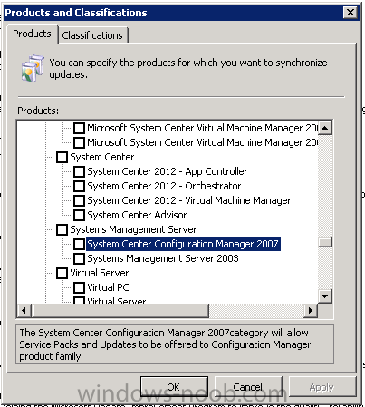

In the WSUS server, under products and classification, have you checked product "System center configuration manager" ?
WSUS updates Log files can be found at :
\Program Files\Update Services\LogFiles\software distribution.log
open it with notepad and try searching the string configuration manager or so...
