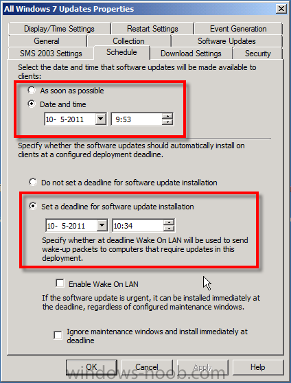

Also check your deployment settings (Computer Management > Software Updates > Deployment Management) when the updates will be made available to the client.
Attached is a screenshot of the settings for a deployment package from my environment (which works perfectly).
Yes, it only gets the updates it needs.
Updates will not be downloaded untill the installation of the updates is started. The installation can be started manually or you can use a deadline in the deployment settings of the update package. Do you get the popup of the SCCM agent which says there are updates available?
Thanks for the reply.
I checked my settings and had the advertisement to run "as soon as possible" and had a time about 5 minutes ahead on the bottom selection.
Weird, it appeared to download one of the updates but I didn't see it installed.
And yes, I will get the advert window popup just as test when it did run successfully which was the first time i set it up. Its only when I apply changes to the updates that nothing happens.
