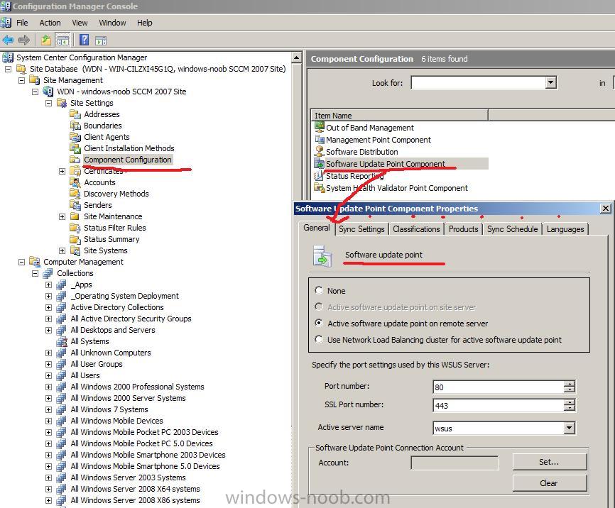

Install WSUS but do not configure it. Once done, make sure the Software Update Point Role is installed on the SCCM Server.
Once you've added the Software Update Point role, verify that it is installed by checking the SUPSetup.log, it should have a line which reads Installation was successful

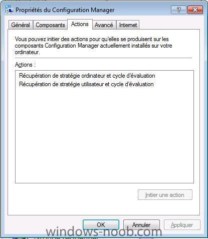

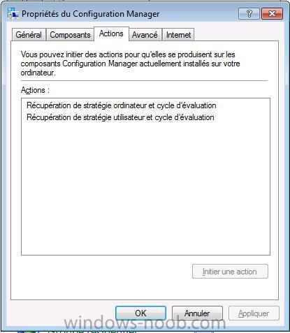

I tried to do like you but it's doesn't work. On a client, in Configuration Manager Property(control panel), in Action, I haven't got (so i can't initiate the action i want)Machine Policy Retrieval & Evaluation Cycle, Software Updates Deployment Evaluation Cycle , Software Updates Scan Cycle.
try temporarily disbaling the firewall on the client and do a Data Discovery, do you see the client in configmgr collections ? is it approved and client=yes ?
