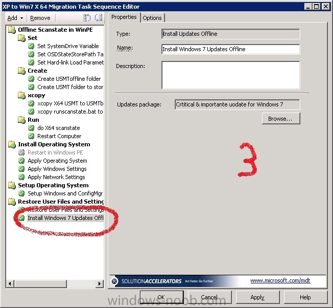

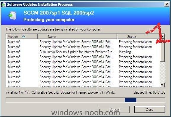

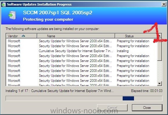

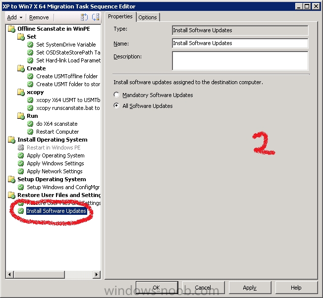

Hi there,
I would like install all update after an os deployement with software (like Windows 7 and Office 2010) because I need to ensure that any new installations are fully patched. I follow a topic from this website and I think my "Software Update" are OK beacause I can deploy update (picture 1). I hope it's possible and i think (I'm not sure) you need to use "Install Software Update" (picture 2) to do this. Anybody can confirmed me that? I see you can deploy update with package (picture 3) but I think you need to update your package so, it's not for me the better solution.
Thanks in advance.
Best Regards
yes it's possible, just advertise a new deployment management task (or tasks) containing the updates (both windows 7 and office updates) to the collection(s) that the computers are in
OK and think you fir your answer.
But how to do this? How advertise a new deployment management task (or tasks) containing the updates? I just need to do like this : http://www.windows-noob.com/forums/index.php?/topic/1815-using-update-lists-when-deploying-monthly-updates/ and add "Install Software Update" in TS?
Thanks in advance.
Best Regards
yep that shows you how to point the Deployment Management Task to a specific collection, you should probably create two Deployment Management Tasks, point one to your Deployment Collection and the other to the Unknown Computers Collection
