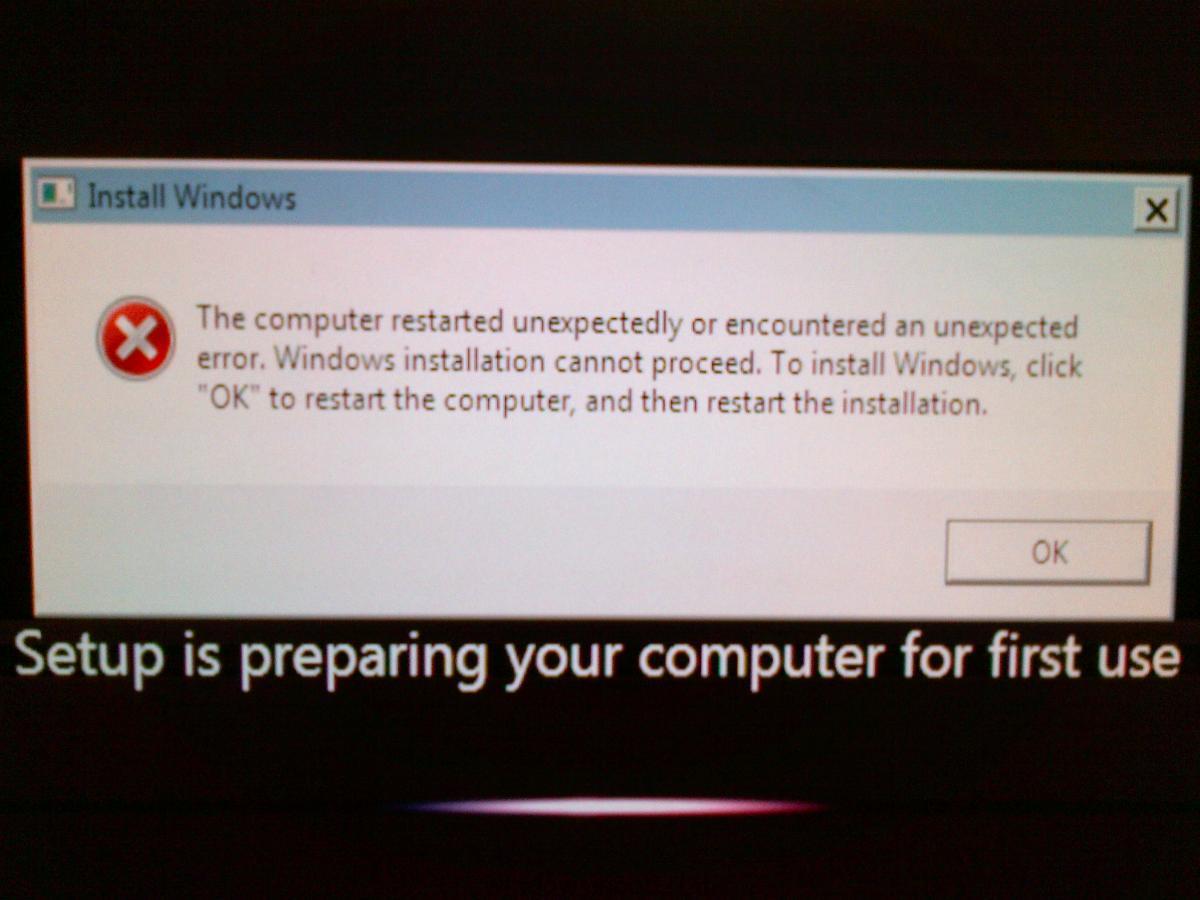

i've not long move from sccm 2007 to sccm 2012, i migrated over the things i need packages drivers wim's tasks etc. so my issue i'm trying to image a pc with our custom image.

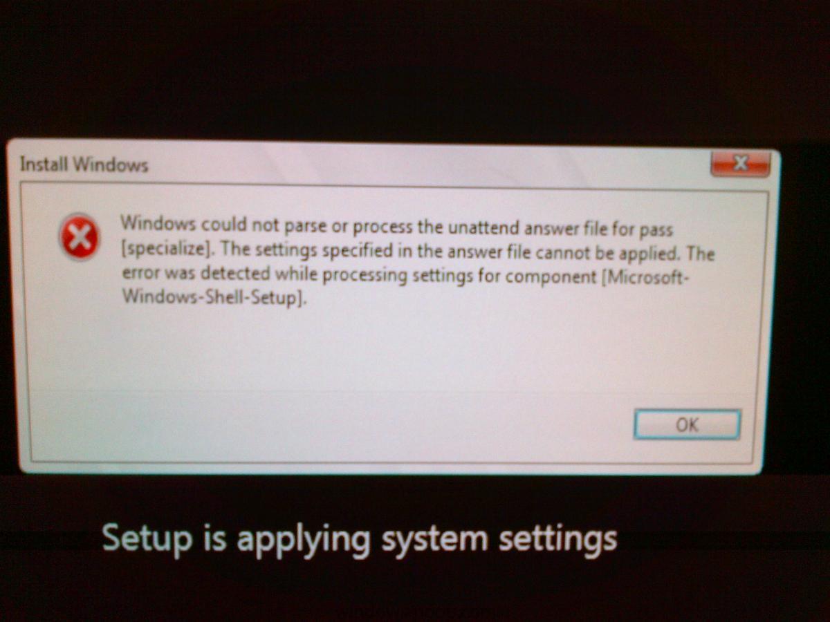

everything works as normal until my task sequence gets to the apply operating system, the operating system gets downloaded onto the client as it should, i get the screen "starting windows" then i get an error msg (see error 1) if i click ok the pc reboots then i get another error (see error 2) then the pc will go in a loop if i click ok it will reboot and display the same error message.

i found the problem, there was nothing wrong with the unattend.xml as there shouldn't have been since i only migrated it, i never edited it at all, anyway my problem turned out to be the "source folder" path i had set for my MDT Settings package.
well the source folder came over from my old sccm 2007, it was set as - \\servername\e$\osd\mdtsettings which it didn't like, once i changed the path to - \\servername\osd\mdtsettings i re-run the task and it worked.
