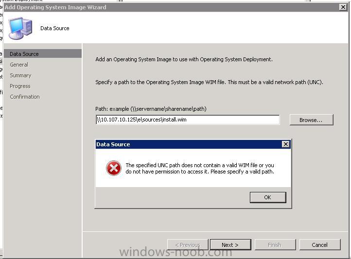

Could some one help me.
When i try to add operating system image, i browse to Network path (for example \\10.107.10.125\e\sources\install.wim) and when i press next button i get an error "The specified UNC path does not contain a valid WIM file or you do not have permission to access it. Please specify a valid path".
The strange thing is that i can browse to my source location with wizart.
SCCM server is installed on computer joined to domain. (not on domain controler)
Site is pushed to AD, I can install client on to remote computer successfully.
There is everyone permission on source share dirctory.
What coud be the problem?
  anyweb said:
what OS are you trying to add the install.wim file from ? and how was that copied to the share it is in now
This is win2k8 64 bit, copy paste from original cd. But i think problem is not in version of cd, because when i'm trying to deploy firefox from network source, i get an error in event log, that i have no access to network source.
  anyweb said:
everyone=all users so not likely,
can you open Windows Explorer and browse to the same folder and WRITE a file to it ?
Yes i can write the files there. You see i think the problem is that, when i have installed sccm 2007 not on Domain controler, sccm created local users, and have not created users in AD, and sccm uses local user to access network share (and i think local computer users have no access to shares on computers)
if you havn't created the two SMS groups in AD like you are supposed to then how can I help ?
or can you please explain what you think you are missing here as I'm out of ideas
I have theory, that SCCM uses only those goups it has created on local computer. Can it be true?
