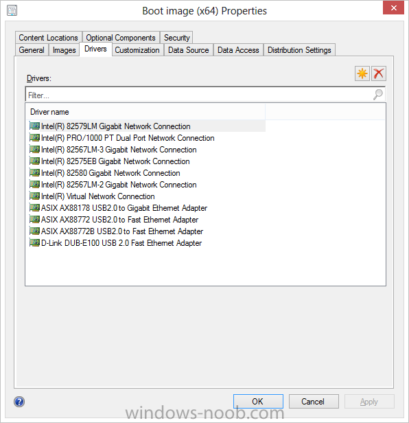

I use a VMware machone to PXE boot and this goed great, the boot image gets offered win PE starts and after waiting a while the SCCM intro screen even appears, but then the windows gets prepared and the network settings are set the VMware machine reboots please advice
I read in the blog i need to add drivers to the bootimage for the standard VMware ethernetcard, can some explain how I do that
enable cmd support and press F8 prior to it bombing out, then grab the smsts.log file located in x:\windows\temp\smstslog\smsts.log
post it here
to add drivers to your boot image simply right click the boot image attached to your task sequence, select the drivers tab then add a driver by clicking on the yellow star... point to the required driver and continue through the wizard, only add NETwork drivers that you actually need by verifiying if lack of network (ipconfig is a good test) is actually your problem.
