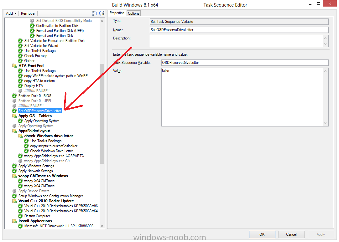

see here, just place it before the Apply Operating Image step in your Build task sequence
Unfortunately that didn't resolve the D drive issue. I believe I've tried everything.
