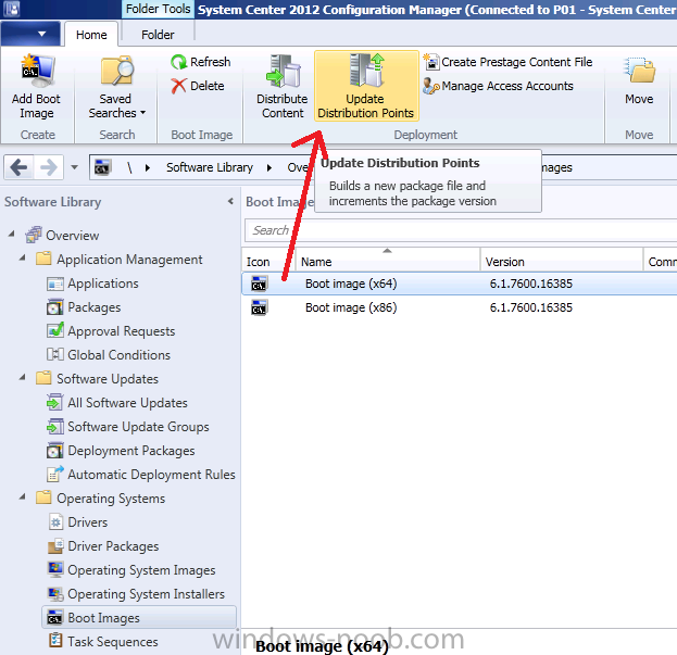

once you've added the driver to your boot.wim images you need to Update Your Distribution Points (not add dp's)
see the screenshot below..
