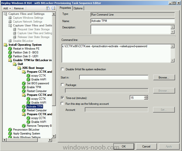

my step looks like so, and it works just fine, your logs should reveal what your issue really is, have you tried a bios upgrade on the dell ?
It is strange - I have done a BIOS upgrade to the latest version. It does work without the '=' so I will stick with that. The problem I am having at the moment is it fails on the Enable BitLocker step, however, I believe this may be to do with the fact that we have no Group Policy entry for 'Choose how BitLocker-protected operating system drives can be recovered'. I'm assuming without this Group Policy step configured the computer has no idea what to do with the recover keys?
well the logs should reveal why it's failing to enable bitlocker so what does the smsts.log file say ?
