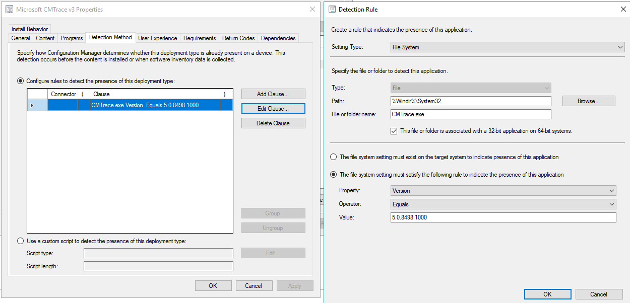

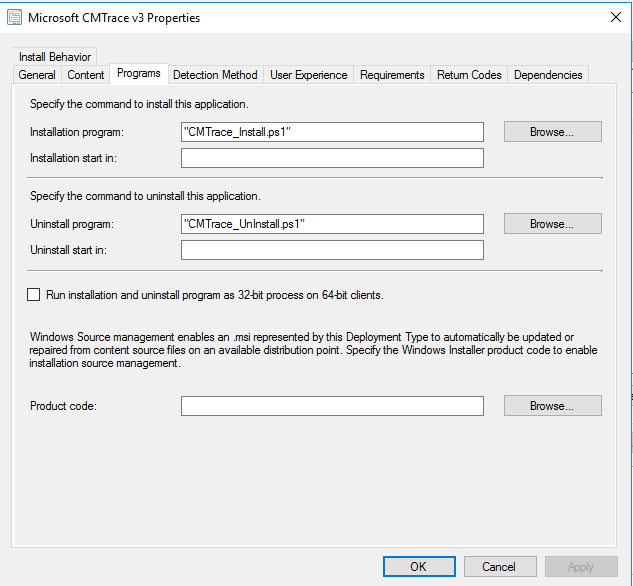

0 tr3mblay Posted February 21, 2019 Report post Posted February 21, 2019 Old post i ran into while looking at deploying CMTrace. I completed the deployment using PowerShell scripts, with the addition of copying a link to the Public Desktop. CMTrace_Install.ps1 # Path to store the .ico and .exe $AppPath = 'C:\Windows\System32' # Path of the Public Desktop for shortcut $AppShortcut = "C:\Users\Public\Desktop" # Copy the .ico, .exe, and .lnk. Copy-Item .\CMTrace.lnk -Destination $AppShortcut Copy-Item .\CMTrace.ico -Destination $AppPath Copy-Item .\CMTrace.exe -Destination $AppPath CMTrace_UnInstall.ps1 # Path to store the .ico and .exe $AppPath = 'C:\Windows\System32' # Path of the Public Desktop shortcut $AppShortcut = 'C:\Users\Public\Desktop' # Remove the .ico, .exe, and .lnk Remove-Item $AppShortcut\CMTrace.lnk Remove-Item $AppPath\CMTrace.exe Remove-Item $AppPath\CMTrace.ico Quote Share this post Link to post Share on other sites More sharing options...

Just tested this thing and I'm kind of thrilled.. so I wanted to deploy cmtrace as an CM12 application,
I did it with the quick-and-dirty method.
So, I created a new application, and for the deployment type I checked script and the actual install program was as follows
xcopy.exe ".\*.*" "%windir%\system32" /D /E /C /I /Q /H /R /Y /S
And the uninstall program was as follows
del.exe %windir%\system32\cmtrace.exe
Detection method was of course checking the presence of cmtrace in %windir%\system32.
