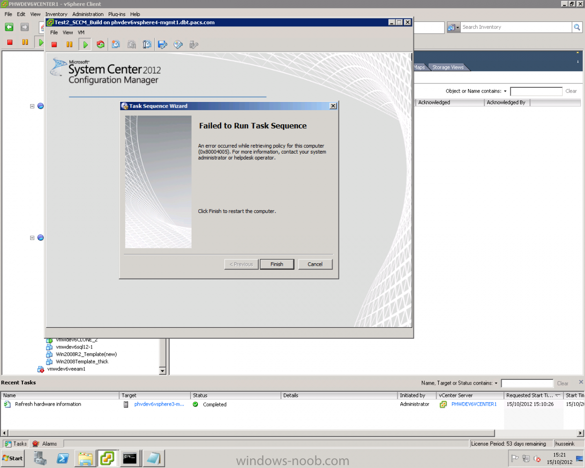

0 kabirhussein Posted October 16, 2012 Report post Posted October 16, 2012 Hi trevor my appologies for not getting back, for some reason i was not getting notification about your post. So currently i have done the below: I have tried the build and capture task sequence and successfully managed to create a WIM file from a deployment. I then added the WIM file to SCCM Operating System Images and distributed this to my one and only DP. i then created a task sequence media wizard, SCCM created a ISO file which i mounted onto my VMware machine. I got to the part when i enter the network credentials, i noted the MAC address and inputted this into SCCM devices where you click on import device via computer. Once i added the MAC addres, i then cofigured the IP address manually on the OS that i wanted to deploy. After i click on next, i get the below error message. Any idea why i can not get past this stage - have attempted several different things and still stuck. many thanks Quote Share this post Link to post Share on other sites More sharing options...

0 Trevor Sullivan Posted October 16, 2012 Report post Posted October 16, 2012 Posting contents of an e-mail exchange: Although you may have enabled command support (F8) testing in your boot image, you must update the boot image on your distribution points for this change to take effect. Since you are not using PXE booting, you must also manually update your boot media after the distribution points have finished updating. The 0x80004005 (Access Denied) error message that you are receiving can be caused by many different reasons, not necessarily permissions related. For example, you might receive this if there is no network connectivity to the ConfigMgr site server, which is obviously not a permissions-related problem. This can happen if: The client cannot route to the site server The client cannot resolve DNS for the site server There is no network access account configured (other reason, stated in the smsts.log) The first paragraph above should help you get command support testing enabled, and from there, you should be able to find your smsts.log. This will be your best bet in helping you to discover what is going wrong. Cheers, Trevor Sullivan http://trevorsullivan.net http://twitter.com/pcgeek86 Quote Share this post Link to post Share on other sites More sharing options...

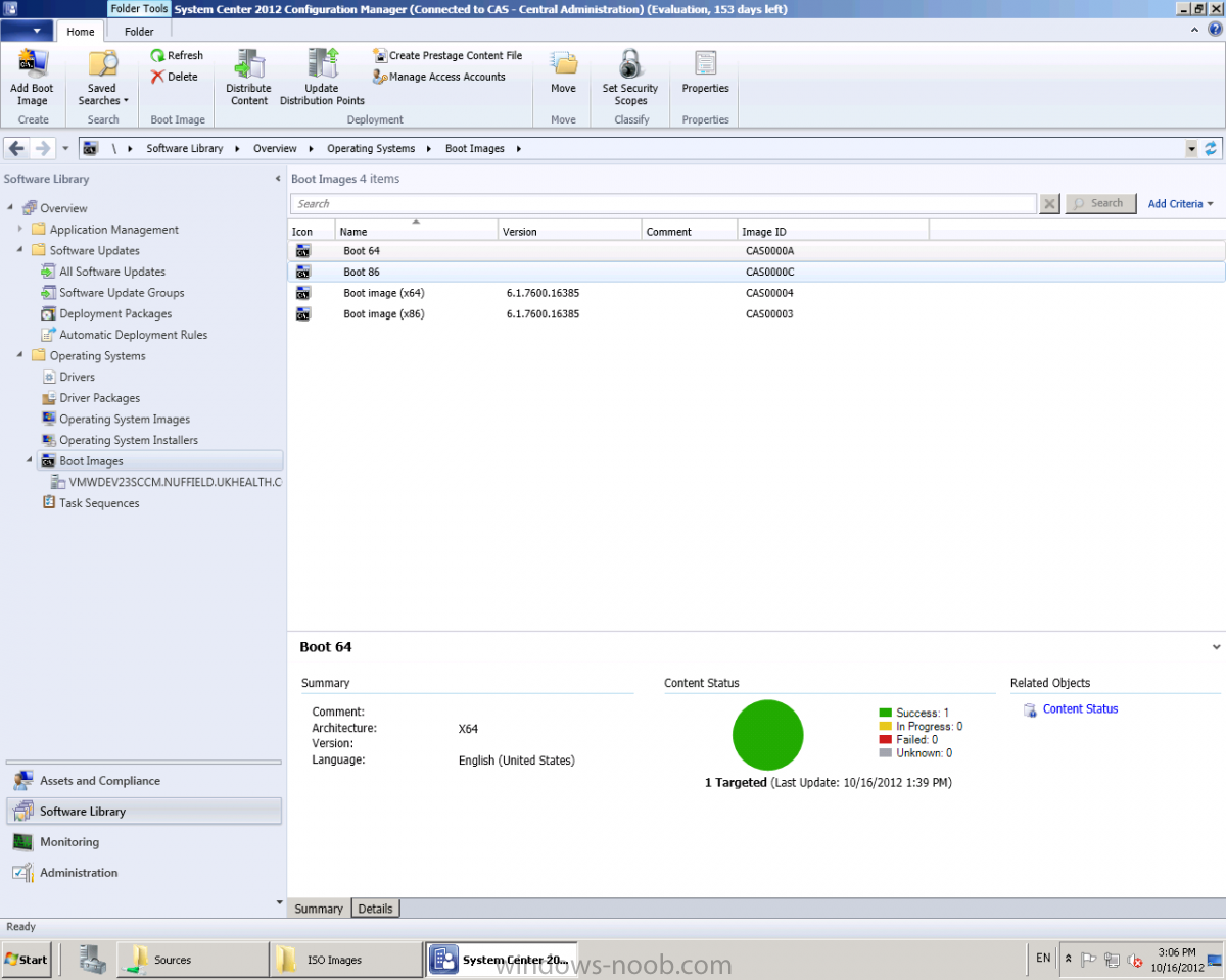

0 kabirhussein Posted October 16, 2012 Report post Posted October 16, 2012 Adding email exchange.. Hi Trevor Many thanks for replying back to me so quick. Not sure what you mean regarding this – “you must also manually update your boot media after the distribution points have finished updating.” Also I had some issues updating the distribution point for my boot images so I created new ones – and enabled the command support, distributed them and then deployed the boot images. I then created a new task sequence media and select boot image. This created fine, I added the ISO file to a Virtual machine and got the same error. When I try press F8 I don’t get anywhere :-( not sure why i can not get the F8 working... think it would be key in trying to resolve this failed OSD task.. Quote Share this post Link to post Share on other sites More sharing options...
