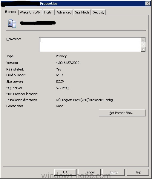

My SCCM doesn't have those boot options either and I integrated MDT 2010 with it. Here is a screenshot of my version. What am I missing?
