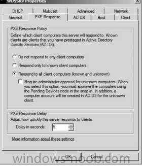

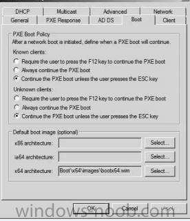

Is the snippet above from your own server? Has it been configured fully...I see there is still a yellow exclamation mark on the server node!
If all the roles needed for WDS reside on the same server then you only need to check both boxes as stated from the main snippet above...you do not need to touch the DHCP server as stated in the NOTE... checking the boxes on the WDS console will add the options automatically.
Have you added boot.wims and images to the server yet?

Yes I have added the boot.wim in the "install an Image" and "Capture an Image" parts at the end of the video,using a Windows 7 32bit ISO and I have made a installation group and added an install.wim in there as well.
