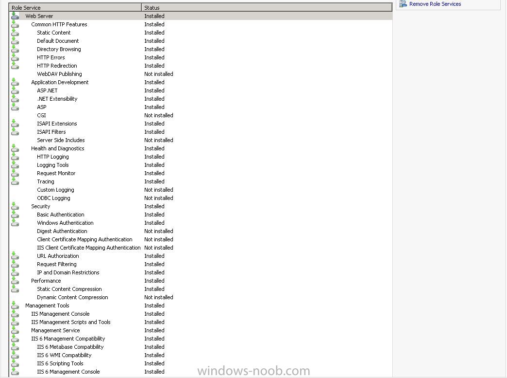

Irakli Posted October 22, 2012 Report post Posted October 22, 2012 here is my IIS configuration I have SCCM 2012 Quote Share this post Link to post Share on other sites More sharing options...
