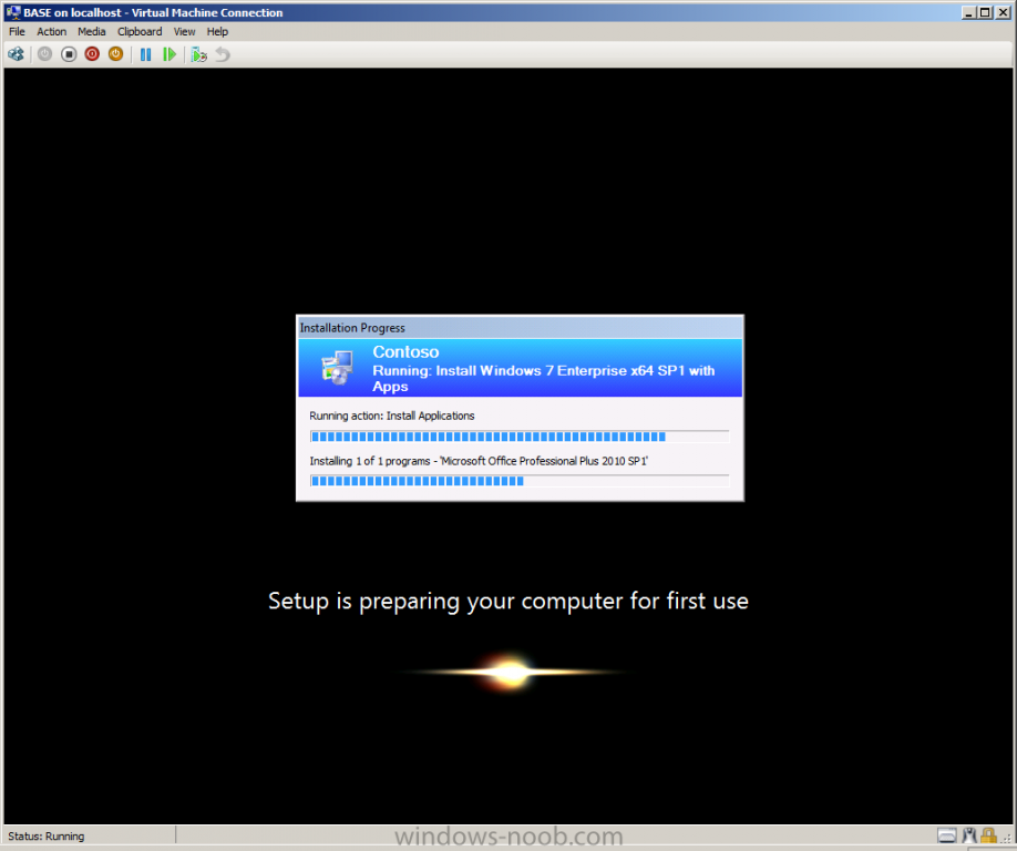

hhancock Posted November 1, 2012 Report post Posted November 1, 2012 Is there a way to monitor a Task Sequence? Is the only way through the SMSTS.log on the client? I have a TS that was running fine. I've added an application to the TS (Microsoft Office Professional Plus 2010 SP1) and it appears to be taking a VERY long time (currently over 45 minutes). The appliaction was configured with all defaults and no additional customizations. The TS without this application only took ~25 minutes. Is it normal to take this long? How do I know when to cancel and try to find out why it's not finishing? Quote Share this post Link to post Share on other sites More sharing options...

hhancock Posted November 1, 2012 Report post Posted November 1, 2012 It says that, "the task sequence execution engine started the group (Install Applications)." But nothing comes after that. Quote Share this post Link to post Share on other sites More sharing options...

hhancock Posted November 1, 2012 Report post Posted November 1, 2012 On 11/1/2012 at 3:19 PM, Kingen said: I know Office can take a very long time to install, is this a Build & Capture TS? If not i can recommend that you design office with the Customizing Tool and they include it in you standard .wim file. Somehow it goes faster to install it like that, then to have it as a separate Application in the TS. When i did a BC with Office 2013 and with all products, it took 90Minutes to finish just that step. This is not a build and capture. I did a basic build and capture and then installed all the updates to the .WIM using Offline Servicing. I then created a installation task sequence that installs Office 2010 separately. I guess I will give it more time. Just seems a little suspect that it can take over 1 hour to install Office... I just started the process again and haven't let it sit to long but this is where is just basically stops. There are no errors or anything in the logs that I can see. Quote Share this post Link to post Share on other sites More sharing options...
