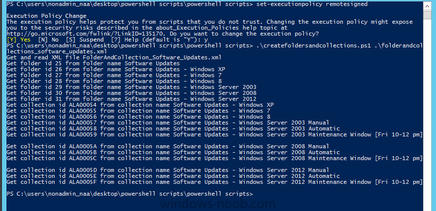

Sadly, I can't really even get going on this part because the script doesn't seem to be doing anything for me. I've followed the steps to a tee and the script kicks off and runs without any kind of errors. However, when I open the console, I still don't have any folders created. I will say that I jumped ahead at some point during all this and started syncing updates a while back. As such, I already have a boatload of updates showing up under "All Software Updates." Could that cause an issue with the folders not being created?
Any help would be highly appreciated!

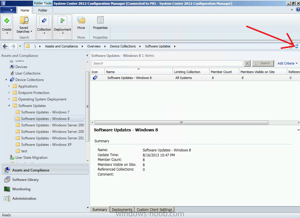

are you sure you are looking in the right part of the console ? have you tried refreshing the view ? i've just rechecked the script on a Configuration Manager 2012 SP1 primary and the collections appeared after I refreshed the console after the script ran.
Thanks for the quick reply!
Unfortunately, I am looking in the right place and have tried refreshing several times. I've even tried re-running the script. Again, it runs without errors, but it does provide different information. I'm not great at reading and understanding scripts, but with the first run, I could tell where it was creating/moving folders and setting collections and maintenance windows. On subsequent runs, it's just performing "Get" commands. It's acting as if the folders do, in fact, exist. But, I don't understand why I don't see them... :/ See screens below.
