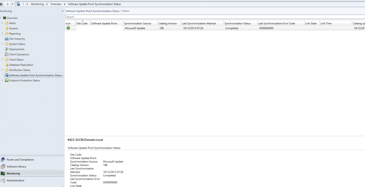

Hi Opacityzero,
I would wait for Anyweb, Rocketman, or anyone else with more experience to reply before taking my advise to heart, but I would try the following:
Remove the SUP (Software Update Point) role from SCCM (Under Servers and Site System Roles). Remove the WSUS role from the server altogether and start again. I know from my own experience and others on forums, with SCCM and WSUS, it can be a bit picky.
It's best to NEVER EVER even open the WSUS console...EVER!!! lol.
What I would do is:
Remove the SUP role.
Remove WSUS from the server it self, and then follow the guide from Anyweb to set it up again.
Once you have done that, don't open the WSUS console at all. Never even touch it. Windows Updates will be 100% managed via the SUP role on SCCM.
Once you have sorted the SUP role out and set a sync time and status, you can monitor it from here:
Also, the log files should be ruleengine.log & wsyncmg.log, which for me is located in "D:\Program Files\Microsoft Configuration Manager\Logs\"
(Obviously, change the location for your own).
I could be wrong, but this is my best answer from my own experience as I had problems initially as well.
Thanks
