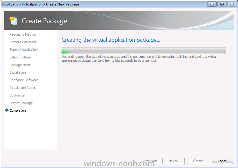

your virtual application package is created![creating the virtual application package.png](https://www.windows-noob.com/forums/uploads/monthly_11_2012/post-1-0-74562600-1352625892_thumb.png)
and your package is completed, any warnings are listed, you can double click on them for more info, once done click close
