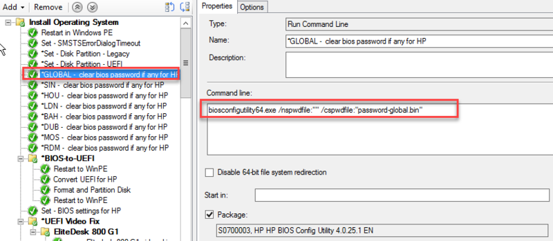

libra Posted November 19, 2018 Report post Posted November 19, 2018 On 11/19/2012 at 7:24 PM, Peter33 said: Actually i am formatting drive ? first. Then i create a new directory c:\hpbios and copy everything from the package to this directory. The run command in the task sequence holds the whole path "c:\hpbios\hp.cmd" (without cmd /c). Also, i recommend always to use a "pushd %~dp0" as first line, and "popd" as last line, in a batch file. This way your sources will be found in any case. Otherwise the instance will start in the home path of the user who is running the command (system32 as local system). I am using this method because i am also updating the BIOS and don't want to brick the machine by a failing network connection. After all si done the drive gets formatted again to have a clean starting point. Expand Dont work for me. I am using elitedesk 800 g2/3/4 My clearbios.cmd Pushd “%~dp0” biosconfigutility64.exe /nspwdfile:"" /cspwdfile:"password.bin" Popd i am very sure that the password.bin is really the password in the bios. Error msg in ts is “the operating system reported error 10. The environment is incorrect Quote Share this post Link to post Share on other sites More sharing options...
Peter33 Posted November 20, 2018 Report post Posted November 20, 2018 The error 10 is unfortunately telling a different story. According to the HP white paper this means the password is wrong. Quote Share this post Link to post Share on other sites More sharing options...
libra Posted November 20, 2018 Report post Posted November 20, 2018 On 11/19/2018 at 10:57 AM, libra said: Dont work for me. I am using elitedesk 800 g2/3/4 My clearbios.cmd Pushd “%~dp0” biosconfigutility64.exe /nspwdfile:"" /cspwdfile:"password.bin" Popd i am very sure that the password.bin is really the password in the bios. Error msg in ts is “the operating system reported error 10. The environment is incorrect Expand found out the below problem. If we have a machine bios password which is from password-global.bin and when this step is place at the first place compare to other bios password, it will successfully clear the password If we have a machine bios password which is from password-global.bin and when this step is place not at the first place compare to other bios password, it will fails to clear the password Any one manage to clear multiple bios password not matter how the it is placed in sccm task sequence? Quote Share this post Link to post Share on other sites More sharing options...
Peter33 Posted November 20, 2018 Report post Posted November 20, 2018 You could simply run all 8 steps in single batch file and add "EXIT /B 0" as your last comand line. If you want to make it shiny you can also add an evaluation step after each pw reset line to check if the returned error code is 0 and if so jump to the end of the script. Quote Share this post Link to post Share on other sites More sharing options...
libra Posted November 21, 2018 Report post Posted November 21, 2018 On 11/20/2018 at 11:13 PM, Peter33 said: You could simply run all 8 steps in single batch file and add "EXIT /B 0" as your last comand line. If you want to make it shiny you can also add an evaluation step after each pw reset line to check if the returned error code is 0 and if so jump to the end of the script. Expand yup, i have try to put all commands in a cmd file. however if the machine password is password5.bin , and the command is not put at first line, it will not remove the bios password. biosconfigutility64.exe /nspwdfile:"" /cspwdfile:"password1.bin" biosconfigutility64.exe /nspwdfile:"" /cspwdfile:"password2.bin" biosconfigutility64.exe /nspwdfile:"" /cspwdfile:"password3.bin" biosconfigutility64.exe /nspwdfile:"" /cspwdfile:"password4.bin" biosconfigutility64.exe /nspwdfile:"" /cspwdfile:"password5.bin" Quote Share this post Link to post Share on other sites More sharing options...
