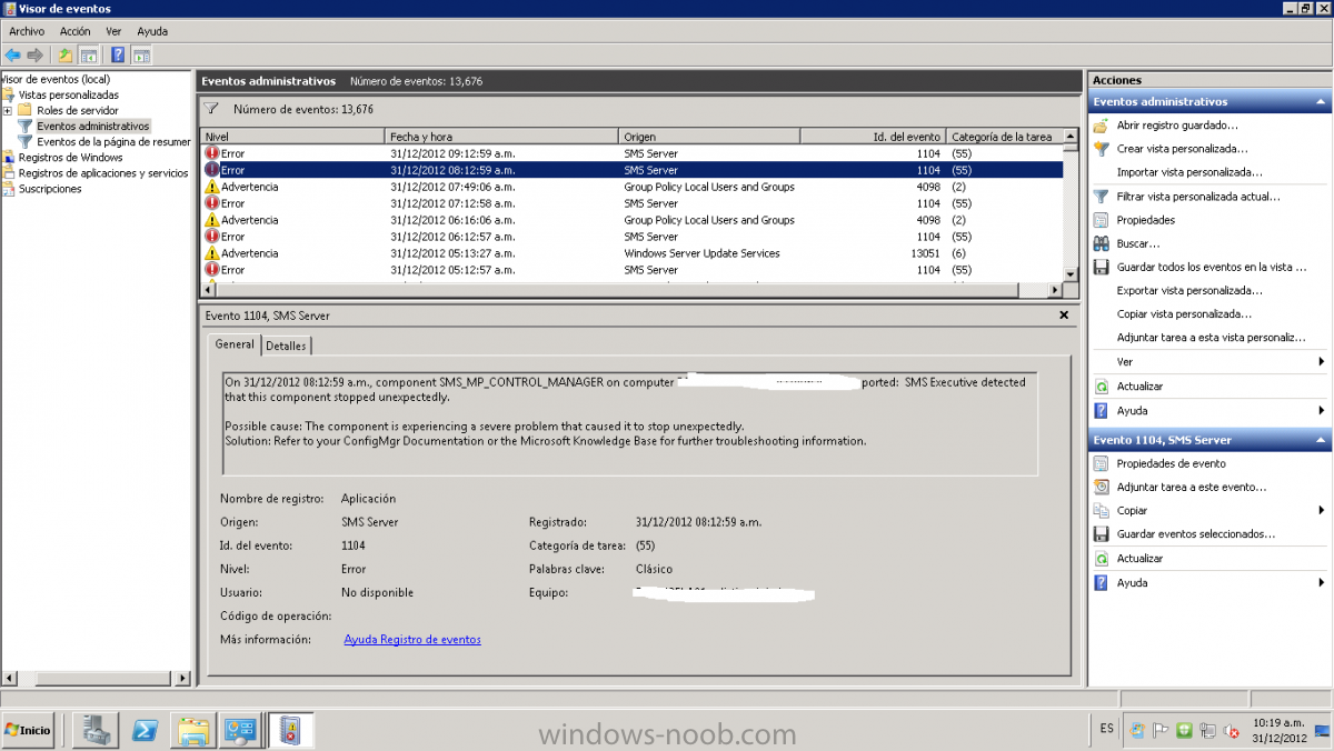

Hello friends, I have this error on a secondary site server, everything was fine, but suddenly it gives me error, and reinstalled the MP, also check the permissions and the error continues wmi
Severity Type Site code Date / Time System Component Message ID Description
Error Milestone SLV 12/29/2012 10:48:08 AM Secundarysite.mydomain.com SMS_MP_CONTROL_MANAGER 5432 MP could not write out CCM setting to WMI. Possible cause: MP didn't get installed properly. Solution: Ensure MP setup succeeded; if not, reinstall MP

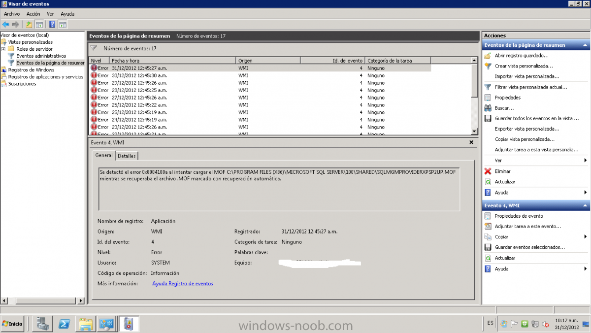

are you seeing errors in event viewer like this ?
  Quote
During the service startup, the Windows Management Instrumentation service was unable to locate the repository files. A new repository will be created based on the auto-recovery mechanism.
check if KB2506143 is installed, if so it's probably part of your problem, have you tried removing that update ? do you have configuration manager 2012 SP1 installed yet ?
