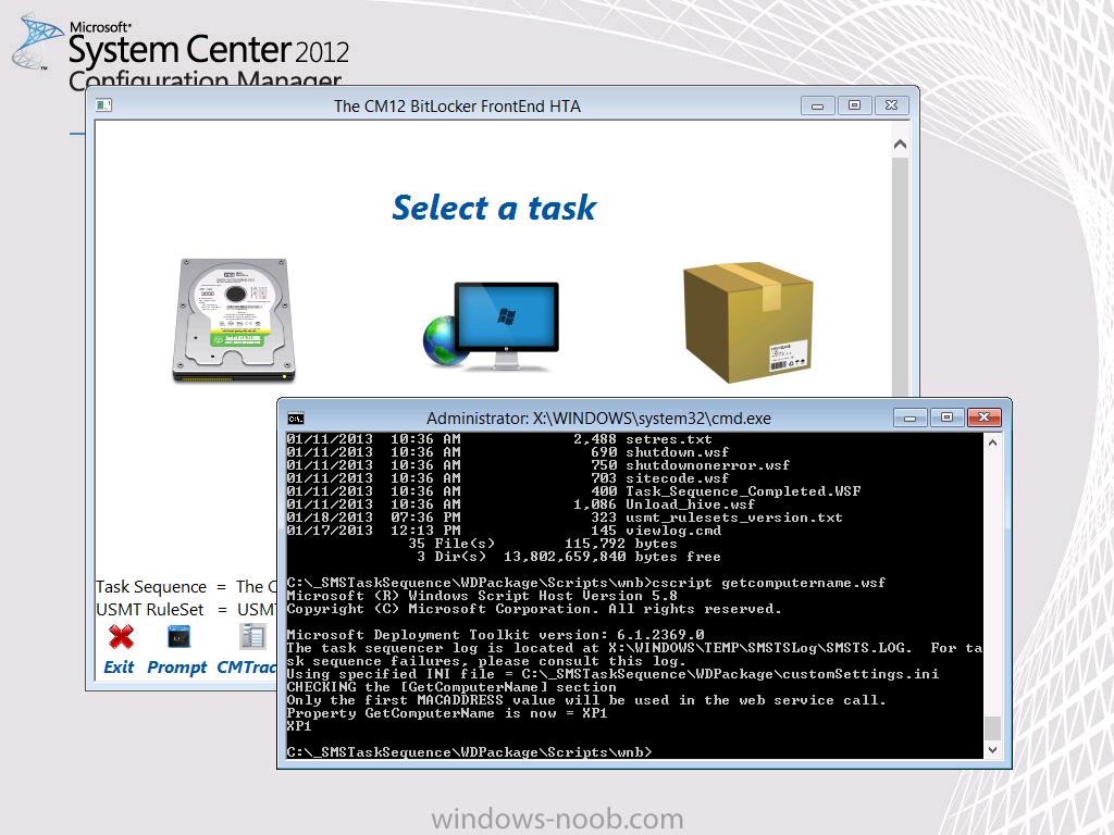

The HTA allows you to PXE boot into WinPE and use an easy interface for migrating your computers to Windows 7 or Windows 8 using Configuration Manager 2012 Service Pack 1 with MDT 2012 Update 1 integrated.
Not only does this HTA now work with Configuration Manager 2012 but it has additional functionality added such as being able to choose the BitLocker Encryption Algorithm, install the System Center 2012 Endpoint Protection client and the ability to install Multi Language options.
On the left we have Backup, in the middle it's Reinstall and to the right it's New Computer as denoted by the cool unopened box.
In the lower left corner you'll notice two new lines of information, one is the Task Sequence name (handy when you are changing versions) and the other is the current USMT ruleset version (it points to a text file which you maintain, and you can use it to keep track of your internal changes to any custom XML files contained in your USMT ruleset, the name of the file is usmt_rulesets_version.txt and a sample is included, this helps you keep track of changes you make to your migration ruleset and is useful for troubleshooting failed migrations with helpdesks using USB or Standalone media which may be out of date...).
clicking on the Info button in the lower left corner brings up even more details about the deployment, the following new items have been added to the Deployment Information window

and clicking on the CMTrace button will open the current SMSTS.log file in CMTrace so that you can monitor the deployment

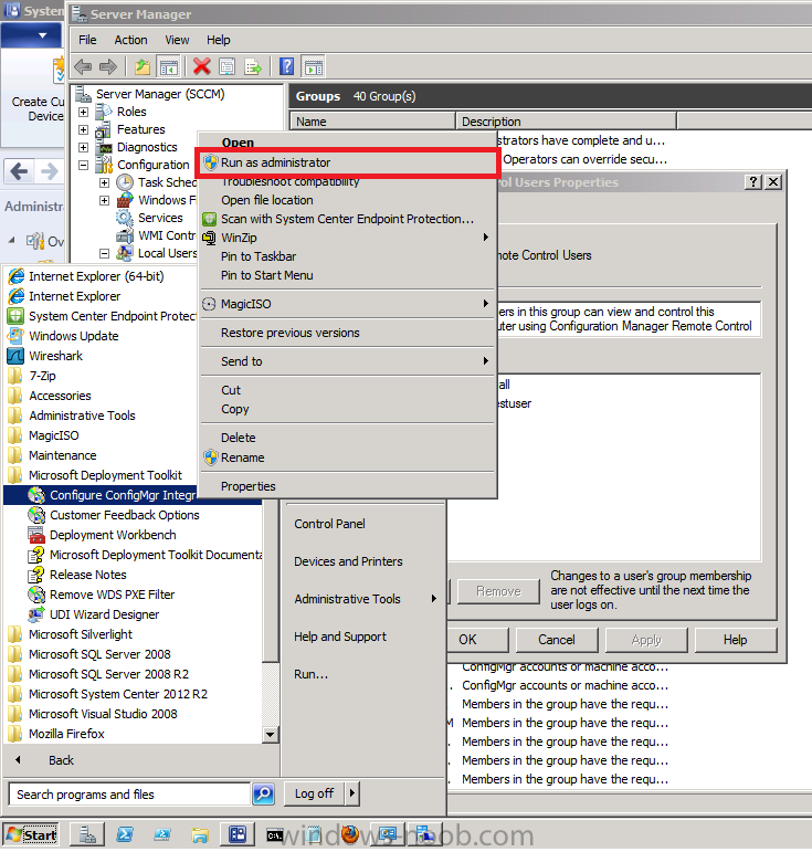

Hello,
First off, I would like to thank you for creating this excellent resource. I have been following the installation instructions and have run into a slight problem. My Microsoft Configuration Manager folder is located on the D: drive and not the C: drive, so when I go to use the imported MDT tools or your Task Sequence, I get this error:
I tried copying the files to that path, but that didn't work. Do you think this is something that can be fixed, or did I overlook something stupid? Any help you could provide would be greatly appreciated.
that looks like you have not integrated MDT properly with CM12, did you right click and choose 'Run As Administrator' when doing so ? see screenshot below
if you are using SErver 2012 then use the Start screen to do the same thing

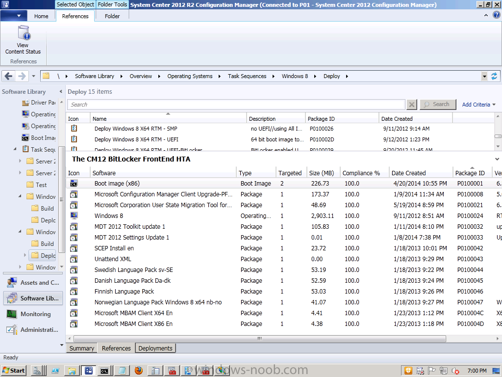

don't worry about the import errors they are normal as you don't have those packages (or you do and you just need to change the steps to point to them)
here's a list of references in my task sequence
