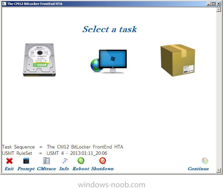

Not only does this HTA now work with Configuration Manager 2012 but it has additional functionality added such as being able to choose the BitLocker Encryption Algorithm, install the System Center 2012 Endpoint Protection client and the ability to install Multi Language options.
On the left we have Backup, in the middle it's Reinstall and to the right it's New Computer as denoted by the cool unopened box.

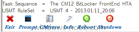

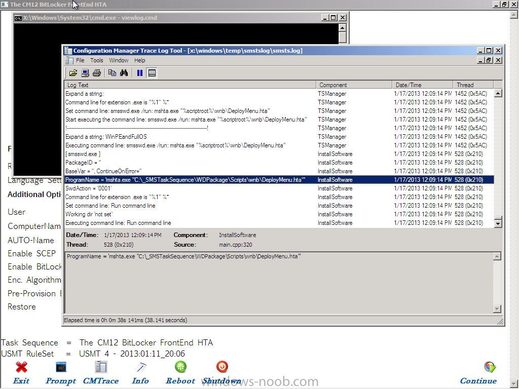

In the lower left corner you'll notice two new lines of information, one is the Task Sequence name (handy when you are changing versions) and the other is the current USMT ruleset version (it points to a text file which you maintain, and you can use it to keep track of your internal changes to any custom XML files contained in your USMT ruleset, the name of the file is usmt_rulesets_version.txt and a sample is included, this helps you keep track of changes you make to your migration ruleset and is useful for troubleshooting failed migrations with helpdesks using USB or Standalone media which may be out of date...).

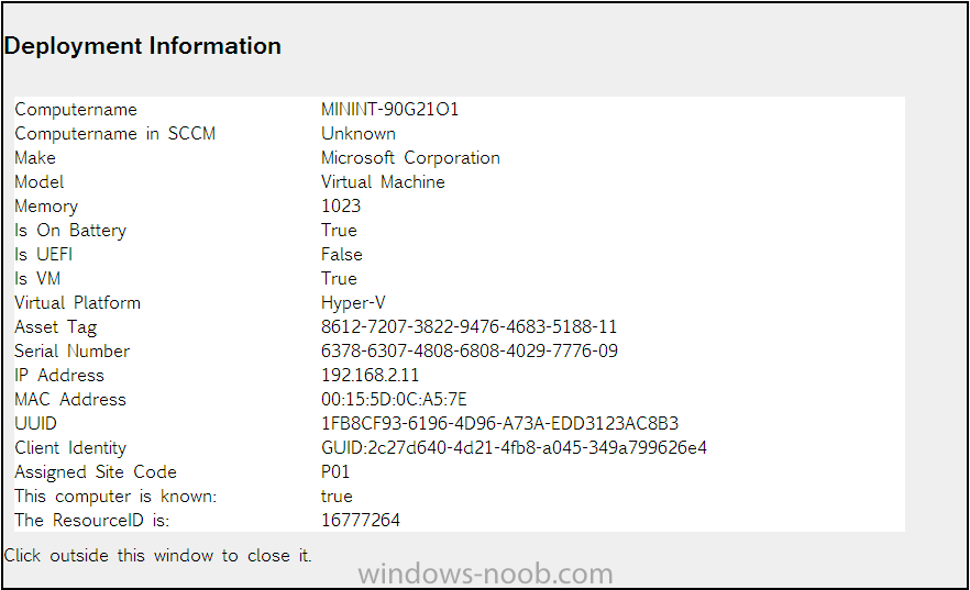

clicking on the Info button in the lower left corner brings up even more details about the deployment, the following new items have been added to the Deployment Information window
  • Make
  • Memory
  • Is on Battery
  • Is UEFI
  • Is VM
  • Virtual Platform
  • AssetTag
some of the above are new data gathered via the enhanced Gathering ability from MDT 2012 Update 1.
and clicking on the CMTrace button will open the current SMSTS.log file in CMTrace so that you can monitor the deployment

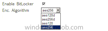

Note: The Diffuser option is no longer available to be added to the Advanced Encryption Standard (AES) encryption algorithm for Windows 8.

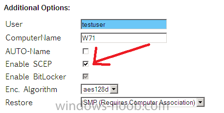

You can also select to Enable SCEP which will install the System Center 2012 Endpoint Protection client during the task sequence so that you are protected and ready to do business.

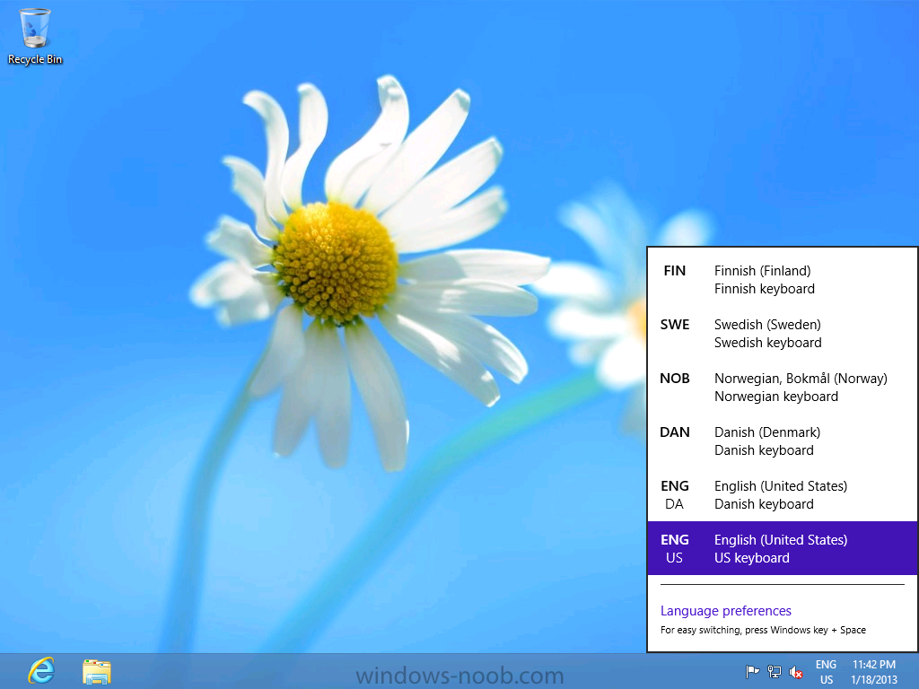

  • specify Regional settings for one or more countries
  • specify Language settings for one or more countries

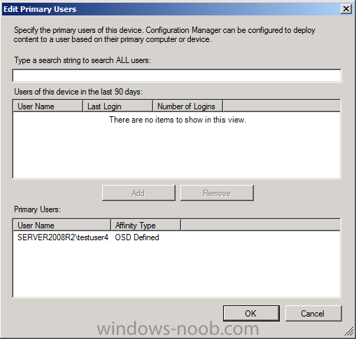

  • Enter a Username (this user get's defined as the User Device Affinity user and get's added to the Local Administrators group, if you don't want them being a local admin simply disable that group in the task sequence.)

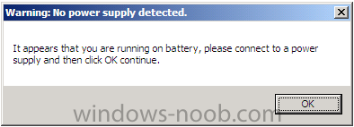

The task sequence will check if the computer is connected to power, and if not it will inform the user via a popup, this is done via the new IsOnBattery variable.

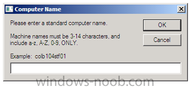

Once you launch Backup, Reinstall or New Computer, the computername is automatically checked and if it matches MININT- then you'll be prompted to change it manually.

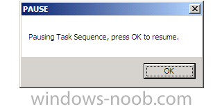

In addition there are some debug steps in the task sequence (they are disabled, simply enable them to see the functionality) to allow for things like pausing the task sequence, this is great for troubleshooting.

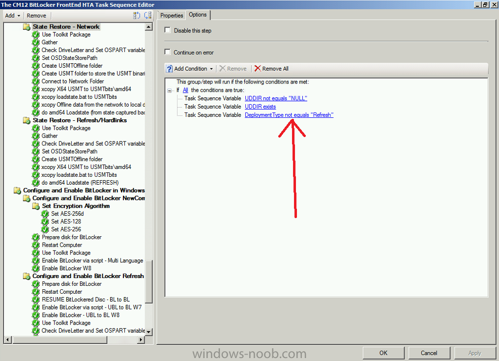

  • State Restore (Network) doesn't restore anything due to an option mis-configuration, change Deploymenttype Equals Refresh to DeploymentType Not Equals Refresh
  • State Restore (Network) doesn't restore anything due to a missing file and the file it was pointing to had a /hardlink option in, it shouldn't have !

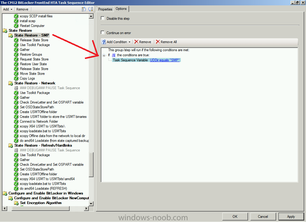

2. Change the options tab for the State Restore SMP to task sequence variable Uddir (was USMTDropdown) as per the screenshot below

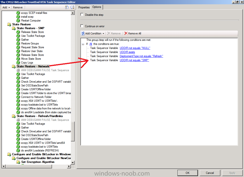

3. Change the options tab for the State Restore Network to task sequence variable UDDIR not equals SMP as per the screenshot below

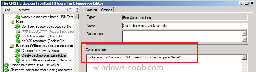

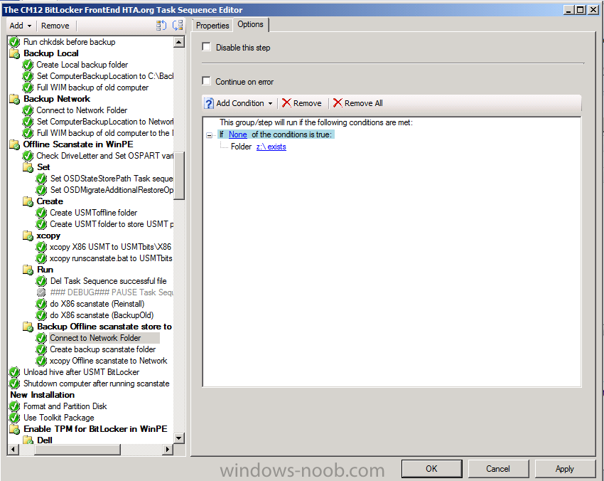

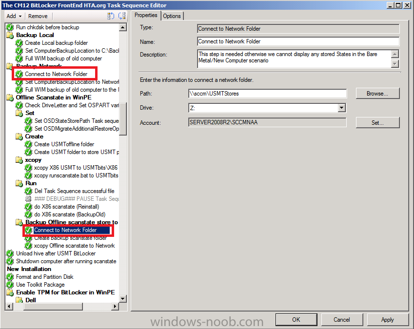

The backup to network (full wim and scanstate) need some additional changes
Add the Connect to Network step in RED in the below two places
set the options like so
and add an MD to the following line
