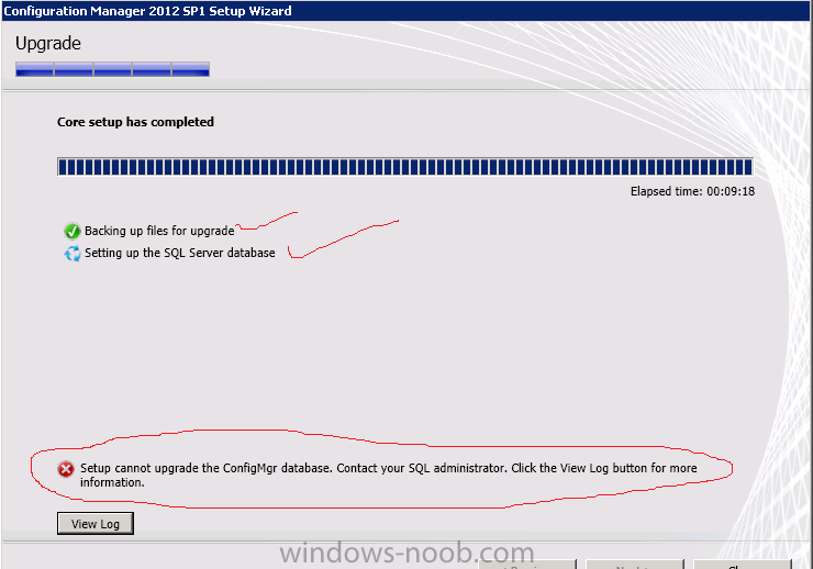

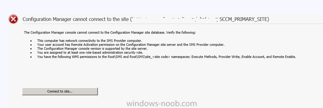

marlonc1980 Posted January 25, 2013 Report post Posted January 25, 2013 Hi all, I have passed the requirements, I have installed sql sp2 2008r, all goes well, when installing I get the following screen, is a primary site, is working well, no problems, but when I want to update this message and I can not access the previous console for obvious reasons DATOS EN LOG ERROR: SQL Server error: [42000][156][Microsoft] [sql Server]Incorrect syntax near the keyword 'to'. $$<Configuration Manager Setup><01-25-2013 14:16:37.084+300><thread=3756 (0xEAC)>INFO: Executing SQL Server command: < ~ DECLARE @viewname nvarchar(255) ~ DECLARE newviews INSENSITIVE CURSOR FOR ~ SELECT name FROM sysobjects WHERE type='V' AND name like 'v[_]%' ~ OPEN newviews ~ FETCH NEXT FROM newviews INTO @viewname ~ WHILE (@@FETCH_STATUS = 0) ~ BEGIN ~ EXEC('GRANT SELECT ON ' + @viewname + ' to smsschm_users') ~ FETCH NEXT FROM newviews INTO @viewname ~ END ~ CLOSE newviews ~ DEALLOCATE newviews ~ ~> $$<Configuration Manager Setup><01-25-2013 14:16:37.084+300><thread=3756 (0xEAC)>ERROR: Failed to execute SQL Server command: ~ DECLARE @viewname nvarchar(255) ~ DECLARE newviews INSENSITIVE CURSOR FOR ~ SELECT name FROM sysobjects WHERE type='V' AND name like 'v[_]%' ~ OPEN newviews ~ FETCH NEXT FROM newviews INTO @viewname ~ WHILE (@@FETCH_STATUS = 0) ~ BEGIN ~ EXEC('GRANT SELECT ON ' + @viewname + ' to smsschm_users') ~ FETCH NEXT FROM newviews INTO @viewname ~ END ~ CLOSE newviews ~ DEALLOCATE newviews ~ ~ $$<Configuration Manager Setup><01-25-2013 14:16:37.084+300><thread=3756 (0xEAC)>~~===================== Failed Configuration Manager 2012 Server Setup - Upgrade ===================== $$<Configuration Manager Setup><01-25-2013 14:16:37.100+300><thread=3756 (0xEAC)> Quote Share this post Link to post Share on other sites More sharing options...

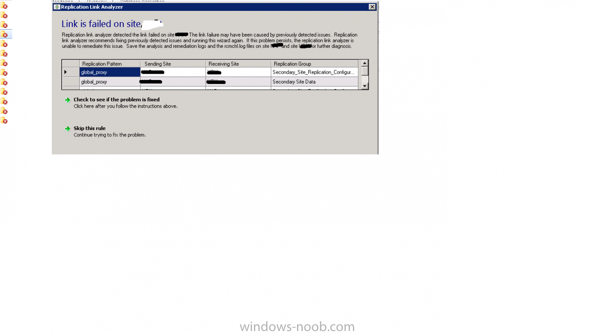

marlonc1980 Posted January 28, 2013 Report post Posted January 28, 2013 I commented that the installation be half or damaged, damaged the primary site, the SMS service and I get this screen, after that I restored to a previous state, and I can access the site fine, and I can get into the console, but I have a problem with the replication, this is not running and my database is functional, there is no problem. Log SQL: In theory the trust relationship in the domain is well __________________________________ 2013-01-2816:08:04.15 Server Microsoft SQLServer 2008 R2 (SP2) - 10.50.4000.0 (X64) Jun 28 2012 08:36:30 Copyright © MicrosoftCorporation Standard Edition (64-bit) onWindows NT 6.1 <X64> (Build 7601: Service Pack 1) (Hypervisor) 2013-01-2816:08:04.21 Server © MicrosoftCorporation. 2013-01-2816:08:04.21 Server All rightsreserved. 2013-01-2816:08:04.21 Server Server process IDis 1824. 2013-01-2816:08:04.22 Server SystemManufacturer: 'Microsoft Corporation', System Model: 'Virtual Machine'. 2013-01-2816:08:04.29 Server Authenticationmode is WINDOWS-ONLY. 2013-01-2816:08:04.29 Server Logging SQLServer messages in file 'C:\Program Files\Microsoft SQLServer\MSSQL10_50.MSSQLSERVER\MSSQL\Log\ERRORLOG'. 2013-01-2816:08:04.32 Server This instance ofSQL Server last reported using a process ID of 1824 at 1/22/2013 12:28:21 AM(local) 1/22/2013 5:28:21 AM (UTC). This is an informational message only; nouser action is required. 2013-01-2816:08:04.32 Server Registry startupparameters: -d C:\Program Files\Microsoft SQLServer\MSSQL10_50.MSSQLSERVER\MSSQL\DATA\master.mdf -e C:\Program Files\Microsoft SQLServer\MSSQL10_50.MSSQLSERVER\MSSQL\Log\ERRORLOG -l C:\Program Files\Microsoft SQLServer\MSSQL10_50.MSSQLSERVER\MSSQL\DATA\mastlog.ldf -T 8295 -T 4199 2013-01-2816:08:04.50 Server SQL Server isstarting at normal priority base (=7). This is an informational message only.No user action is required. 2013-01-2816:08:04.50 Server Detected 4 CPUs.This is an informational message; no user action is required. 2013-01-2816:08:05.37 Server Using dynamiclock allocation. Initial allocation of2500 Lock blocks and 5000 Lock Owner blocks per node. This is an informational message only. No user action is required. 2013-01-2816:08:07.35 Server Nodeconfiguration: node 0: CPU mask: 0x000000000000000f:0 Active CPU mask:0x000000000000000f:0. This message provides a description of the NUMAconfiguration for this computer. This is an informational message only. No useraction is required. 2013-01-2816:08:08.00 spid7s Starting updatabase 'master'. 2013-01-2816:08:09.66 spid7s FILESTREAM:effective level = 0, configured level = 0, file system access share name ='MSSQLSERVER'. 2013-01-2816:08:10.22 spid7s SQL Trace ID 1was started by login "sa". 2013-01-2816:08:10.30 spid7s Starting updatabase 'mssqlsystemresource'. 2013-01-2816:08:10.41 spid7s The resourcedatabase build version is 10.50.4000. This is an informational message only. Nouser action is required. 2013-01-2816:08:10.97 spid10s Starting updatabase 'model'. 2013-01-2816:08:10.98 spid7s Server name is'server'. This is an informational message only. No user action is required. 2013-01-2816:08:11.35 spid10s Clearing tempdbdatabase. 2013-01-2816:08:11.78 Server The certificate[Cert Hash(sha1) "1A2E6CFFFA87BBCE772C3B85658CE296B60018AA"] wassuccessfully loaded for encryption. 2013-01-2816:08:11.84 Server Server islistening on [ 'any' <ipv6> 1433]. 2013-01-2816:08:11.85 Server Server islistening on [ 'any' <ipv4> 1433]. 2013-01-2816:08:11.85 Server Server localconnection provider is ready to accept connection on [\\.\pipe\SQLLocal\MSSQLSERVER ]. 2013-01-2816:08:11.85 Server Server named pipeprovider is ready to accept connection on [ \\.\pipe\sql\query ]. 2013-01-2816:08:11.87 Server Server islistening on [ ::1 <ipv6> 1434]. 2013-01-2816:08:11.87 Server Server islistening on [ 127.0.0.1 <ipv4> 1434]. 2013-01-2816:08:11.87 Server Dedicated adminconnection support was established for listening locally on port 1434. 2013-01-2816:08:11.92 Server The SQL ServerNetwork Interface library could not register the Service Principal Name (SPN)for the SQL Server service. Error: 0x2098, state: 15. Failure to register anSPN may cause integrated authentication to fall back to NTLM instead ofKerberos. This is an informational message. Further action is only required ifKerberos authentication is required by authentication policies. 2013-01-2816:08:11.92 Server SQL Server is nowready for client connections. This is an informational message; no user actionis required. 2013-01-2816:08:12.40 spid10s Starting updatabase 'tempdb'. 2013-01-2816:08:12.99 spid13s Server islistening on [ 'any' <ipv6> 4022]. 2013-01-2816:08:12.99 spid13s Server islistening on [ 'any' <ipv4> 4022]. 2013-01-2816:08:13.07 spid13s The ServiceBroker protocol transport is now listening for connections. 2013-01-2816:08:13.09 spid13s The DatabaseMirroring protocol transport is disabled or not configured. 2013-01-2816:08:13.42 spid13s Service Brokermanager has started. 2013-01-2816:08:24.90 Logon Error: 18456,Severity: 14, State: 38. 2013-01-2816:08:24.90 Logon Login failed foruser MY DOMAIN\SQL_Admin'. Reason: Failed to open the explicitly specifieddatabase. [CLIENT: <local machine>] 2013-01-2816:08:27.25 Logon Error: 18456,Severity: 14, State: 38. 2013-01-2816:08:27.25 Logon Login failed foruser MY DOMAIN\SQL_Admin'. Reason: Failed to open the explicitly specifieddatabase. [CLIENT: <local machine>] 2013-01-2816:08:32.86 Logon Error: 18456,Severity: 14, State: 38. 2013-01-2816:08:32.86 Logon Login failed foruser MY DOMAIN\SQL_Admin'. Reason: Failed to open the explicitly specifieddatabase. [CLIENT: <local machine>] 2013-01-2816:08:35.46 spid14s A new instance ofthe full-text filter daemon host process has been successfully started. 2013-01-2816:08:35.95 spid14s Starting updatabase 'msdb'. 2013-01-2816:08:35.95 spid17s Starting updatabase 'ReportServer'. 2013-01-2816:08:35.96 spid18s Starting up database'ReportServerTempDB'. 2013-01-2816:08:35.96 spid19s Starting updatabase DataBase. 2013-01-2816:08:35.96 spid20s Starting updatabase 'TmpRep'. 2013-01-2816:08:38.87 spid19s 64 transactionsrolled forward in database DataBase (7). This is an informational message only.No user action is required. 2013-01-2816:08:39.68 spid19s 0 transactionsrolled back in database DataBase (7). This is an informational message only. Nouser action is required. 2013-01-2816:08:39.68 spid19s Recovery iswriting a checkpoint in database DataBase (7). This is an informational messageonly. No user action is required. 2013-01-2816:08:39.78 spid52 Attempting toload library 'xpsqlbot.dll' into memory. This is an informational message only.No user action is required. 2013-01-2816:08:39.89 spid52 Using'xpsqlbot.dll' version '2009.100.1600' to execute extended stored procedure'xp_qv'. This is an informational message only; no user action is required. 2013-01-2816:08:41.12 spid52 Attempting toload library 'xpstar.dll' into memory. This is an informational message only.No user action is required. 2013-01-2816:08:41.16 spid19s Recoverycompleted for database database (database ID 7) in 2 second(s) (analysis 79 ms,redo 112 ms, undo 714 ms.) This is an informational message only. No useraction is required. 2013-01-2816:08:41.39 spid7s Recovery iscomplete. This is an informational message only. No user action is required. 2013-01-2816:08:41.42 spid52 Using'xpstar.dll' version '2009.100.1600' to execute extended stored procedure'xp_instance_regread'. This is an informational message only; no user action isrequired. 2013-01-2816:08:42.05 spid52 Attempting toload library 'xplog70.dll' into memory. This is an informational message only.No user action is required. 2013-01-2816:08:42.15 spid52 Using'xplog70.dll' version '2009.100.1600' to execute extended stored procedure'xp_msver'. This is an informational message only; no user action is required. 2013-01-2816:09:24.59 spid89 Common languageruntime (CLR) functionality initialized using CLR version v2.0.50727 fromC:\Windows\Microsoft.NET\Framework64\v2.0.50727\. 2013-01-2816:09:26.81 spid89 AppDomain 2(CM_NAP.dbo[runtime].1) created. 2013-01-2816:09:35.28 Logon Error: 17806,Severity: 20, State: 14. 2013-01-2816:09:35.28 Logon SSPI handshakefailed with error code 0x8009030c, state 14 while establishing a connectionwith integrated security; the connection has been closed. Reason:AcceptSecurityContext failed. The Windows error code indicates the cause offailure. [CLIENT: SecundarySite]. 2013-01-28 16:09:35.29 Logon Error: 18452, Severity: 14, State: 1. 2013-01-2816:09:35.29 Logon Login failed. Thelogin is from an untrusted domain and cannot be used with Windowsauthentication. [CLIENT: SecundarySite] Quote Share this post Link to post Share on other sites More sharing options...

marlonc1980 Posted January 29, 2013 Report post Posted January 29, 2013 Hello, I want to restore the database; sccm console and replication is failing for all this detailed above, but to restore tells me that is not in exclusive use, I want to know the process to restore, I think that may be why replication failure. by poor installation of SP1 Quote Share this post Link to post Share on other sites More sharing options...
