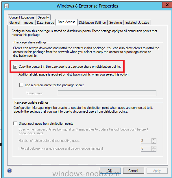

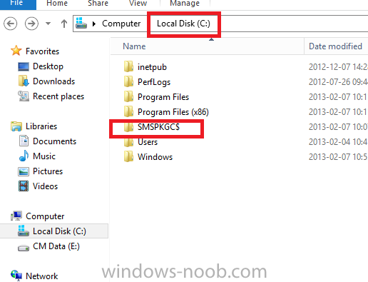

Oneone Posted February 8, 2013 Report post Posted February 8, 2013 Hi folk! One thing i have noticed when im running CM SP1 on Server 2012 (dont know if this applies to 2008 to havent tried). Anyway, when i use the checkbox "copy the content...(se picture) on a package or OS img the package share is created on my C:\ drive... I would like to change this to my data disk instead because i dont want to fill upp my system drive with a bunch of packages. Has anyone seen or experienced this problem and i havent really figured out how to change the default. The reason that im copying them again is that i want to run the OS deployment form the DP for faster deployment. Se picture 3 Quote Share this post Link to post Share on other sites More sharing options...
Iroqouiz Posted February 8, 2013 Report post Posted February 8, 2013 Place a file on all drives where you don't wish packages to be stored, called NO_SMS_ON_DRIVE.SMS It could be an empty txt file, just make sure it's named exactly like I wrote. The file extension must be .SMS This should really be done before installing SCCM, but if you place the file there now you should be good to go. Quote Share this post Link to post Share on other sites More sharing options...
Oneone Posted February 8, 2013 Report post Posted February 8, 2013 Ahhhhh right i havent actually even thought about that! nice will try that ! ill post back later with results. Thx Iroqouiz it worked like a charm it´s always the small things u miss thats so easy Quote Share this post Link to post Share on other sites More sharing options...
