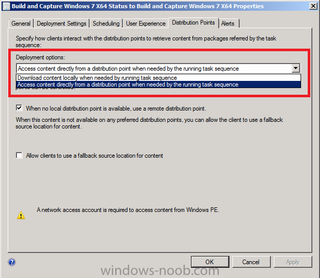

WAZZIE Posted February 14, 2013 Report post Posted February 14, 2013 Hi all, Hope your all well, and cracking on with your sccm 2012 sp1 environments. Everything is cool in my sccm 2012 environment, however my task sequences for xp, 7 osd seem to want to always download the images, and each software package locally before running. This is making my task sequence take longer than is nessesary. I have set the "content to be avalable from the dp share" on each package and the osd images, and retried a few times now, however every piece of the task sequence downloads to the client, then executes. The bigger the package or image, the longer it takes. What am i missing here dudes !!! Look forward to being hit round the head with a wet fish for my noob question ! Thanks and regards, WAZZIE Quote Share this post Link to post Share on other sites More sharing options...
anyweb Posted February 14, 2013 Report post Posted February 14, 2013 check your task sequence deployment, and the distribution point options what is it set to (download or access) ? Quote Share this post Link to post Share on other sites More sharing options...

Oneone Posted February 14, 2013 Report post Posted February 14, 2013 You need to do this for every package in the Task Sequance, se here http://www.windows-noob.com/forums/index.php?/topic/7445-sccm-sp1-how-do-i-prevent-packages-on-c/ Quote Share this post Link to post Share on other sites More sharing options...
WAZZIE Posted February 14, 2013 Report post Posted February 14, 2013 Hi All, My task sequence deployment doesnt have the option "Access directly..." only download content locally from dist point.... I will recreate my deployment for the TS and see if i can get the option to show up. weird - or have i messed up somewhere thanks anyweb / oneone - i will have a tinker and keep you posted Quote Share this post Link to post Share on other sites More sharing options...

anyweb Posted February 14, 2013 Report post Posted February 14, 2013 and the most likely candidate for the package is the configmgr client upgrade package, simply create another one (package from definition) and all will be good Quote Share this post Link to post Share on other sites More sharing options...

WAZZIE Posted March 3, 2013 Report post Posted March 3, 2013 OK - yep - got this going with out the download of each component of the task sequence. It was the client package, had to recreate this, also specified all packages in TS are created in a share on the DP. Now it runs over the network, and is faster than pulling each part down and then running it. Thanks to you - ANYWEB / RocketMan / Oneone - this is fantastic help and fantastic news !! I will keep playing, next I am going for the service pack of my lab to SP1 Once again - Thanks. Quote Share this post Link to post Share on other sites More sharing options...
