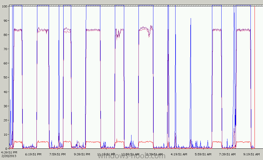

The attached file shows cpu usage overnight last night. I don't see a clear pattern to the times the CPU usage is spiking up, it looks like it happens maybe every 90 minutes to 2 hours in this graph, but not at an exact interval. And overnight, from approxiamtely 2:30am-6:30am it only spiked up for brief moments, instead of running at full throttle for an hour or so as it seems to have done otherwise.
Blue = Process % User Time
Red = Process % Privilaged Time
Lt Purple= Processor % User Time
Dk Purple = Processor % Processor Time
