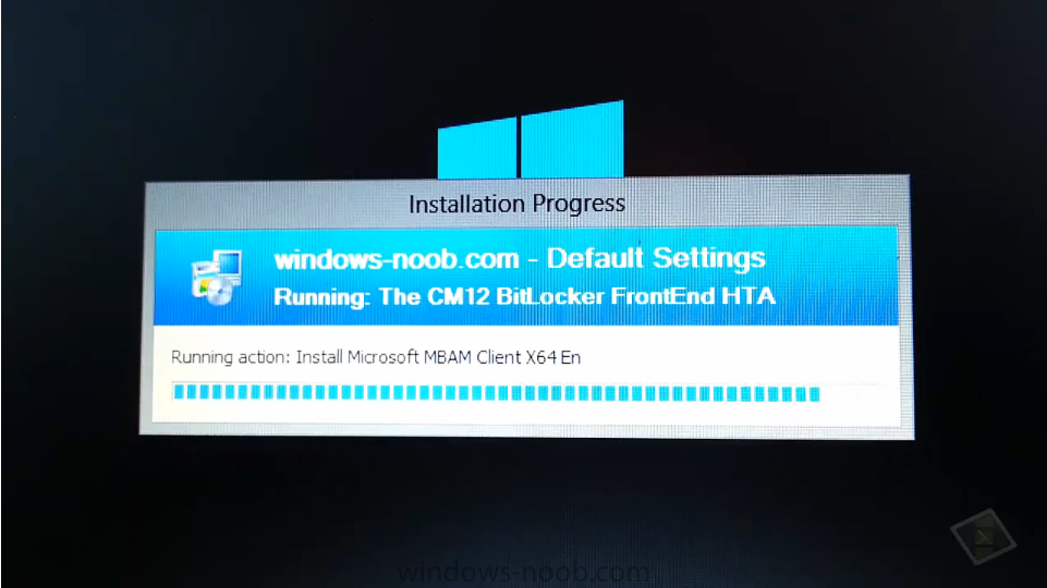

The CM12 BitLocker FrontEnd HTA - video
here's a live demo I did in Seattle during the 2013 Global MVP summit, I demo'd the CM12 BitLocker FrontEnd HTA to a few other Configuration Manager MVP's and Rob Marshall decided to video it ! so here's the result, the lighting quality is a bit low (video'd with a mobile phone.), apologies for that and we were both tired after a long day attending sessions, however it was an on-the-spur-of-the-moment thing and we wanted to share the experience
In this demo I did a refresh from Windows 8 BitLockered to Windows 8 BitLockered using an MBAM 2.0 backend and of course using Configuration Manager 2012 Service Pack 1
cheers !
niall
